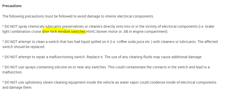

I ask because if you know how to cause it, we can remove one fuse at a time that powers the multiplex network to see if there is one that stops it from happening. I suggest that so we know if there is a short in one of the circuits.
Let me know. Also, when you removed and replaced the door lock actuators, did you use any type of cleaner, lubricant, or anything that could have provided overspray in that specific area? See the list below.

Thank you for your reply. I did not use any cleaners, lubricants or sprays on or around the actuators or doors. The moonroof and windows open at the same time. It is a feature that can be used to cool a hot car before getting in by holding the unlock button on the FOB down for 3 seconds. Newer models can close windows and moonroof by holding down the lock button but mine does not. I had the dealer disable this function specifically but the next day it happened again. I don’t think the FOB will allow me to do this so we can find the fuse. I think it can be done by using the physical key and turning it twice to unlock and holding it. I can look up the steps if necessary.
