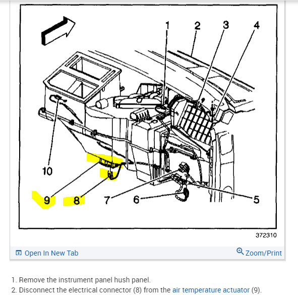

All my vents blow very hot air at all times. This problem is occurring at all times with climate control set on any and every combination. This includes the setting of temperature dial set to max cold, A/C button off, blower dial to off, vent selection dial to defrost or dash or floor or defrost/dash or dash/floor combination settings, with air intake setting on recirculation or outside air intake. It was suggested to me that hot air from the engine compartment is entering the vent system at all times. It isn't radiating heat. It is actually blowing.

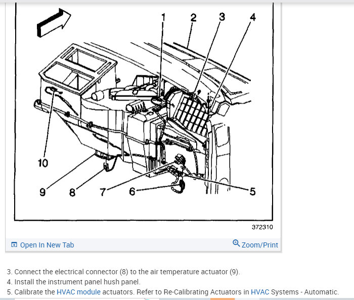

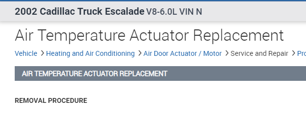

What it sounds like is there is an issue with the blend air door (air mix door). If you only get heat, the actuator air mix door is what changes the air temperature entering the vehicle.
When you get in the vehicle, have you ever noticed any clicking from under the dash? When you change the temperature, do you ever hear a door opening or closing under the dash?
Let me know. Also, I attached a pic below showing the air temperature actuator. I need to know if you have automatic climate control or manual so I can get you the right directions.

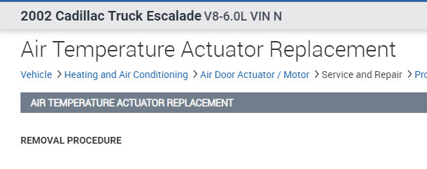

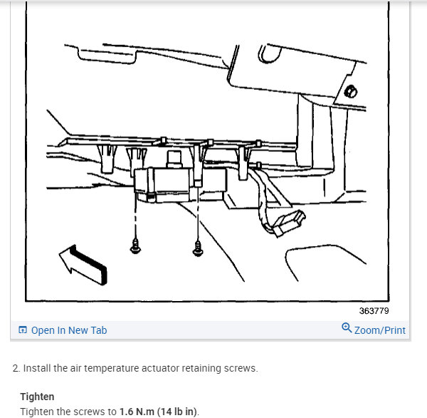

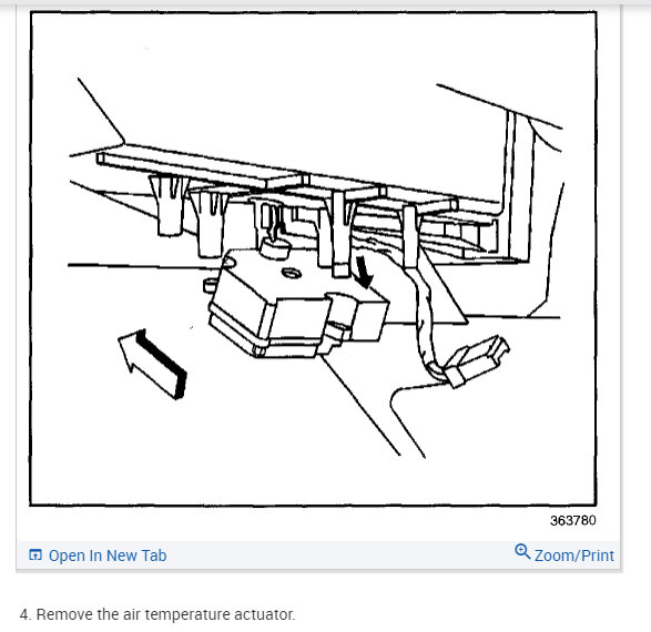

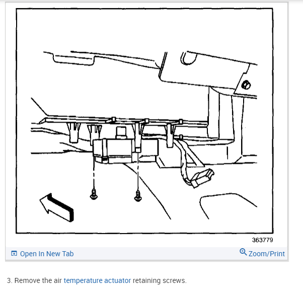

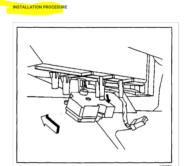

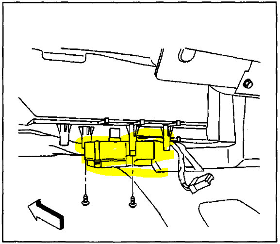

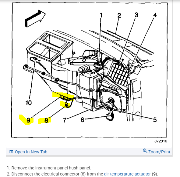

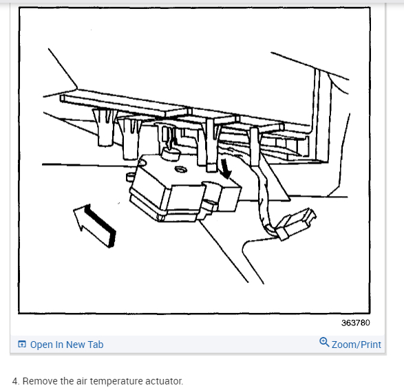

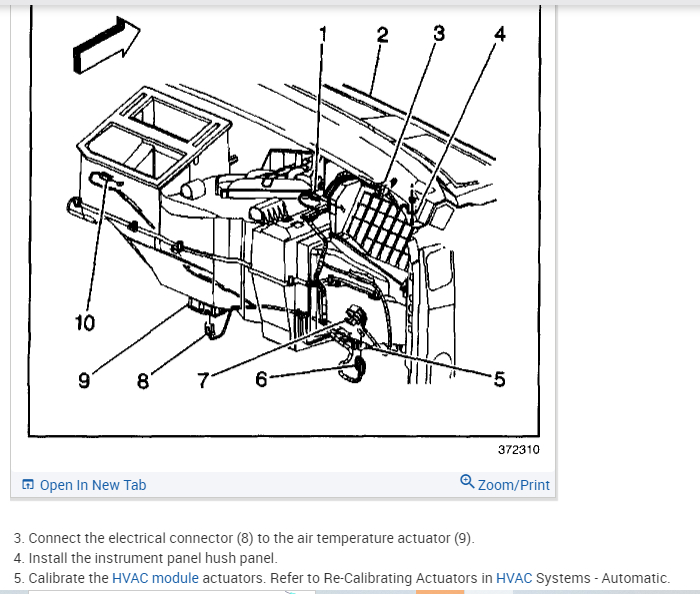

I suspect you have manual climate control and not the dual climate. Since we only get hot air, it is likely related to the blend door as I mentioned above.
I suspect the actuator motor is failing. You can place your hand on the actuator to see if you feel movement or remove it and see if responds when you request cool air.
I attached the directions for replacing it below. It indicates removing the hush panel. The panel is the one under the dash that covers wires and components under the dash and helps quiet noise.
Take a look through the directions and let me know if you have questions.

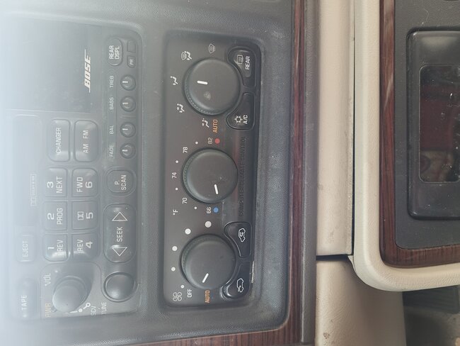

I took the pic of my climate control panel and forgot to attach it. I'm including it. I see where the actuator is. Thank you. I'll check it today. I have a shop manual and am doing a word search for "actuator? it has diagrams for 4 more actuators. I'm hoping none of them ever fail! It appears the dash must be removed to install new ones.
On rock auto there are several actuators available. When I'm ready and can't figure out which one is correct, I'll message you if that's okay?
Thanks for the help! I'll send a donation. I hope it will be adequate.
