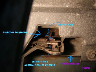

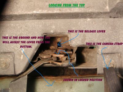

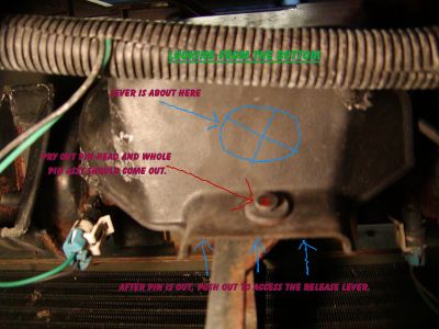

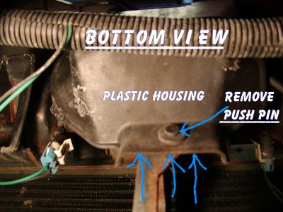

I hate to bug you guys about this since it is so petty and I feel so stupid asking but someone broke the hood release handle in the car (previous owner) and I am stumped on how to get the hood opened with out taking a cutting torch to it. I checked the cable inside the car to see if I could pull it to release the hood but I guess the old owner already pulled that through. so this leaves me between a rock and a hard spot seeing as though I have to change intake manifold gaskets this weekend ggrr! if there is any thing I can do to get the hood open, possibly unbolting the hood latch or if you guys know a trick to release it I will stop taking up your valuable time that im sure someone else is in need of. I appreciate any advice I can get, oh yea you guys are life savers.

There was a 95 in the shop when I left today, if it's still there I'll see if I can't help answer that tomorrow.
Feb 6, 2007 at 11:00 AM
SERVICE WRITER
  • 9,123 POSTS
Ok, here be what I found:
https://images.2carpros.com/forum/automotive_pictures/30961_top1_1.jpg
https://images.2carpros.com/forum/automotive_pictures/30961_top2_1.jpg
https://images.2carpros.com/forum/automotive_pictures/30961_bottom_view_1.jpg
https://images.2carpros.com/forum/automotive_pictures/30961_boton_1.jpg
