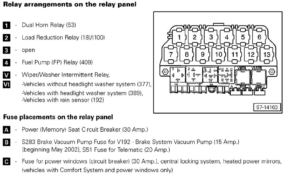

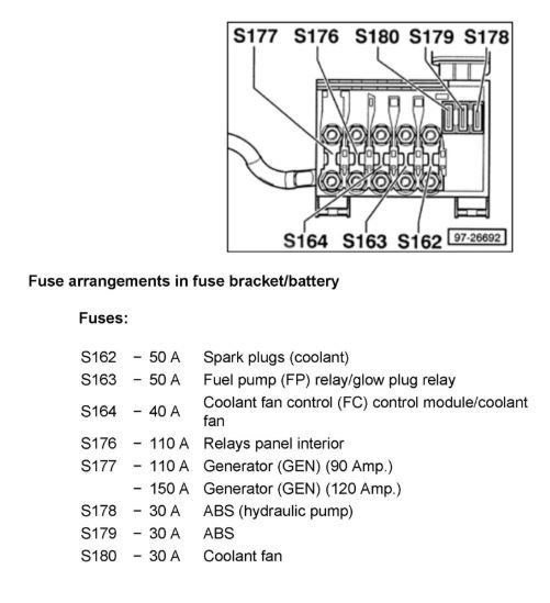

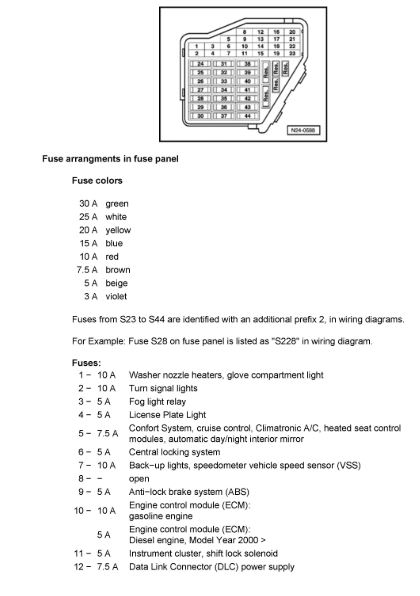

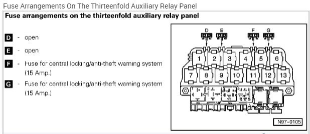

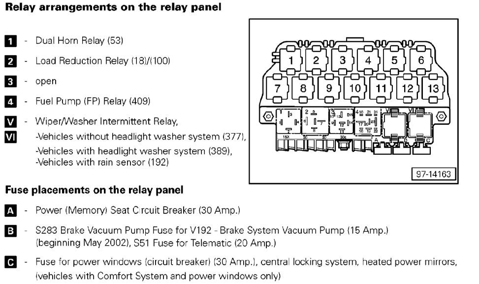

I bought this car and the remote is working but the alarm and central locking not working at all. i checked the fuses and everything is okay.
Jul 14, 2020 at 6:23 AM
4DRTOM
  • 467 POSTS
Good morning,
When you say the remote is working but the alarm and locks aren't. What about the remote is working then? A lot of VW's the body module that controls the locks are under the drivers seat under the carpet. They tend to get wet under there causing issues with the wiring harness and the module itself. Check for wetness under there and any corrosion of the wires and harness.
Jul 14, 2020 at 7:01 AM

What was happening the park light was staying on. the previous owner said they pulled out the fuse so I want to know what number fuse should I look at.

4DRTOM
  • 467 POSTS
Hi Lesley,
Sorry for the delay, I got pulled away for the day. Give me a minute and I will dig up the fuse panel legend and post it. If you find wetness then get all the way to the metal under the car make sure there's not a puddle. I've seen those get quite a lot of sitting water under some VW's drivers seats where the module lives. If that's what you find then look for a rubber plug in the floor and remove it, it's a drain plug for this issue, pull the other side plug as well to see if anything drains as well. There are plugs under every seat in the Passat's I know. I'm not sure about the other models.
Drying out a fully soaked carpet pad take a bit of time to dry. First thing is to get it to drain then a towel or paper towels will get most of the real wetness and some in the carpet but that will need a heat lamp if you have one. Then the old fashioned style which it to park it in the sun with the windows slightly open, just a crack to let what evaporates escape the car. I you in fact do have moisture in there you will be seeing fog in the windows when it is parked in the heat of the sun. Let us know what you find. Most of the time I've seen this issue the wiring harness leading to the module actually rots away and mod itself survives but with repairable because the plug terminals are what corrodes and breaks off. Lets verify its wet first, then if we need to get into the harness or the module we pick it up from there. I've had good luck with used BCM's for them.
Let us know,
Tom
Jul 14, 2020 at 10:58 PM
4DRTOM
  • 467 POSTS
Here is your fuse legends in the different locations.
Tom
Jul 14, 2020 at 11:48 PM

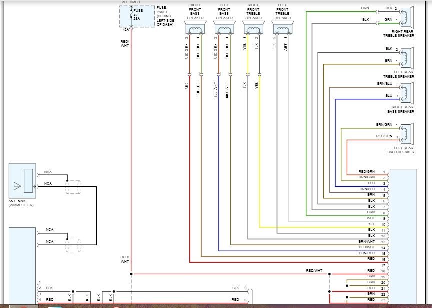

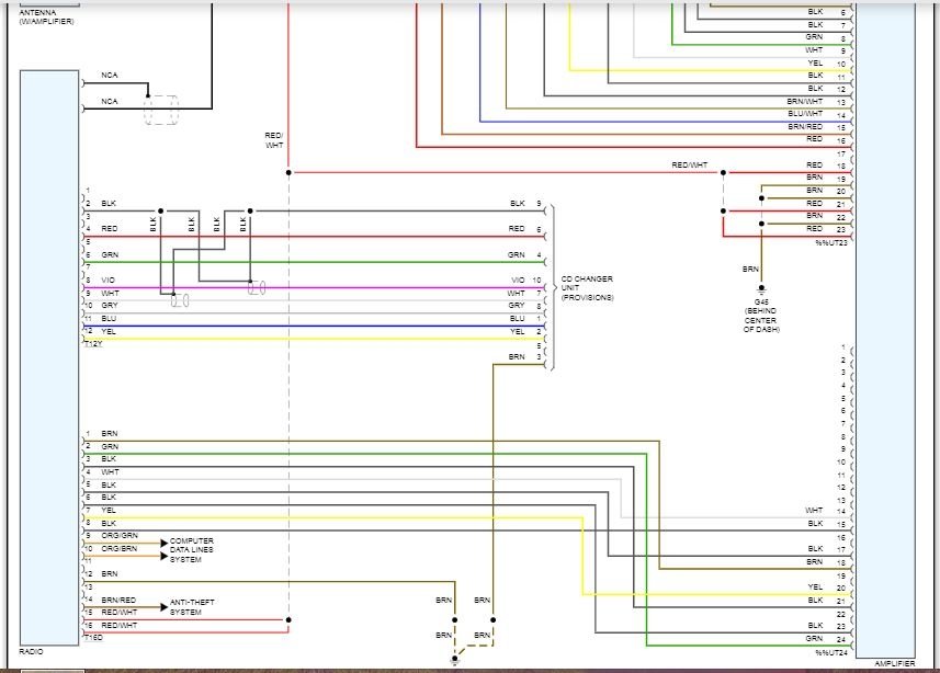

What color wire is for ignition when I connect my radio?
Jul 21, 2020 at 9:58 AM
4DRTOM
  • 467 POSTS
Here are the schematics for the radio, look like it's a red wire. I couldn't get the diagram on one page so the two images attach horizontally.
Let me know if this helps.
Tom
Jul 23, 2020 at 9:41 PM
4DRTOM
  • 467 POSTS
It does not seem that my upload actually uploaded. here they are.
Sorry about that I'm not sure what happened.
Tom
