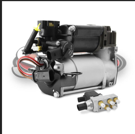

This would explain the different noise the pump is making. What I would do is replace the pump and valve block and retest this.
It appears you can get a pump assembly and valve block for a reasonable price.

I replaced the compressor. I raised the car manually a couple times and it worked just like it should have no issues. I took the car for a very short trip then I went for a longer one. I went on the highway under heavy acceleration and drove at 45 to 65 MPH. So, the car can adjust in the fly. There are no codes pending or current. After looking at the old compressor it appears it is starting to fail and there is a small leak in the relief valve, air hose that goes into the compressor. It appears to be fixedish. I snapped two out of three bracket bolts. Have to buy a new mounting kit. Thank God for extra strong industrial zip ties.

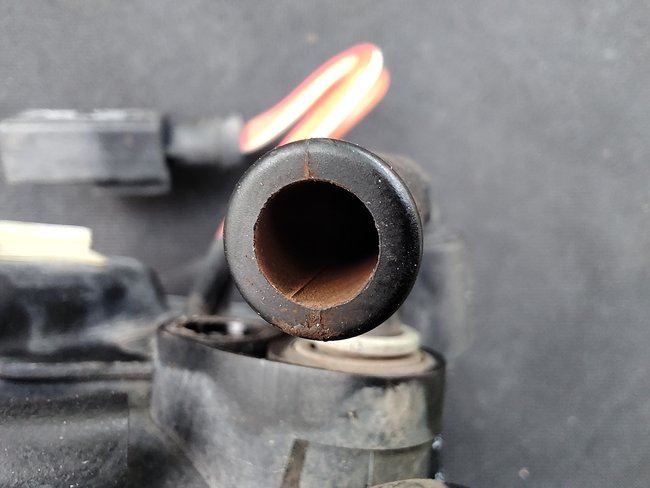

I've always figured things out when I talk it out or bounce it off someone. I'm going to take apart the old compressor. I just remembered I drove for 3 months in winter with a broken intake hose after filter. I have a feeling dirt got sucked up and wore down internals causing it to leak and not produce enough bars. I live in NJ, there is always a ton of salt on the roads.
Jun 10, 2022 at 4:30 AM
Well, I am glad you are coming to us to bounce things off.
That makes perfect sense. Let us know what you find and post pictures if you find something interesting.
Good work.
Jun 10, 2022 at 4:57 AM
GENESIS88
  • 140 POSTS
Definitely sucked up water and debris. The piston and seals are probably torn and pitted.

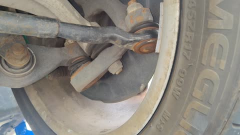

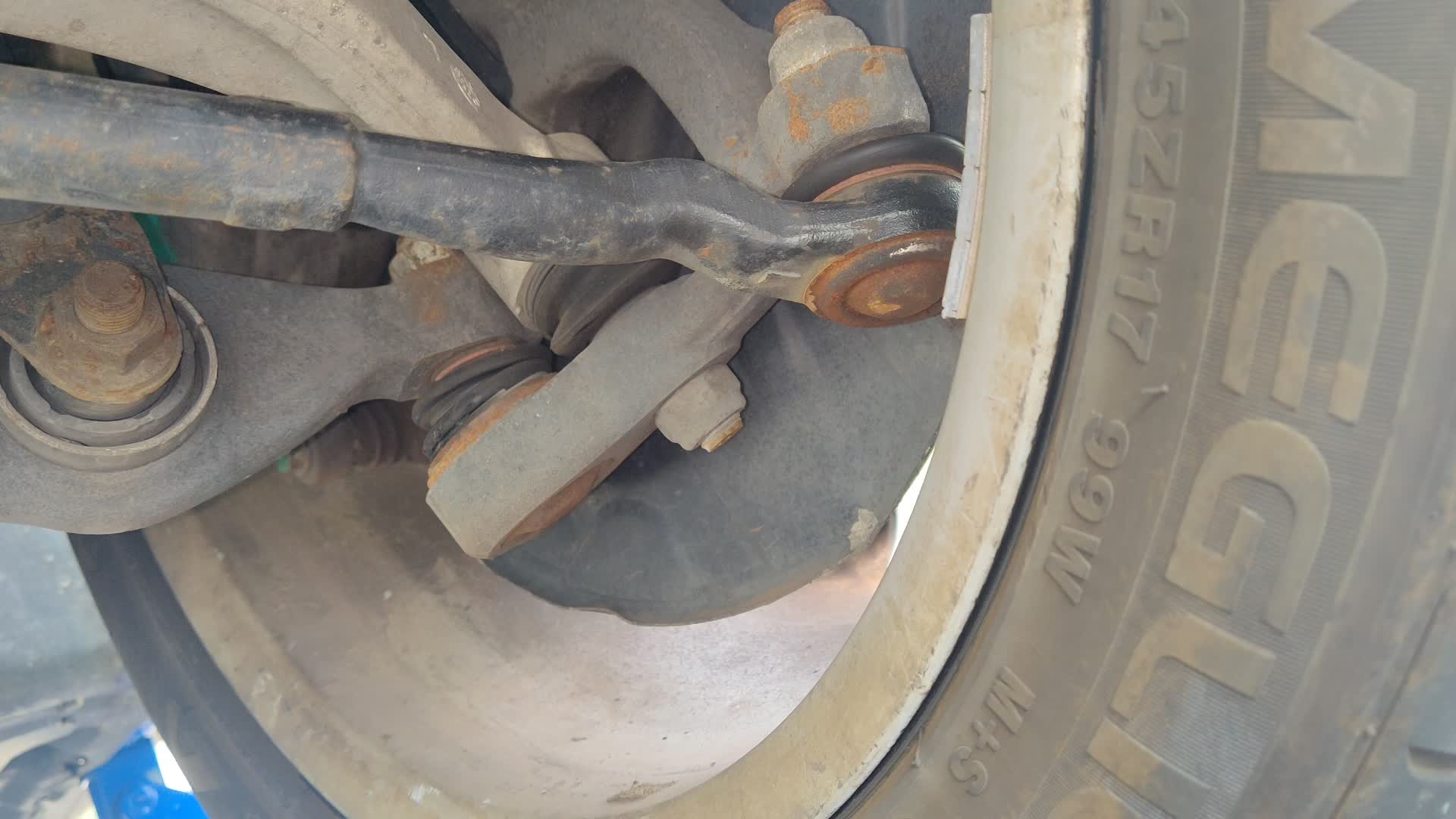

There is something else you can help me out with. When I drive there is rumble, skipping, grinding feeling you can feel in feet. You can also slightly feel the car drag and the other issues when letting off gas. I almost got into a car accident, and I had jam breaks and came to a complete stop. After that it stopped. I know it's possible it can be a bad caliber, wheel bearing, u joint, drive shaft flex, plate ECT. But I feel it's unlikely to be anything to do with drive shaft joints, differential or transmission. When it happened, I popped in neutral, and it still happened. So that almost rules that stuff out. When car is jacked up there is a small amount of play. When you spin tire, it is little rough and does make a small grind noise. That can mean something to do with brakes or wheel bearing. I have no clue what to do first as I don't want to drop money on random parts. What do you think I should check and do first?
Jun 10, 2022 at 10:44 AM
GENESIS88
  • 140 POSTS
I jacked the driver side up and really gave it a shake and spun the wheel. I think it's a wheel bearing, can you confirm?
Jun 10, 2022 at 11:23 PM
We should get a new post started for this issue because it is not exactly related to this and that is good info with that video. However, yes, if you are able to wiggle it in different directions and it moves but the ball joint and tie rod appear tight then that is a bearing.
If we can get a new one started with that video, we can send you the instructions for a wheel bearing.
Great job with that video!
Jun 11, 2022 at 3:19 AM
GENESIS88
  • 140 POSTS
I already did the wheel bearing. I forgot how messy packing bearings by hand is. It's a warped rotor. When you spin by hand it spins free then all of a sudden it stops and is rough to turn for a 1/4 turn. You can hear the pads and rotors dragging then it stops. I will start a new three under wheel bearing or wrapped rotor tonight.
