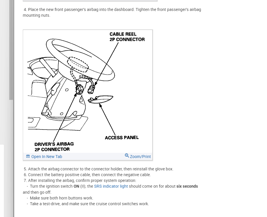

How do you disable the driver and passenger side airbags?
1997 HONDA CRV
200,000 MILES • 2.0L • 4 CYL • 4WD • AUTOMATIC
INDY207

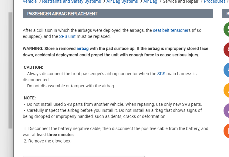

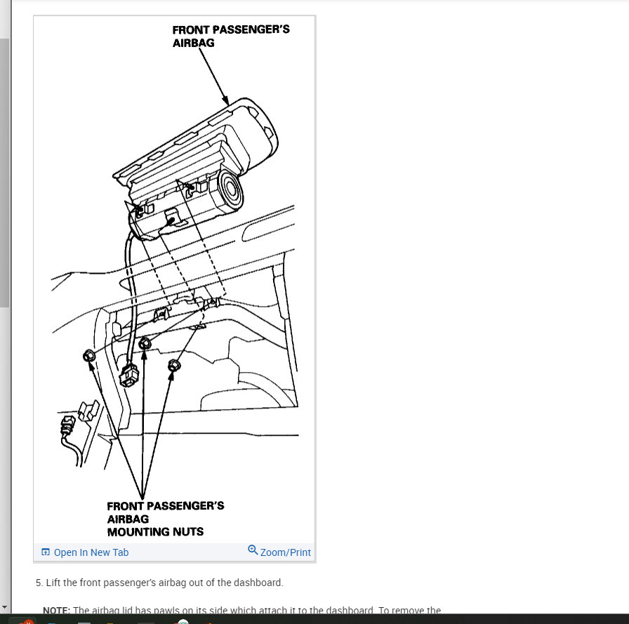

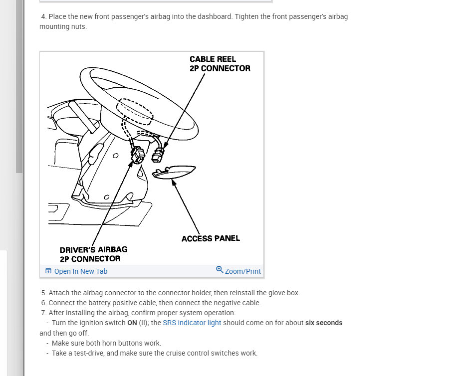

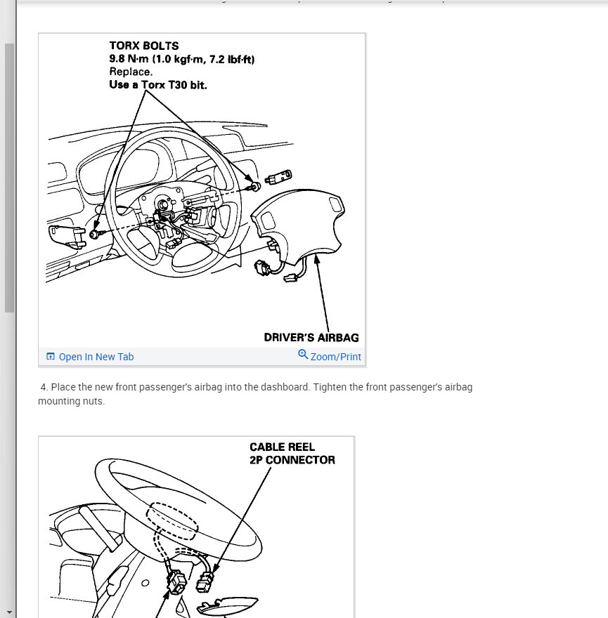

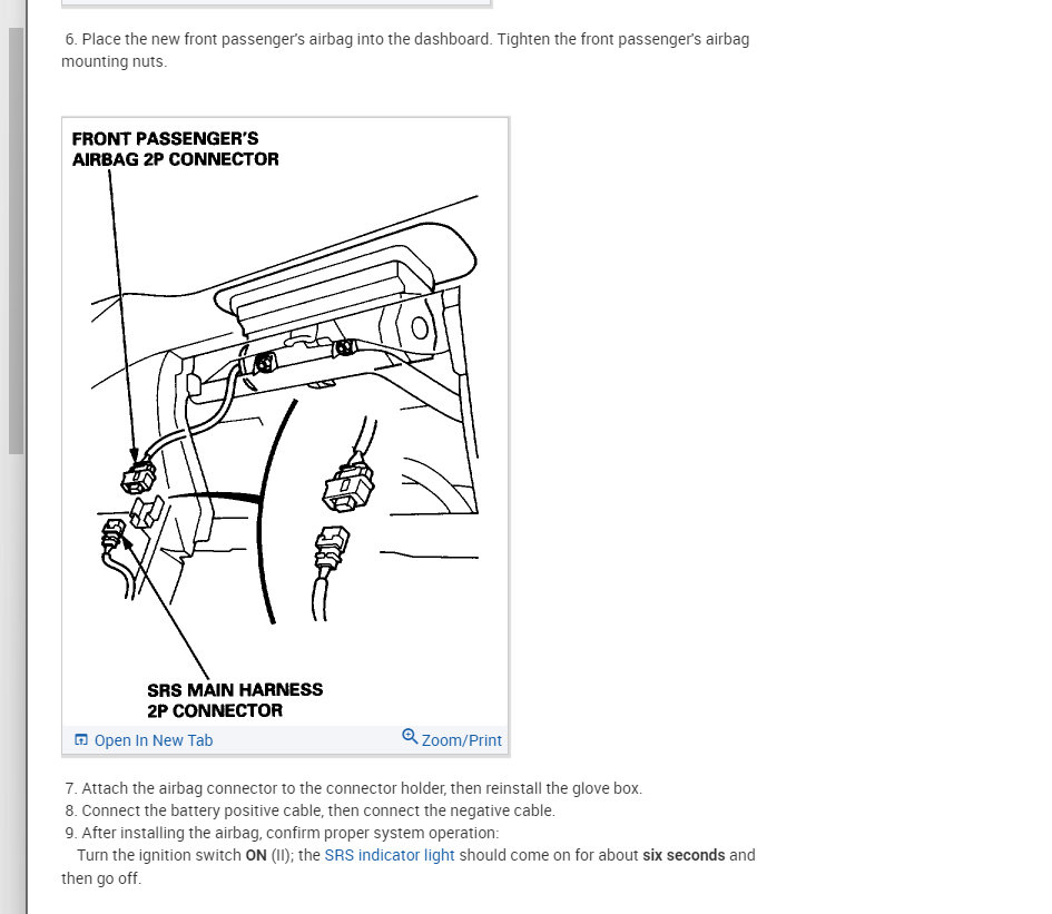

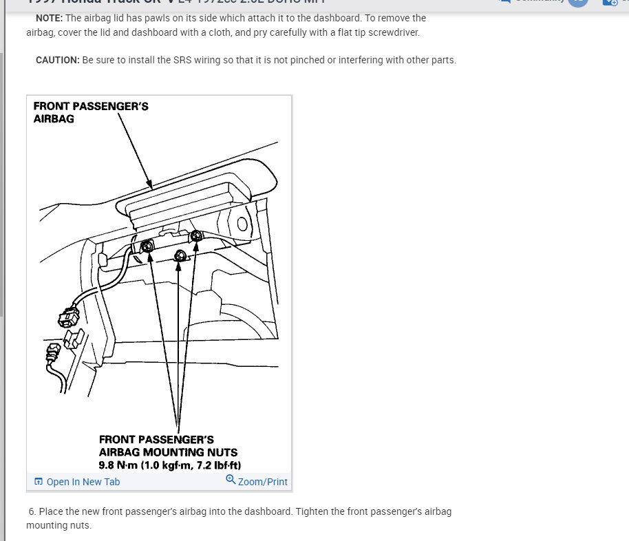

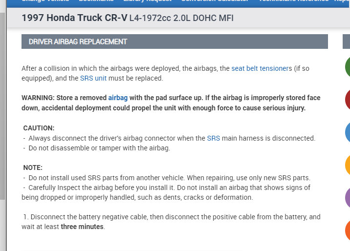

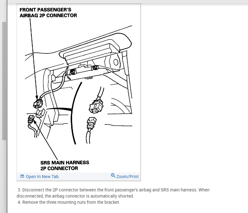

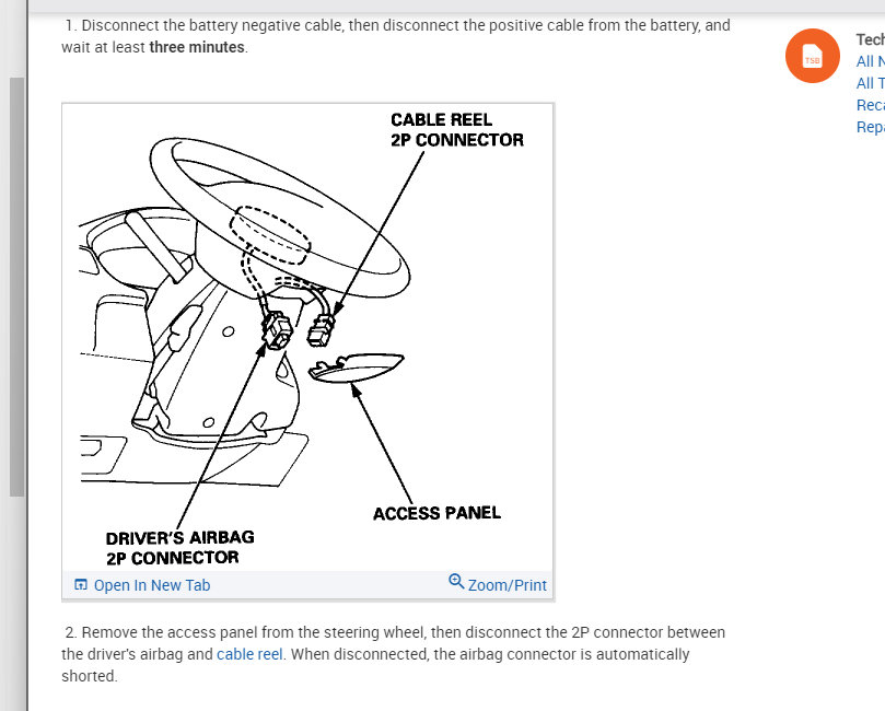

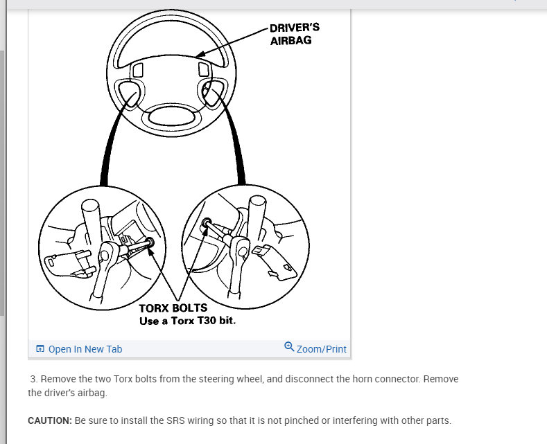

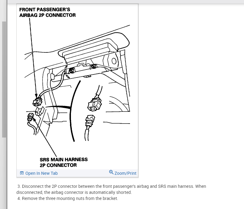

The Honda service manual shows a 2P connector to disconnect, but I cannot find the connectors where they indicated.
May 6, 2022 at 5:32 AM
I am attaching the info from the manual below on how to replace both these airbags. Clearly, I would not recommend disabling these airbags as the vehicle is built with these intended to deploy in an accident. However, there are reasons that you would need these disabled like if you sit too close to the steering wheel but you need to apply to the government to get waivers. Otherwise, if this vehicle ever has to get inspected it will not pass as the airbag light is going to remain on.
https://www.2carpros.com/articles/air-bag-removal-steering-wheel
Please see the info attached on how to replace this.
Let me know if you have questions. Thanks
