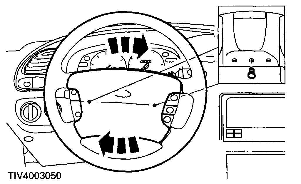

I have the vehicle listed above SE model. i bought it for a car to get me to and from work so i expected to need to put a little TLC into it. However, i did not expect for the whole horn/airbag module to fall off the steering wheel into my lap every time i make a turn. There is no airbag light on the dash while the car is running and when i first start the car the airbag light stays on for about three seconds then turns off. Can someone please help me figure out if it is okay to just screw this thing back in place? Or will i need to replace the whole module and reset the AES?

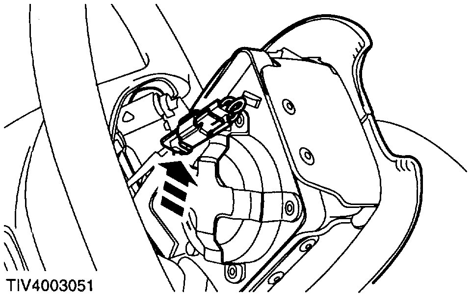

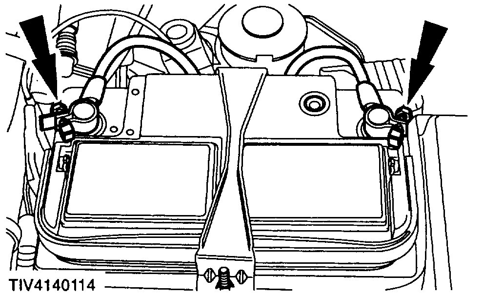

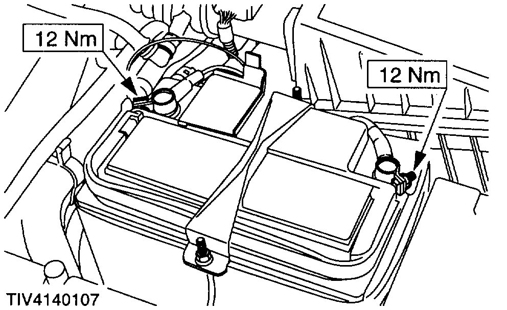

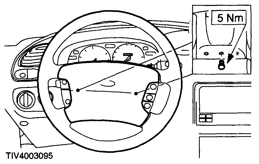

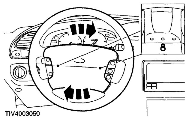

Can you upload a pic of what is falling off? I am going to provide the directions for removal and replacement of what I think you are referring to. If I am wrong, please let me know.
Note: The directions and attached pictures show where and how the airbag unit is attached to the steering wheel. Let me know if it helps.

Picture 1
1. Disconnect the battery cables.
Picture 2
2. Rotate the steering wheel 90 degrees to access and remove the Torx screw. Rotate the steering wheel 180 degrees to access and remove the Torx screws.
Picture 3
3. Remove the driver air bag module.
^ Disconnect the electrical connector.
^ Remove the air bag module.
Picture 4
Picture 5
INSTALLATION
1. To install, reverse the removal procedure.
