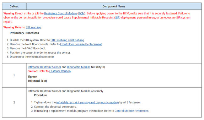

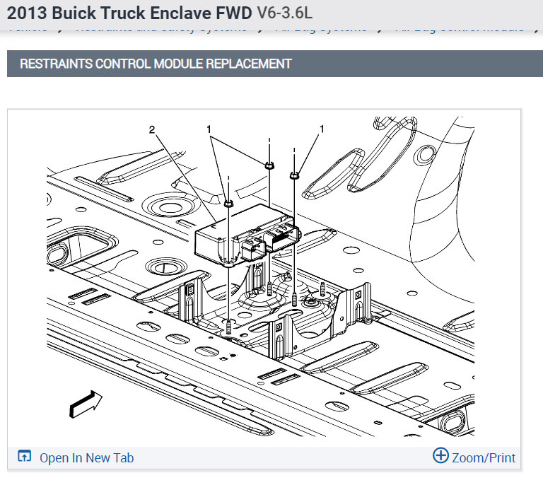

Airbag light/codes B0022, B0015, B0014, B0021, and B001E?
2013 BUICK ENCLAVE
164,000 MILES • V6 • 4WD • AUTOMATIC
BHAMDOC1973
  • 2,007 POSTS
I read some forums which state that some people had issues with the airbag light, and it was pulled harness or something similar that is common but am not sure where it is under the seat.
These are the initial codes:
B0022
B0015
B0014
B0021
B001E
I tried to erase them to see if any stayed on or which stayed on, but they all did.

Here is the information I found on thes codes:
B0022: This code usually refers to a problem with the driver frontal deployment loop (stage 1) circuit.
B0015 and B0014: These codes are often associated with the left front (driver side) seat belt pretensioner deployment loop.
B0021: This code typically points to an issue with the right front (passenger side) seat belt pretensioner deployment loop.
B001E: This code is less common and may be specific to certain vehicle makes and models.

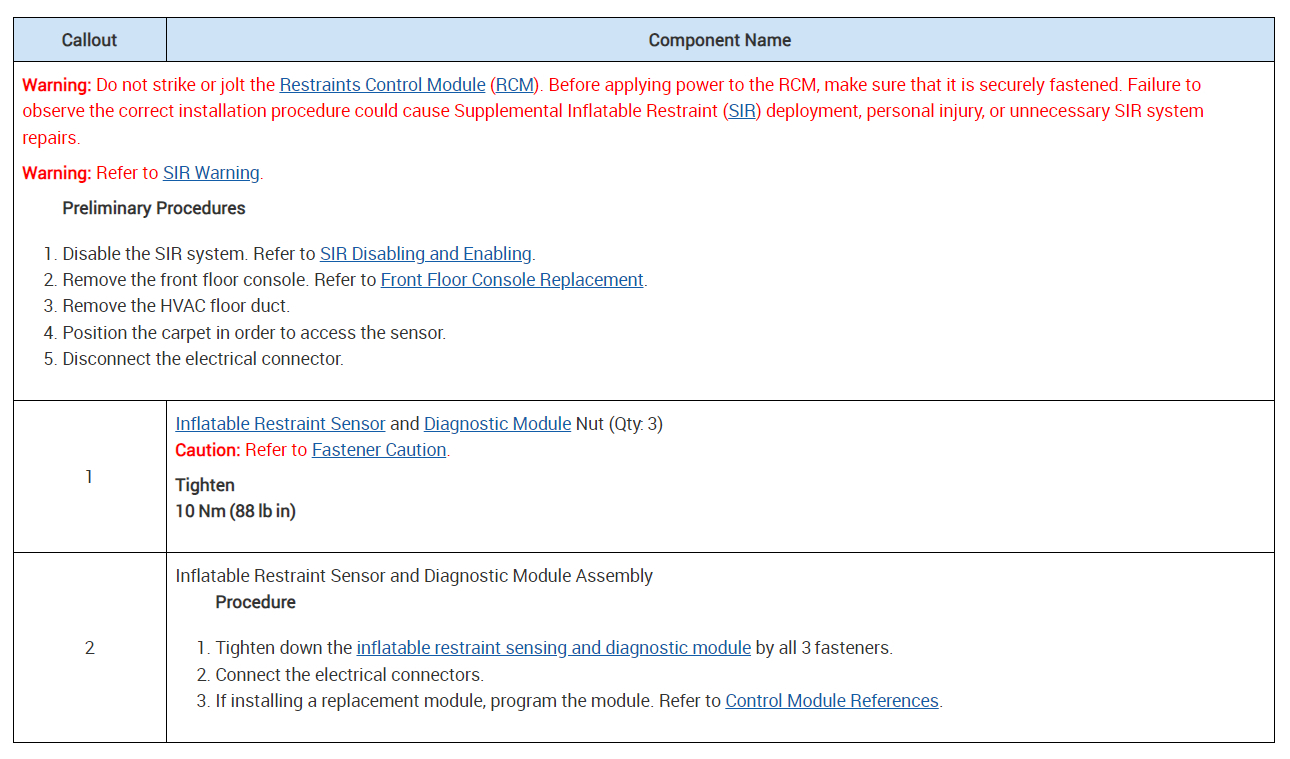

Was this car in an accident? If so this would explain the problems, the components of the airbag system will need to be replaced. If not I would replace the airbag control module, here is the location and how to do the replacement. Check out the images (below). Please upload pictures or videos of the problem so we can see what's going on. Have you considered helping us out at our go fund me page?
