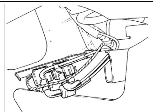

My car has blower motors running but cannot get air anywhere. I cannot find any vacuum leaks under the hood. I opened the center vents manually but still no air. I was going to try to manually open the blend flap but do not know where it is.

Did some further checking. I have vacuum to the box under the battery but don't have any under the dash

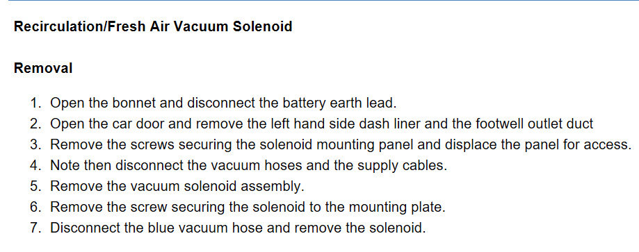

unfortunately we do not have any vacuum diagrams of the heating system. your car does not have a blend door it has a hot water valve in heater hose. I did find a solenoid for recirculate/fresh air which is on pass side here is some instructions and a picture of another solenoid nearby for help as you may find a vacuum line off. See pictures.
