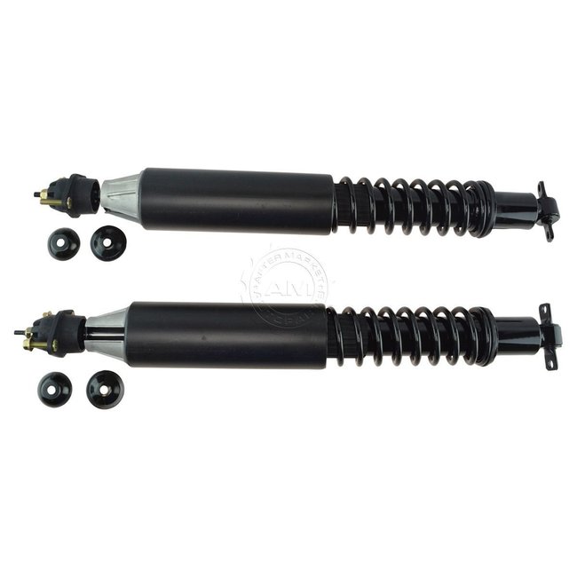

My shocks are getting pretty worn so i have to make a decision. do i convert to the regular shocks with springs or stay with air shocks. my car has 190,000. the air system works for now except for worn shocks. however, if i change to the regular gas shocks i can bypass that system saving myself some headaches down the road if the system fails. saving money is more important to me than ride. but is there a big difference? i found some gas shocks with springs for about the same price as the air. thoughts? thanks, Don

Hi Don, and thanks for using 2CarPros.
The picture you attached shows shocks with helper springs. They are used when the coil springs are weak and sagging or you carry heavy loads. If you install new coil springs, the height will be fine. Remember, it is the coil spring that holds the weight of the car and not the shock. The shock is nothing but a dampener that slows and controls bouncing.
Now, with that in mind, the call is really yours. Being that it is 21 years old, you may start running into other problems with the system which can get expensive.

Thanks for including the photo. Unless those are listed specifically for this purpose, those springs will not hold the car up at all. Those are helper springs to be used to get the suspension ride height up back up to specs after the original coil springs have sagged from age. As proof, you can collapse those shock absorbers by hand. There is no way those can be strong enough to hold up a thousand pounds of car. I could be wrong about those. Original coil springs for this car model are pretty light, so it could be possible these in the photo will do the job.
As a suspension and alignment specialist who has test-driven a lot of cars, I can assure you there is little noticeable difference in ride quality between air springs and coil springs. The big advantage to the air springs is the systems can adjust for different loading.
Look at the rear suspension to see if the pockets and mounts are already there to install a pair of standard coil springs. All of the shock absorbers listed for this car are air shocks which will allow you to keep the self-leveling capability.

The coil springs are still be there. these are "replacements" for air shocks.

JACOBANDNICKOLAS will these work for dampening and slowing and controlling bouncing? this type of shock is what they show to convert from air to regular shock. so they are supposed to work for that. all other answers aside. that is the question. i shouldn't have said about keeping the rear up. the springs are fine

Yes, they are fine for controlling the bouncing. The ride may be a bit firmer since the shock has the additional spring, but other than that, it's fine. Just make sure, as Caradio mentioned, get a good coil spring in addition to these shocks. I believe he felt you weren't installing coil springs along with the load lever shocks and he is correct. The shock in your picture will not hold the vehicle's weight.

Sorry for my misunderstanding. I was thinking about air springs that are huge airbags that can be used in place of coil springs. The replacement coil springs I described are what you already have.
The issue is still correct ride height, and that has to be measured at specific points to be sure it's right. Your old shock absorbers are air adjustable to correct ride height as you add more and more dead bodies in the trunk. Those in your photo are designed to handle the majority of height problems when the original shock absorbers stop working. Ride quality is likely to be improved, not from switching to shock absorbers with helper springs, but from replacing mushy and worn shock absorbers.

Yep, i just want to use these instead of air shocks. i realize they don't have all the benefits of air. basically this would be just changing from air to reg shocks. they will do the job? correct? thank you and sorry about the mix up but still filling just a bit confused. i think you did answer my question in your last answer Joe.

Not a problem. And yes, you have to install coil springs in addition to the shocks you identified. They come as a set in the conversion kit.

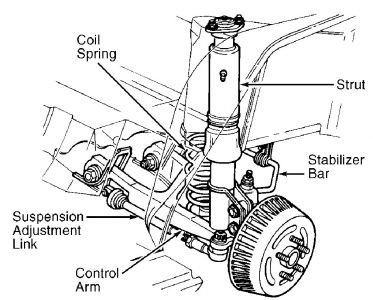

  • 110,248 POSTS
There should be coils there now, but when you get the conversion kit, that usually replaces everything. I attached a picture for you to look at. The picture is what you should have presently. You will see a coil spring and an air shock. The air shock is replaced with the original picture you sent me. The coil spring in the picture is usually part of the conversion kit and gets replaced at the same time. Check your vehicle and confirm the picture is the same as what you have.
I hope this helps. Let me know,

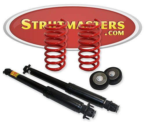

DCKELLEY
  • 125 POSTS
https://shop.advanceautoparts.com/p/monroe-air-shock-to-load-assist-shock-conversion-kit-90007/10020739-P
i can get these for $77.00 load assist shocks no need for anything else apparently.
Mar 6, 2019 at 7:42 AM
DCKELLEY
  • 125 POSTS
The spring conversion kits use more powerful springs with a non load assist shock. $400.00 for this as opposed to the load assist shocks for $77.00.
