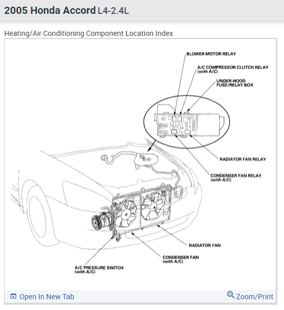

A/C not working
2005 HONDA ACCORD
200 MILES • 4 CYL
PYLESKAREN61
The air conditioner has been working off and on, now it's off again. Fuses are good.
Aug 21, 2021 at 9:52 AM
SQM
  • 6,383 POSTS

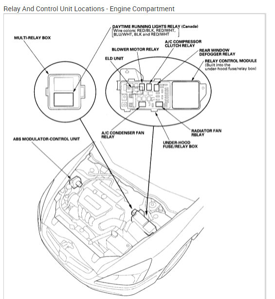

Does it blow air at all? or is it just blow hot air?
Can you hear the compressor kick in?
The compressor is controlled by a relay. That relay is located in the fuse box under the hood (see diagram).
Check that relay. Check for any corrosions on the relay or burnt pin.
You can also test the relay as well.
Please let me know little bit more information.
