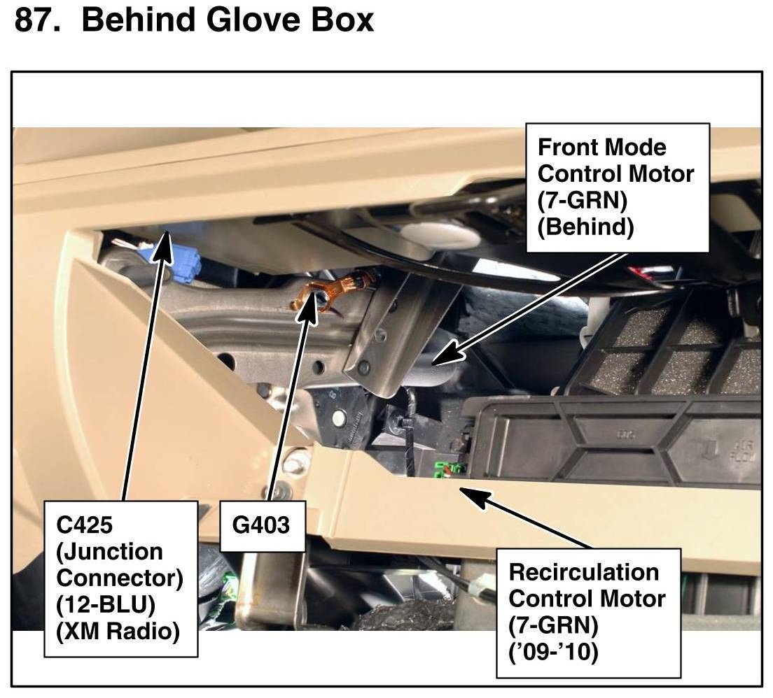

The mode door is responsible for directing air flow. If you are not getting air through the vents on the dash, that is my first suspect.
The mode door actuator is behind the glove box. If you are facing it, the component would be roughly at 9oclock. See picture 1

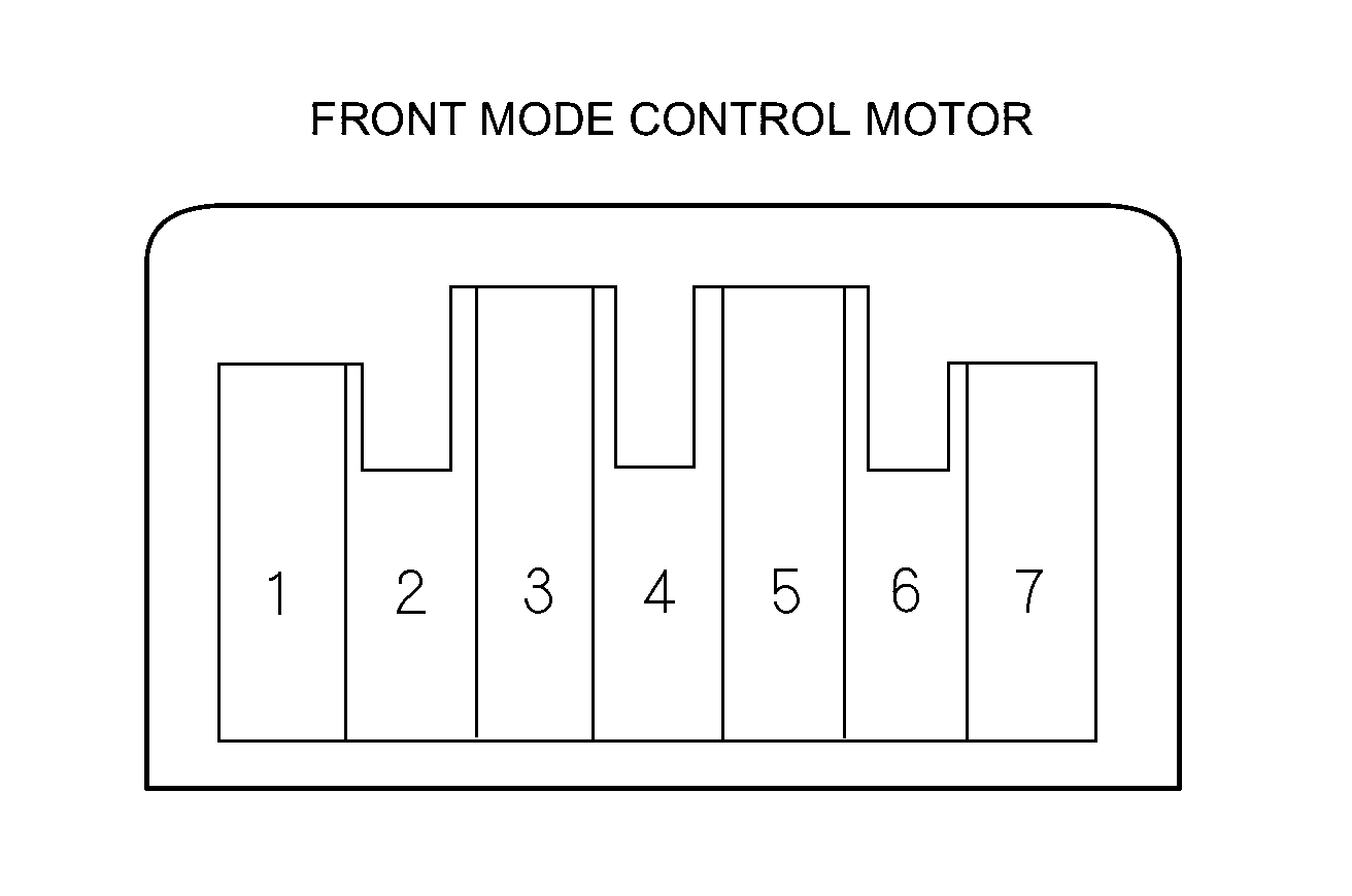

1. Disconnect the 7P connector from the front mode control motor.
NOTICE
Incorrectly applying power and ground to the front mode control motor will damage it. Follow the instructions carefully.
2. Connect battery power to terminal No. 1 of the front mode control motor, and ground terminal No. 2; the front mode control motor should run smoothly, and stop at Vent. If it doesn't, reverse the connections; the front mode control motor should run smoothly, and stop at Defrost. When the front mode control motor stops running, disconnect battery power immediately.
pic 2
3. If the front mode control motor did not run in step 2, remove it, then check the front mode control linkage and doors for smooth movement.
- If the linkage and doors move smoothly, replace the front mode control motor See: Air Door Actuator / Motor, HVAC > Removal and Replacement > Front Mode Control Motor Replacement.
- If the linkage or doors sticks or binds, repair them as needed.
- If the front mode control motor runs smoothly, go to step 4.
4. Use a digital multimeter with an output of 1 mA or less at the 20 kOhms range. With the front mode control motor running as in step 2, check for continuity between terminals No. 3, No. 4, No. 5, and No. 6, and terminal No. 7 individually. There should be continuity for a moment at each terminal as the motor moves past the switch's terminal.

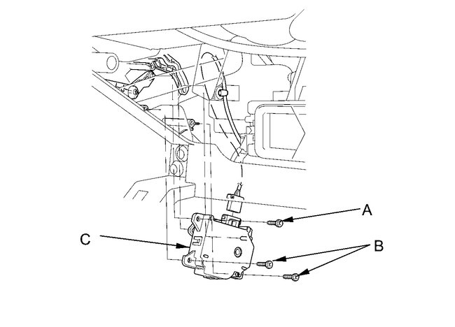

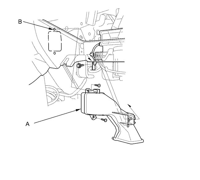

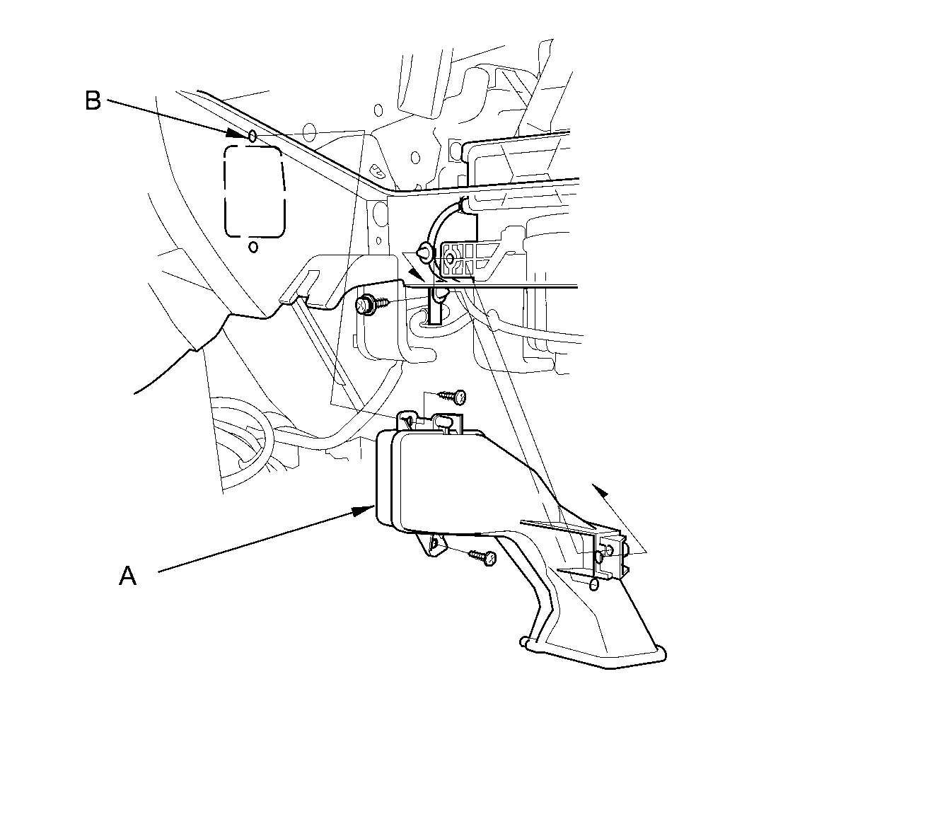

2. Remove the bolt, self-tapping screws, harness clip, and the passenger's heater duct (A).
NOTE: Removing the upper side screw, through the hole (B).
pic 3

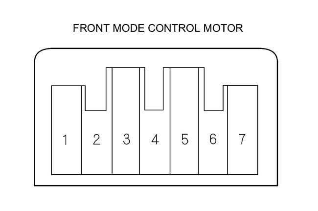

3. Remove the self-tapping screw (A) from the upper side, then remove the self-tapping screws (B) from the lower side, then remove the front mode control motor (C).
pic 4
4. Install the motor in the reverse order of removal. Make sure the pin on the motor is properly engaged with the linkage. After installation, make sure the motor runs smoothly.
