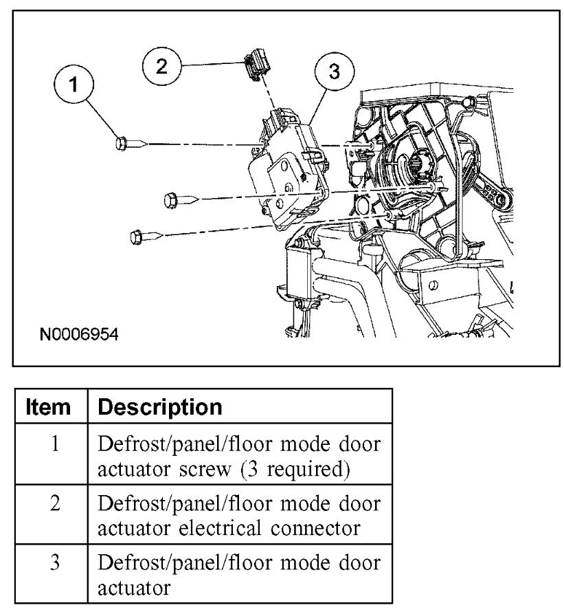

Air conditioning only blowing in the defrost position, won’t allow me to change the air direction. Any cheap hacks to fix this would be great. I’m thinking it’s the actuator hose but I’m not even close to being a mechanic. I didn’t grow up rich, but my dad always had me send the car to the shop growing up versus learning to fix it myself.

That sounds like a failed mode door actuator- Ford 5F9Z19E616GA. Go under the dash on the driver's side and look up, you will see the actuator up toward the top of the heater case. There will be another one at the bottom. You want the top one.
Reach up in and remove the three screws, disconnect the electrical connector and remove the actuator. Reverse the process to install the new one.
