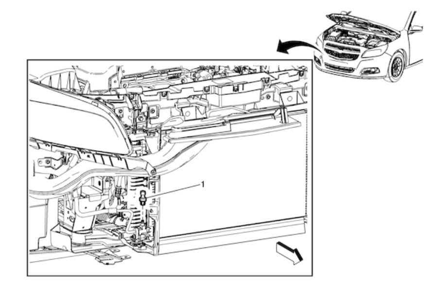

I need to change my A/C high pressure sensor. I do not know the location of it.
Jun 8, 2020 at 1:37 PM
Good morning,

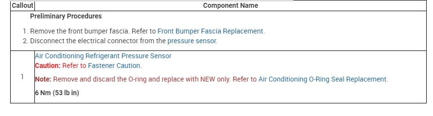

I attached a picture of the location and the procedure for you for the repair.
It is behind the front bumper cover down low at the bottom of the compressor.
