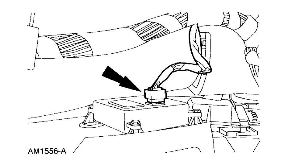

The A/C compressor and all parts have been replaced on this car. Now the air is blowing hot. I have been told it is an actuator under or in the dash. Is that hard to replace?
May 9, 2018 at 4:39 AM
Good evening.
If all the pressures are correct then it is possible that the actuator is the issue.
When you command heat and cold, can you hear the mode door move.
The procedure is a full dash removal to access the actuator. it is on top of the case under the windshield.

Thanks for your response. Sounds pretty complicated.
May 10, 2018 at 12:36 AM
Yes, it is if you have never done it before. It is a shame Ford mounted it where they did since it is a common failing part.
In a shop, it pays over six hours to replace. If you try it at home, I would plan on spending at least double the time doing it yourself.

Okay, make sure you remove the negative cable.
1. remove the lower kick panels on both sides so you have access to the bolts for the carrier or the dash.
2. remove the pop panel at the windshield. it goes from one end to the other. there are about five screws that have to be removed. they should be 7mm screws
3. remove the lower knee bolster under the steering wheel. there is a plate there as well that has to be removed. it has about four 8mm screws. once that is removed you can access the four bolts holding up the steering column. remove them. as you lower the column to the seat, there is a quadrant string that show the gear you are at. Remove the bolt holding that to the column.
4. gently lower the steering column to the seat.
5. at the center on the floor. peel back the carpet and there is a support bracket that needs to be removed. it has two nuts and two bolts. remove the bracket.
6. you should have a floor jack now. you will be removing the bolt on the driver's side above the kick panel. once you do, the dash will get very heavy. it will be best to have someone with you for this.
7. then remove the other bolt. place the jack stand on the floor. once that bolt is released. the dash will come back. bring it back enough to sit on the jack stand so you can rest it there.
8. the dash should be back about 18 inches. this should allow you to access to the actuator at the top of the case in the center just under the windshield. then you remove the bolts and remove the actuator. remove the wires and out it comes.
Good luck
