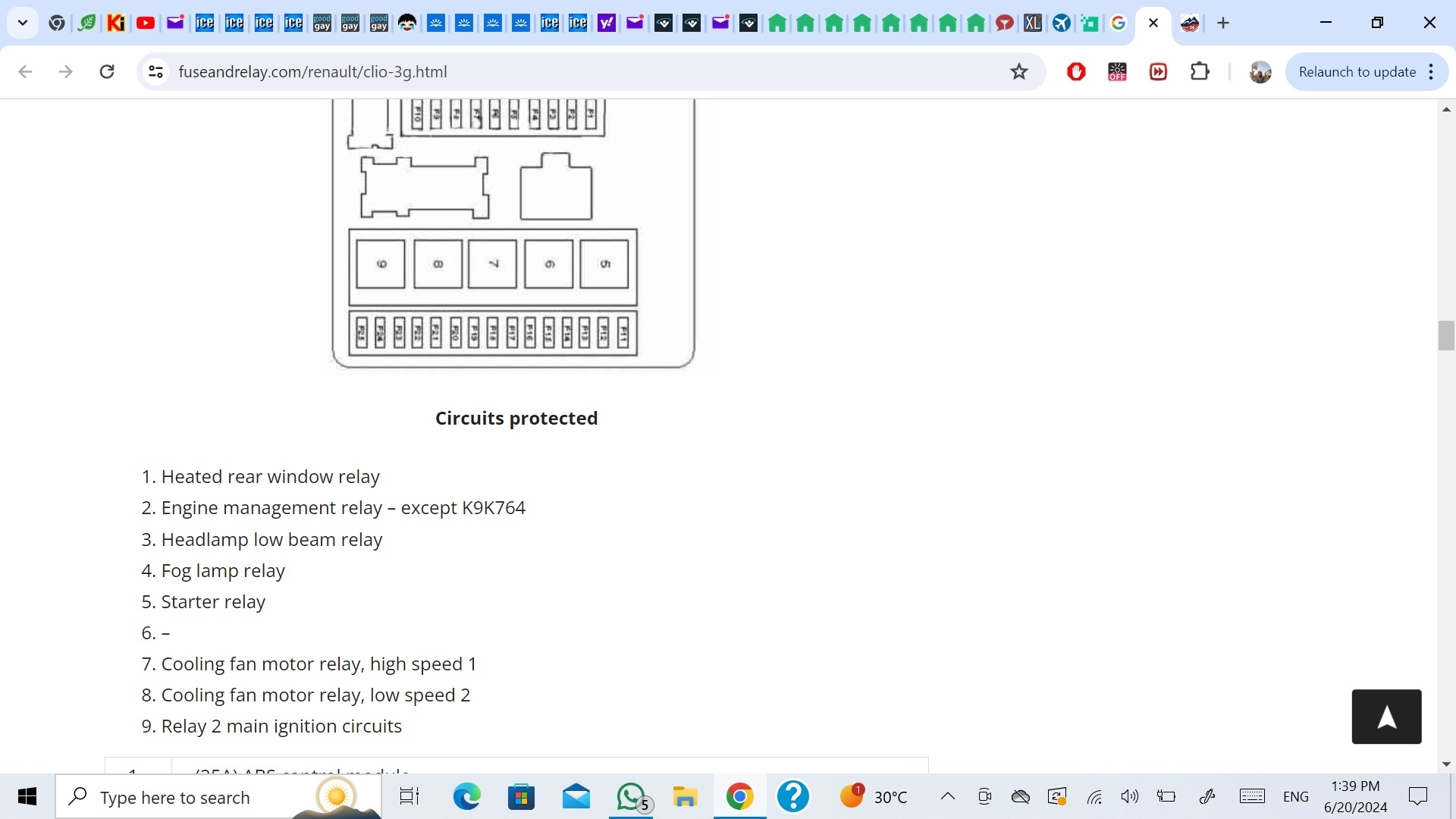

This is the diagram I found. No relay for A/C but maybe its somehow about number 6 or 7?
Thursday, June 20th, 2024 AT 3:43 AM
  • 109,874 POSTS
Numbers 6 and 7 are for the radiator cooling fan. By chance, do you have the original owner's manual? It may have something listed.
