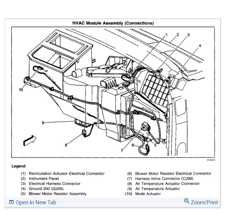

My compressor is running fine it has the proper charge of 134A. lines cold and its condensation. But I'm either getting vent air out of dash or a blend door is half open to the heater core. My blend door went out that controls where the air comes out defrost floor or panel I replaced that one. the one above the passenger floor i took off and turned it but made no difference am i missing somethin is there another blend door that regulates temp. Help please thanks.

Yes, there is a mode blend door actuator which need to be replaced. Here is a guide to help you step by step with instructions in the diagrams below to show you how on your car:
