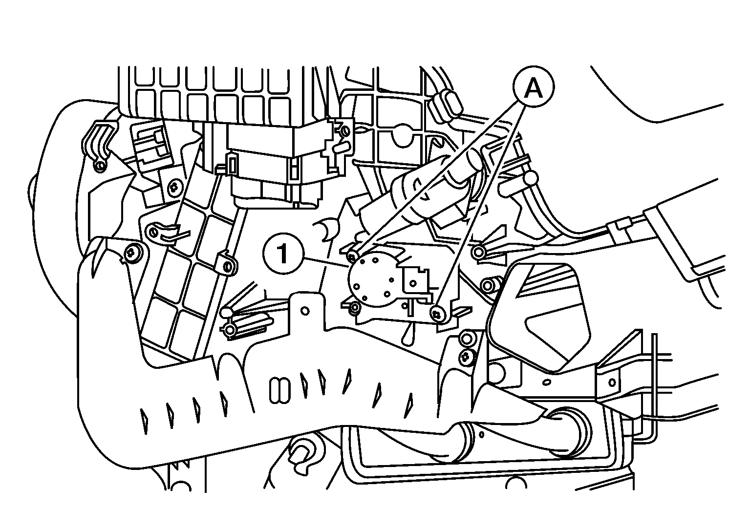

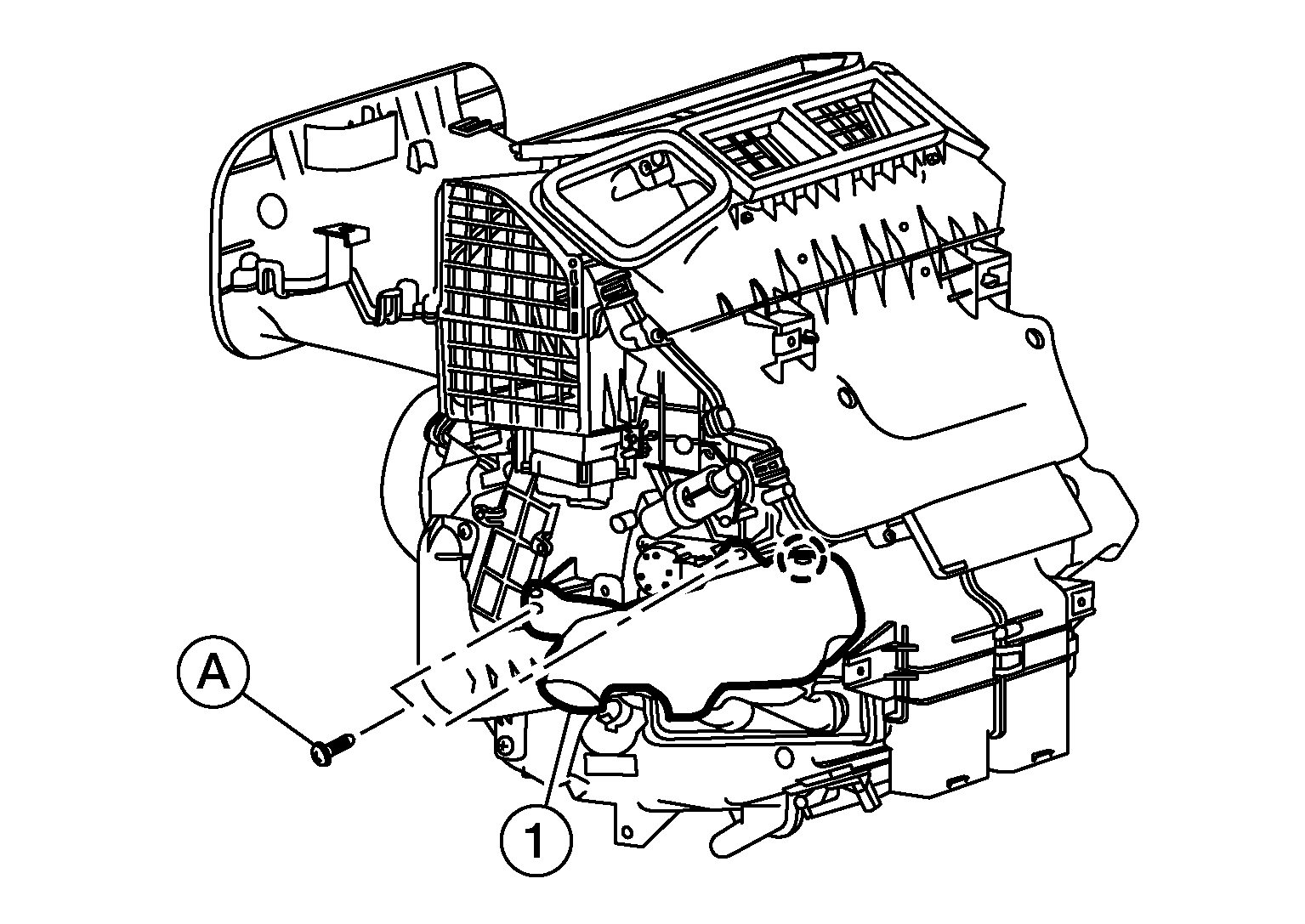

Sounds like an electrical problem. Is this a manual AC system or an automatic one? Both can set codes when they have problems but you need a proper scan tool to read them. It may be the blend/air mix door actuator or it could be the controller. If it has a code it could help point the way.

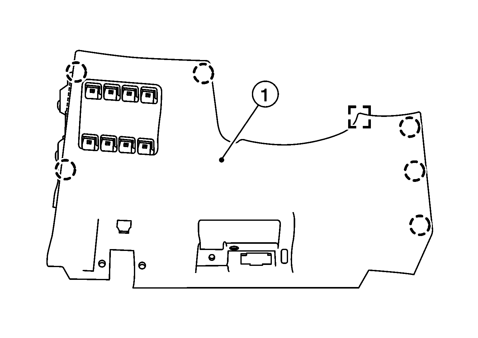

If it is the mix door you drop the trim panel under the steering wheel, then remove the floor duct and the actuator is on the side of the HVAC case. You should see it move when you change the temperature control.
