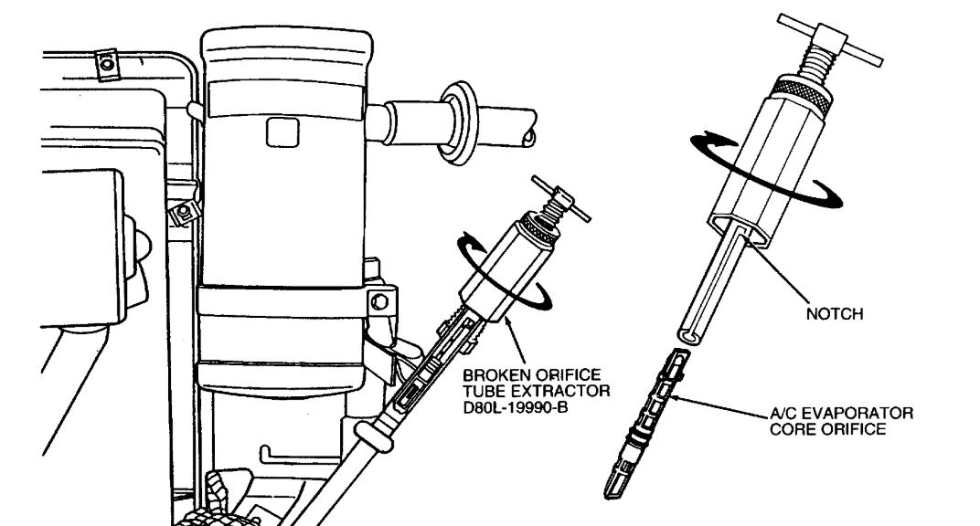

With ambient temperature of 82F and humidity of 74% the low side is 40-42psi and high side is 160-165psi. (Lower # compressor cycled off and higher # cycled on.) Static pressure after its turned off is almost equal at 115 and 120. DTC 00 No codes.
High side seems low to me but everything I’ve found indicates low side is okay.
I’m afraid of overcharging the system. But should I add refrigerant anyway?

The low side is the issue. It is too high. It should be 25-30 lbs. 42 is rushing the Freon through the evaporator too fast and that means cool, not cold air.
The fact the static is not the same confirms it. They should be exactly equal.
You need an expansion valve and a dryer.
