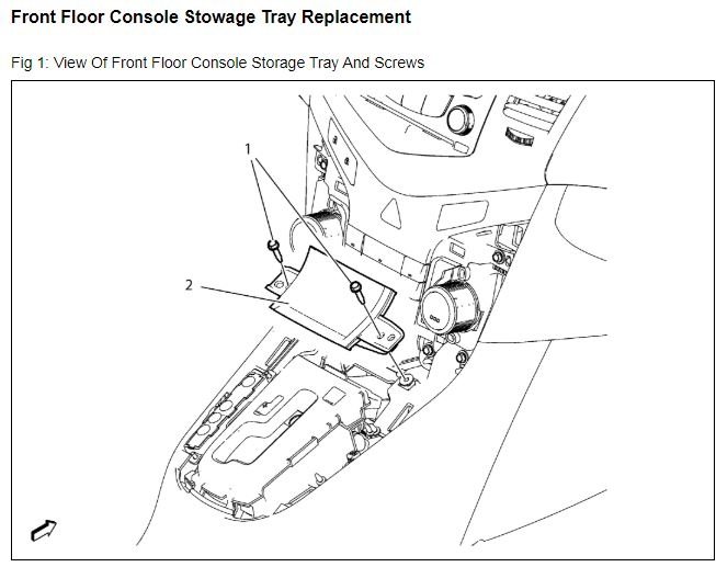

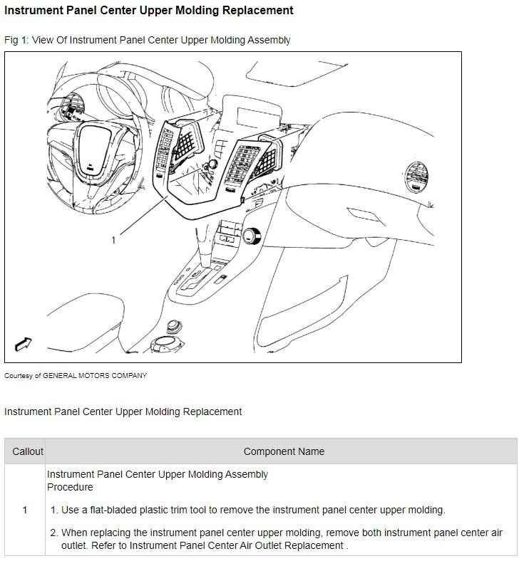

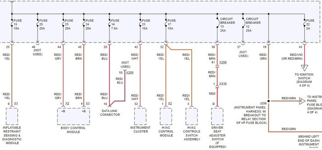

I apologize, but I hadn't attached any pictures yet. Fuse 23 powers a portion of the Body Control Module, which would make sense as to why you lost indicators and other functionality with this fuse removed. It shouldn't have anything to do with your blower motor running all the time. Fuse 17 does power the HVAC (Heating Ventilation Air Conditioning) module and control panel, so this definitely would cause the blower to turn off(see attached diagram). Your vehicle also uses a blower motor control module(which is powered by Fuse 11) to control the speed of the fan. This is most likely the cause of your issue. However, let's see if we can narrow a few things down first. Can you verify that pulling Fuse 17 by itself causes the blower motor to turn off?

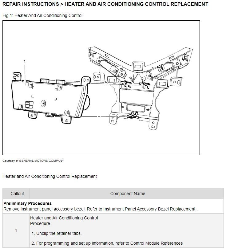

When you have the fuse installed (and blower running) are you unable to turn the temperature control to heat? Does the mode switch (defrost/vent/floor) respond to changes?
Nov 3, 2019 at 12:29 PM
FRED BOLING
  • 14 POSTS
None of the switches work. It like they are dead when you depress them . What about the Blend door actuator could it be bad?
Nov 3, 2019 at 12:35 PM
MASTERWRENCH
  • 258 POSTS

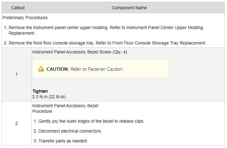

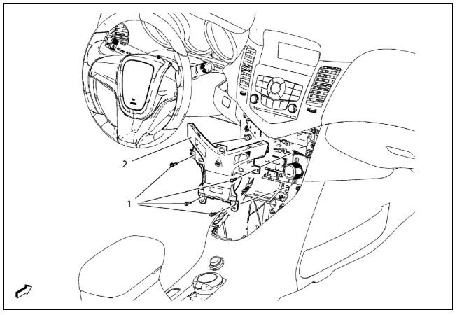

At this point, it sounds like your HVAC control head has failed. Attached below are the replacement instructions.
