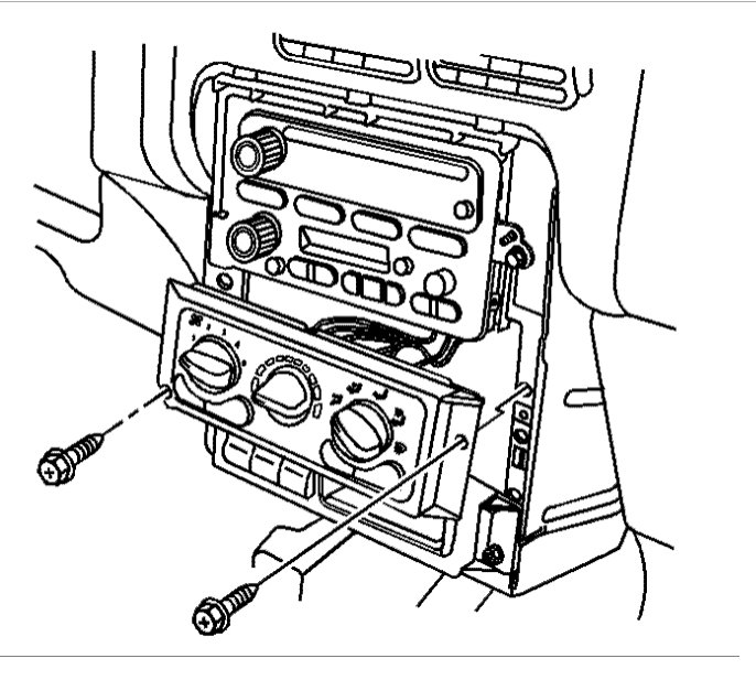

The AC fan comes on the compressor is good. just blows warm air. Does not need Freon, husband put some in. Also, at the same time the AC quit working so did the digital odometer and the digital temperature/direction gauge. My husband checked fuses and says they are all good.
Aug 18, 2017 at 11:26 PM
  • 55,433 POSTS

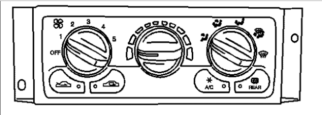

It sounds like the climate control module has gone out and needs to be replaced. Here is it location to show you how to get the job done and back on the road.
Please let us know what happens so it will help others.
