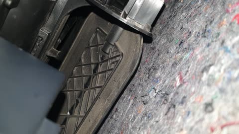

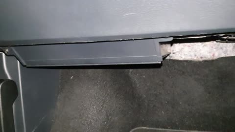

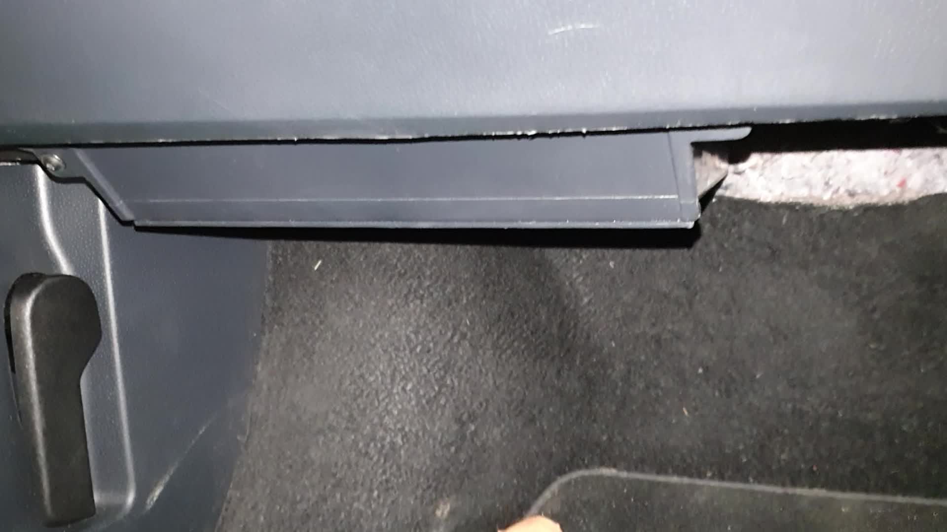

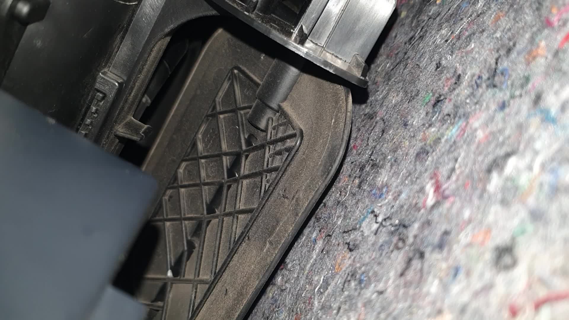

Hi Ken,
I'm having a similar problem with my Seat Ibiza. Any idea? I have attached a video too. Doesn't look like the motor has gone as it is moving okay?
Jan 20, 2020 at 3:31 AM
  • 55,433 POSTS
The blend door actuator gears are stripped that's why it makes that noise and doesn't work right. I would get a new actuator and install it. Thanks for the video. it seem like it is cut off a little. can you back up and retake the video so I can see how to remove the part?
Jan 21, 2020 at 1:33 AM
CONNOR LOVATT
  • 5 POSTS
Hi Ken,
Thanks! Someone else has mentioned that. I have no idea how to remove it so that would be great! Is there an easy way to find the part number or do I need to remove it first to find this? Thanks
Jan 21, 2020 at 2:57 AM
  • 55,433 POSTS
Yes I would remove the part to get the number off of it or call the dealer to see if they have the part in stock which most of the time they will because they keep the parts that break. It looks like you will need to take apart the HVAC unit to get to it though. Please send more video of the job being done so I can see how it goes. ;)
