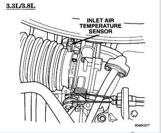

Air charge temperature sensor location
2002 DODGE CARAVAN
245,000 MILES • 3.3L • V6 • 2WD • AUTOMATIC
JAXSONPHOENIX
I am trying to figure out where the air charge temperature sensor is located on my van.

I believe you are referring to the inlet air temperature sensor. I attached a picture of that below. If I am wrong and you meant something different, let me know.
Let me know if this helps.
