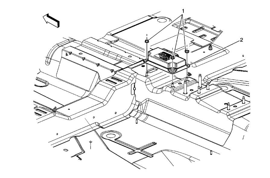

Hello, I am being told by Chevrolet for my car listed above I need an airbag modular. Part #23496793. Their price $675.00. This brings up the sensor under the seat. When this gets replaced, does the steering wheel also need to come off to address the air bag, disable it, anything?

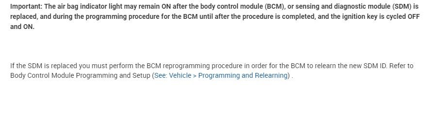

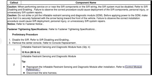

Good evening,
It is located under the seat. I attached a picture and the procedure.
The module must be programmed after it is installed. That will require special equipment to perform this operation before the system will come back online.

The service airbag light came on along with the service airbag on message board. I’m not understanding why the steering wheel would need to come off if we are just replacing the sensor module under the seat.
Jan 28, 2020 at 11:21 AM
What was the code that was set? They should have either told you or it could be on the work order.
