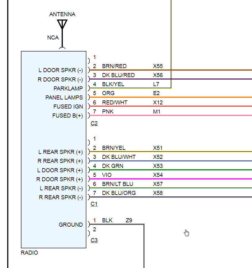

Here is the OEM wiring. The connector kit that you are plugging into this needs to match up with the wire colors that you are showing in that list you gave me. Clearly it does not list wire locations in the connector, it only gives wiring colors.
So you need to connect the kit connector to the OEM harness and then make sure each of the wiring colors listed on your list, lines up or is connected to the wiring diagram that I attached.
This means when it says the red wire which is ignition 12 volts, that it lines up with the OEM diagram where it says Fused Ign red/white.
I suspect you have an issue here when you say you had to splice the two together.
Let me know if you have questions. Thanks

Okay, will try. but in case it doesn’t work could the aftermarket harness adapter have a issues? I forgot to mention this but the adapter and the original harness have around a 1/8 inch play back and forth.

Yeah. It could. However, I would definitely start with making sure the wiring is correct. Then if needed and you suspect the connector, you can splice the wires together and eliminate the connector all together.
