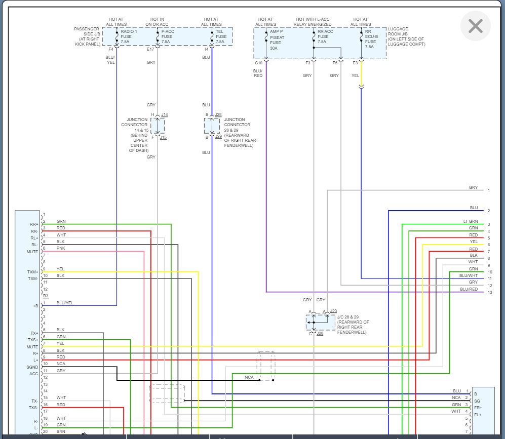

I am trying to find pin diagram of the factory radio to locate the amp turn on wire location. Also, I need steering wheel control locations. Not a Mark Levinson system.

Can you tell me the pin location on the factory harness for the amp turn on wire?
Jun 28, 2022 at 9:49 AM

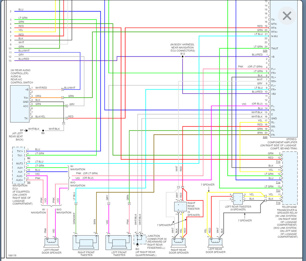

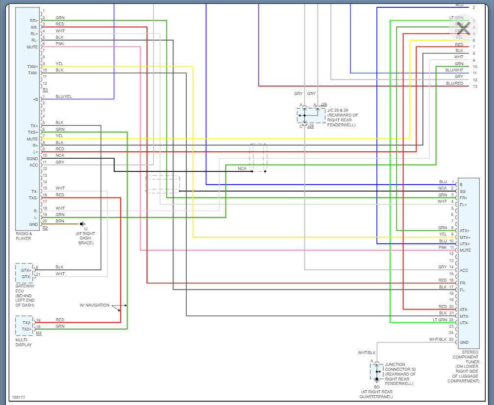

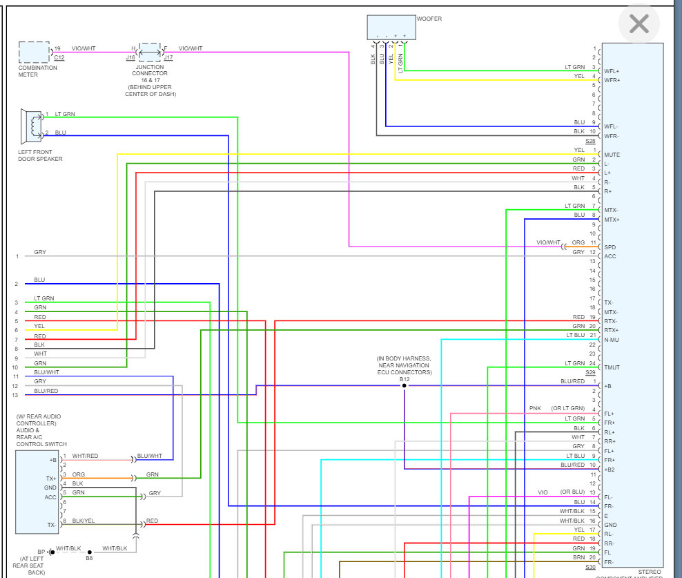

Just to jump in on this. I am attaching the entire wiring diagram below of the non Levinson system. We do not have actual connector views of the wires but the connector numbers, pin location and colors part of the diagram.
Let us know if you need more info. Thanks
