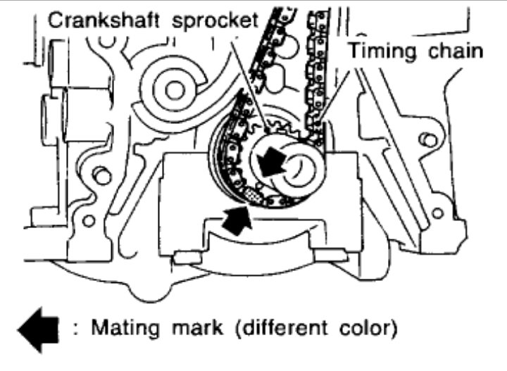

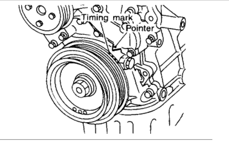

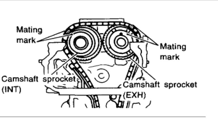

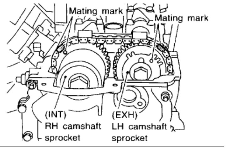

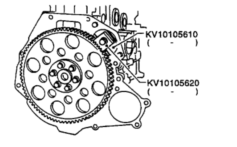

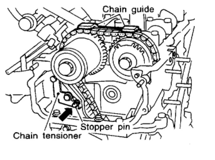

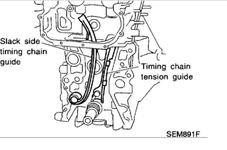

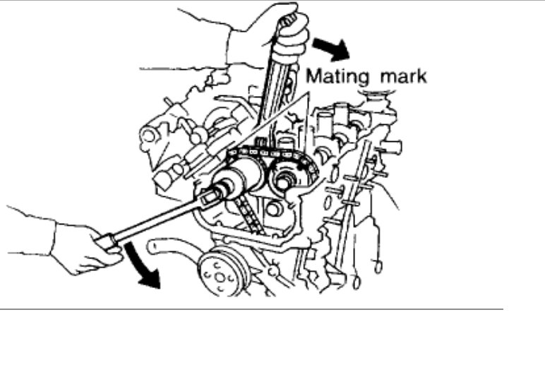

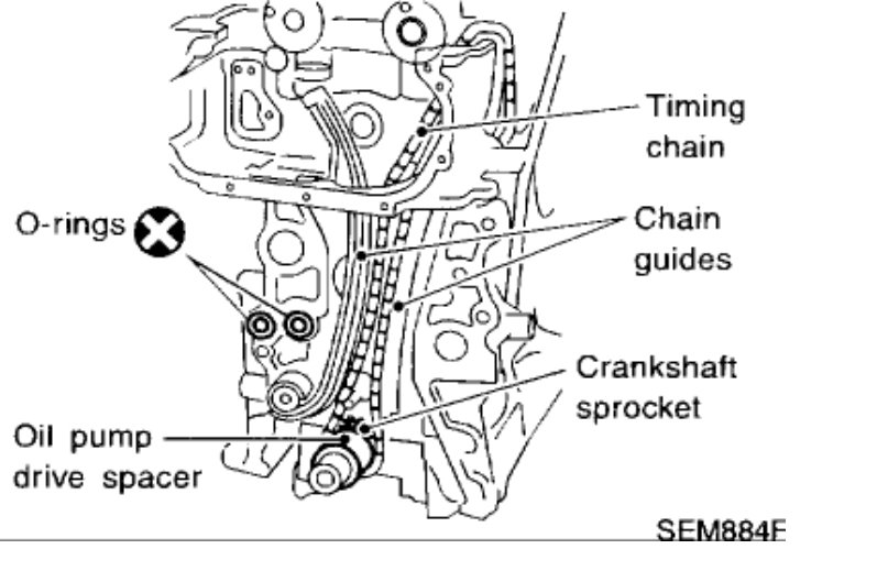

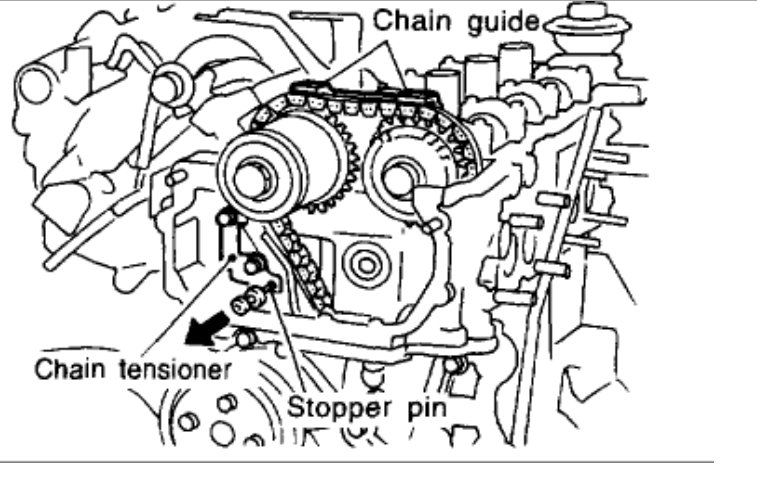

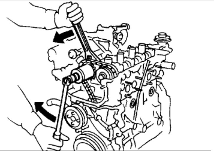

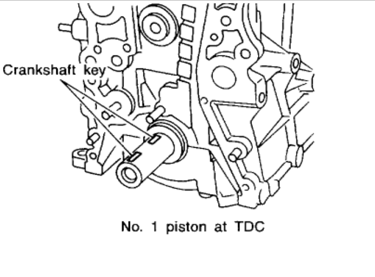

We changed the timing chains and the guides. Now the car wont start? We are thinking it's not in time. I have gas and a little spark. When I am trying to turn it over it turns slow. Do you know if the left cam should have play in it? Any ideas
Aug 16, 2014 at 6:28 AM
  • 55,845 POSTS

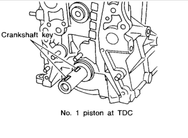

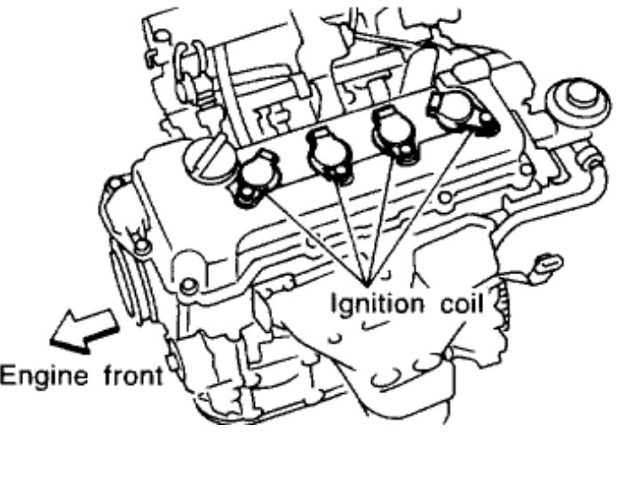

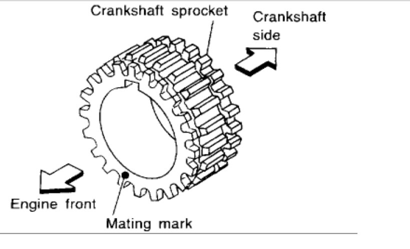

Yes it does sound like you got the timing wrong and the camshaft I would double check the marks and then goes from there.

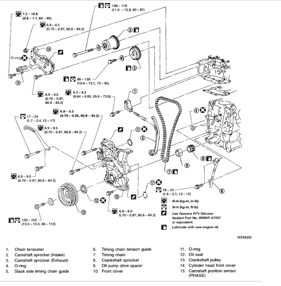

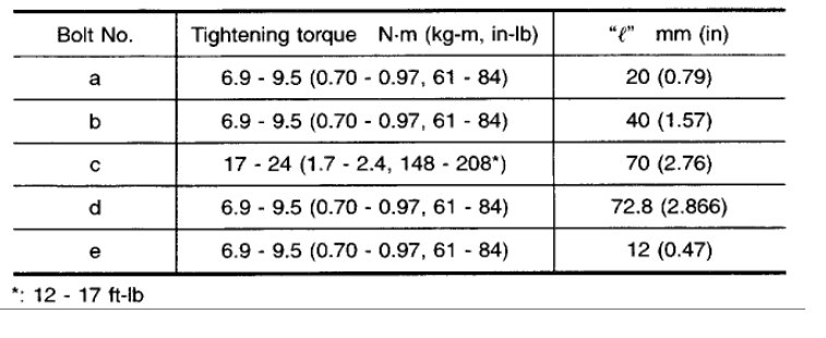

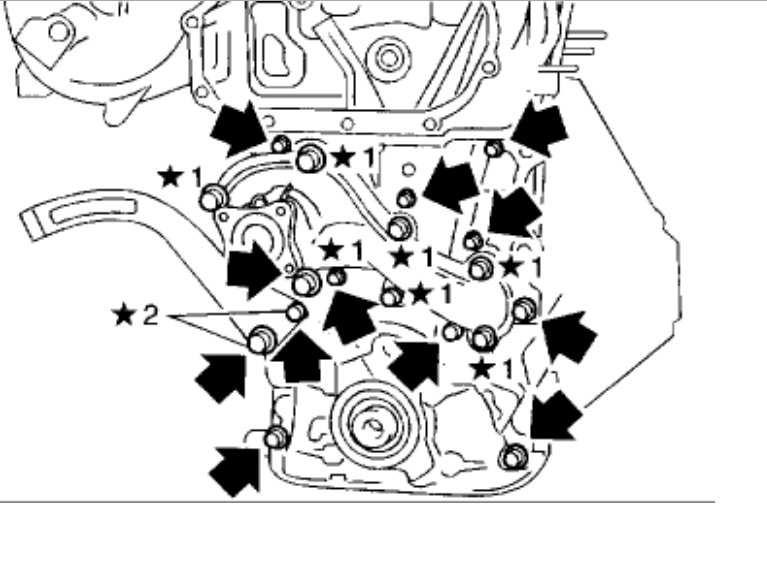

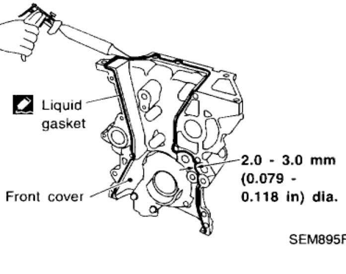

Here are some diagrams that will help you see if you are off or not?
