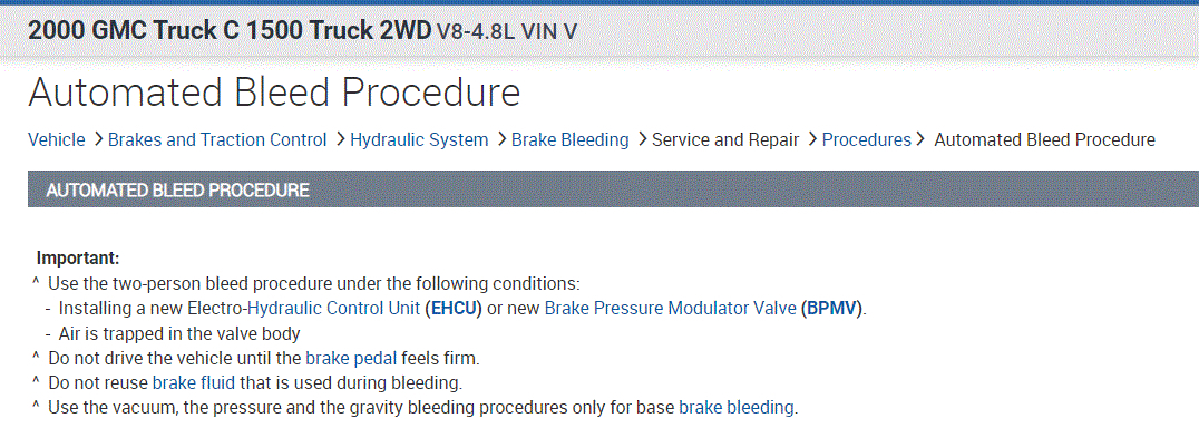

I'm at the end of my rope... I'm a 25 year mechanic and I've done everything I can think of to my truck listed above 1500 so I've turned to the internet for help. The brakes were not working to par but were recently replaced so I knew that wasn't the issue. My first step was to replace the master cylinder, no dice, so I replaced the pressure modulator, again, no dice, so next was the ABS pump motor. third time's a charm, nope. so I replaced the ABS control unit - you've got to be kidding, and lastly, the vacuum brake booster. All to no avail! I did all of the correct bleeding each time and there's definitely no air in the system but the brakes go to the floor when I turn the truck on (hold pressure when truck is off?) and I'm at my wit's end! Any suggestions other than buying a new truck? FYI, rear brakes are disc brakes and mileage is about 207,000. Any help would be fantastic! Thank you!

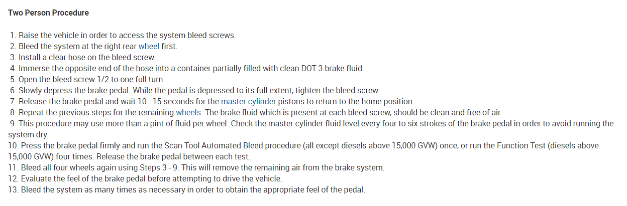

Did you perform an automated bleed on the ABS? Your description sounds like there is still air in it. That is where the issues usually occur.
I attached the directions below. Let me know if you have already done this.
See pics below. Note the automated bleed actually starts at number 10.

I'm with Ken. I've done some research and poked around AllData. If the problem is mechanical, it would have to be either the master cylinder or the brake pressure modulator. Since you've replaced both, I'm thinking the problem must be a stubborn air bubble somewhere. You may have to jack one part of the truck way up as you go around the vehicle bleeding at each wheel, but that bubble will get worked out. Go through the guides that Ken has referenced and let us know what you get. I think that'll get you straight.
