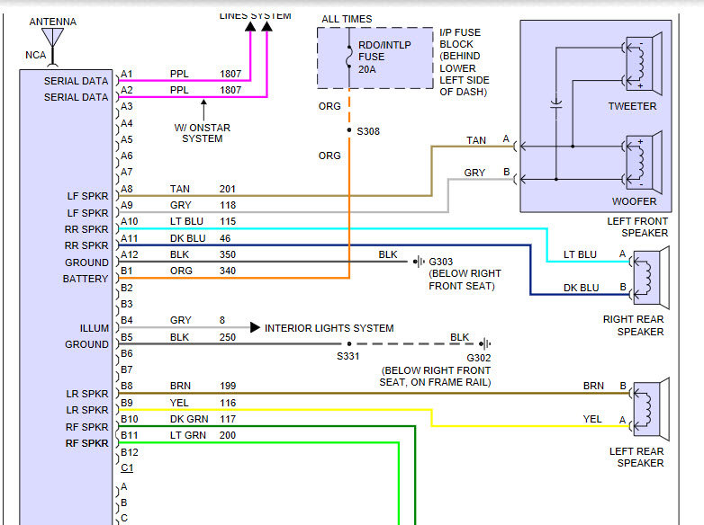

I bought a stereo for my wife's car now I know that black is ground, orange is constant power. Coming from the car. There are four wires on back of the stereo. Yellow is twelve volt battery, red is accessory, black is ground, and blue remote or antenna the rest are speaker. I bought a wire harness an cannot get power to the new radio. What can I do?

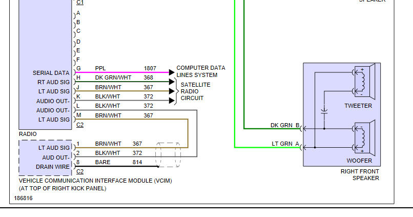

there are plug in adapters for this type of thing for around $20.00 is easiest way. the radio may not work because you have a vehicle communication module not sure if it is mentioned there. you might check with a radio installer as most mechanics do not get involved with it. here is diagram however. See pictures.
