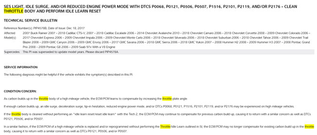

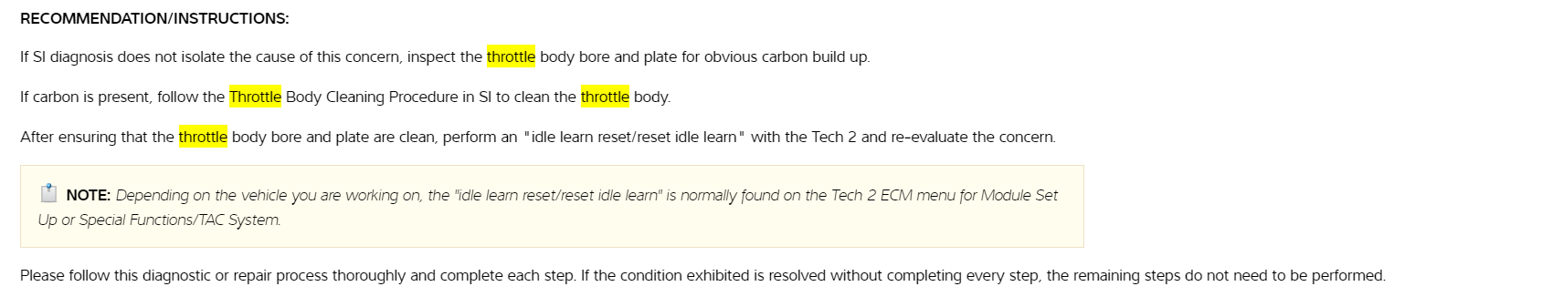

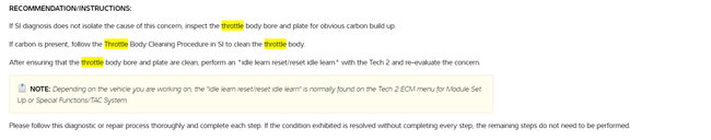

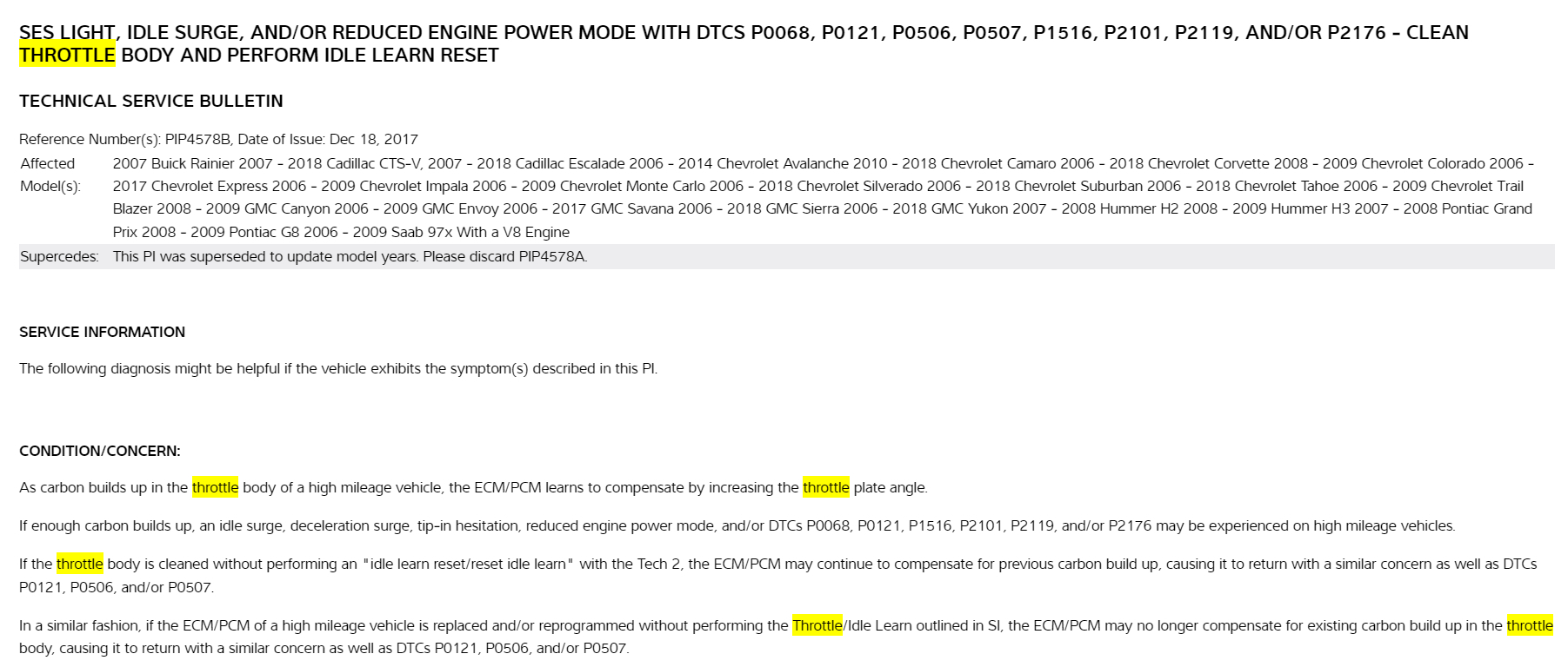

Hello, did you change the throttle body because of codes for it? Is that what was setting the Limp Mode condition? The issue may be that the throttle body needs the throttle angle relearn procedure to occur. Is this a gasoline engine, 1500 series and what is the Sub-model_High Country, LS, LT, LTZ, SSV, WT? pickup crew cab, Extra cab? What were the previous codes that led to the throttle body being changed?
How did you do the KAM reset?

Okay, so you had a leak from the radiator, you repaired that/or replaced the radiator. If the battery went so low that the computer memory was lost, I can see the throttle body having to relearn the throttle plate angle, because these are "drive by wire" systems. And with the old throttle body on there, the computer wouldn't need to deal with a relearn or longer relearn time. I would recommend removing the cold air intake system. I know they claim they're great, but this truck has a Multifunctional Intake Air sensor as well as an Intake air temperature sensor. Those need to be on the Air Intake Tube for correct performance.

As for the Throttle body, the new one will need a throttle relearn procedure. But I would check the battery voltage in the morning before starting it, and also if you have a multimeter I would put it on the battery in the morning, check the voltage level before starting and then watch the meter while cranking over in the morning and write down how low the battery goes at the first crank over in the morning. If it drops below 9volts during cranking, then you might have a battery that's starting to fail.

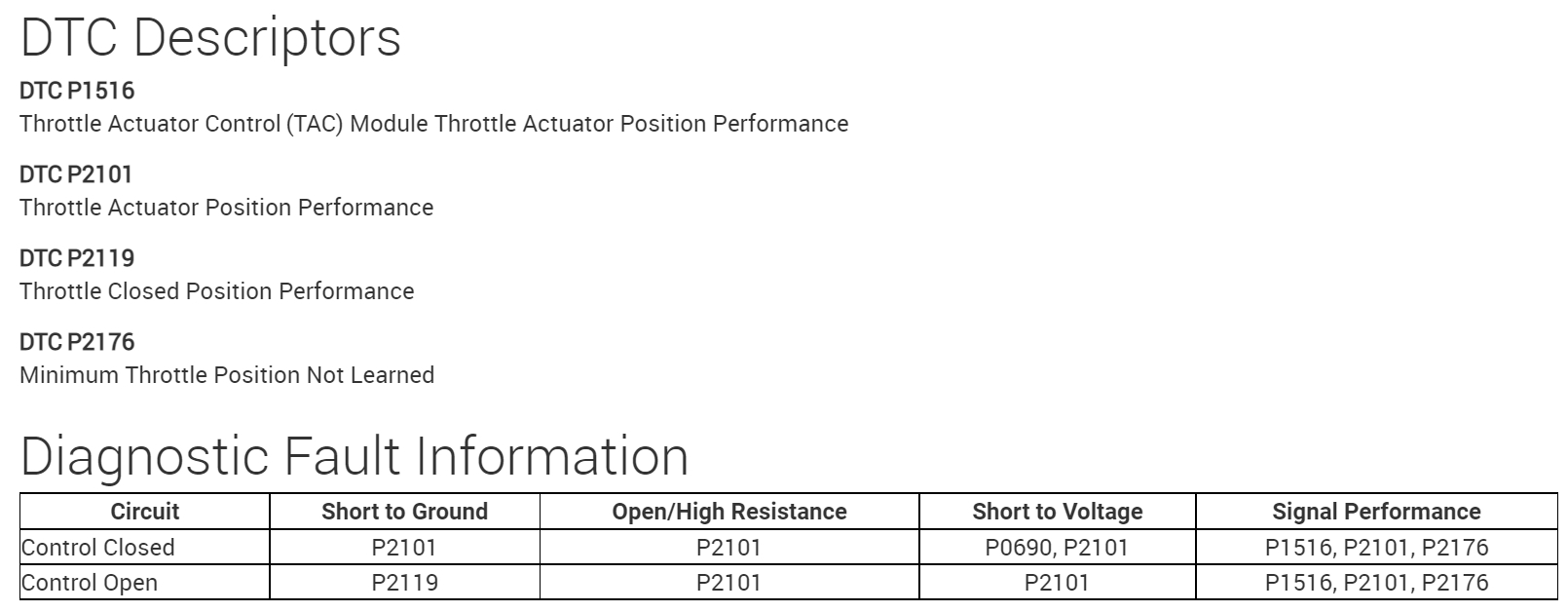

I would also rescan for new codes as well. What exactly was the throttle body code??

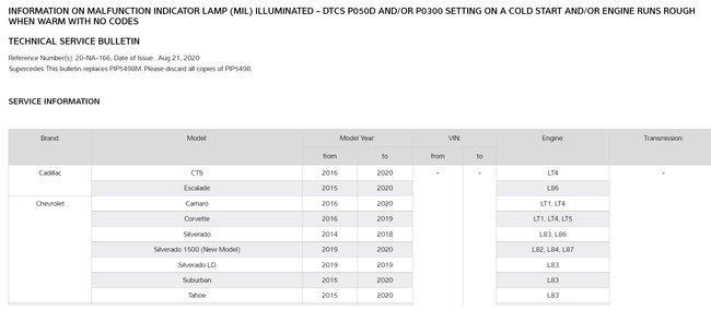

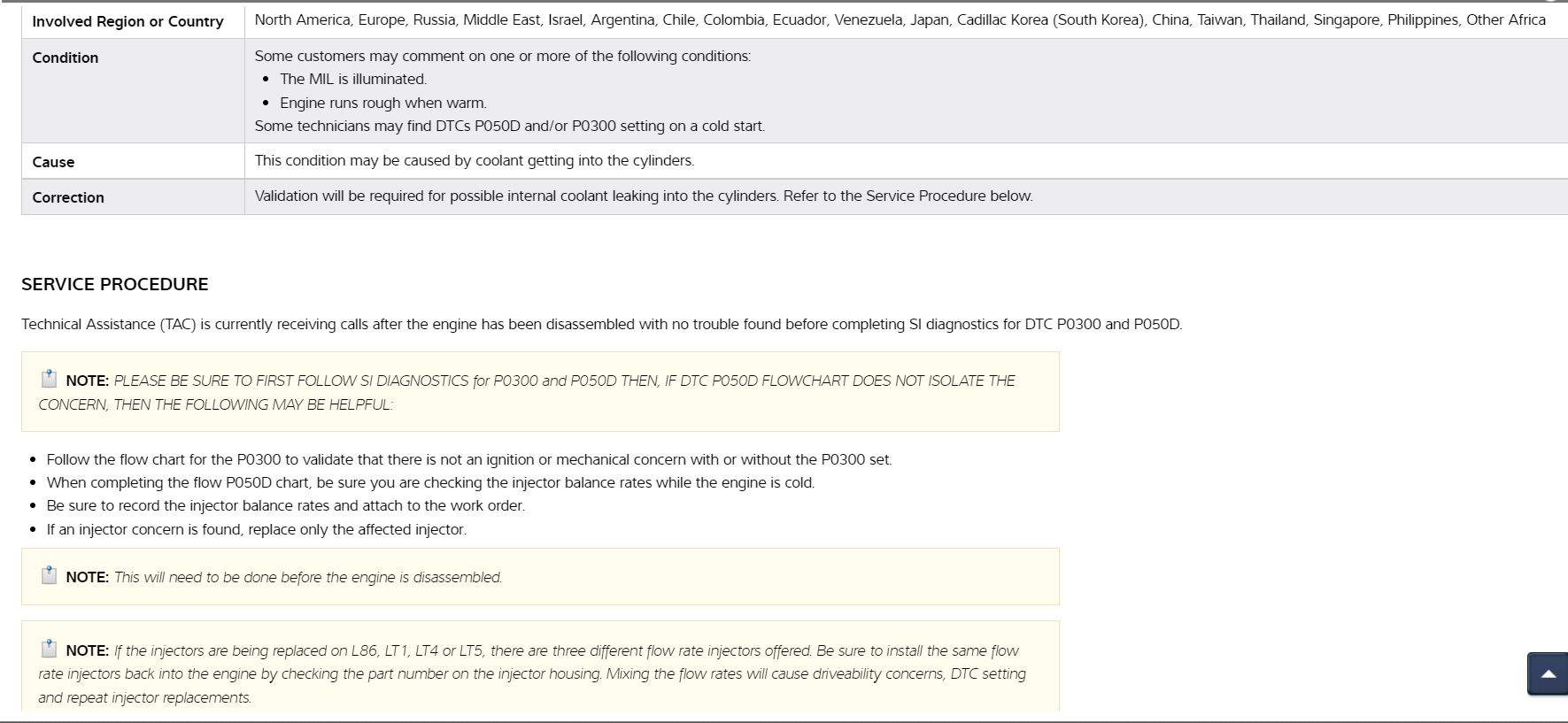

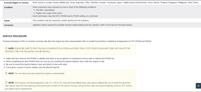

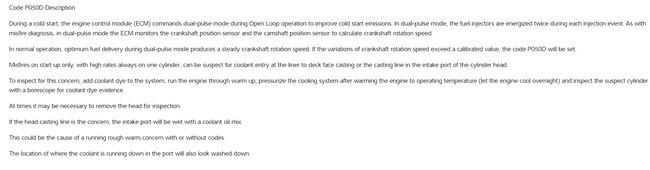

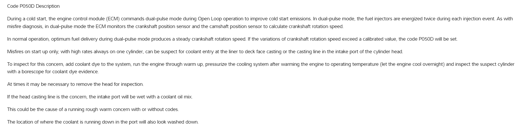

So, if you had an ECM tune, what that can do is cause the fuel injector pulse to be longer than the OEM spec for the truck. And these trucks on cold start up go into a dual-pulse mode, so it's firing the fuel injectors twice at each ignition cycle because a colder vehicle requires more fuel at start up. The manufacturers want to get the truck to operating temperature as fast as possible for emissions reasons. So, the tune could be flooding out the engine, especially if you have ignition coils that are not performing at their peak.
GM does have "clear flood mode" I believe. So, you can try holding the gas pedal to the floor and it should shut down the fuel injectors. This is in case of a flooded-out engine issue. We use this for testing sometimes when we don't want the injectors to fire, but if it's flooding out and the spark plugs are getting wet, try holding the pedal to floor and crank it over.

And can you tell me the codes you go for the throttle body and any other codes? The code numbers specifically.

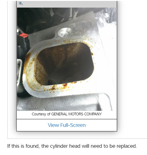

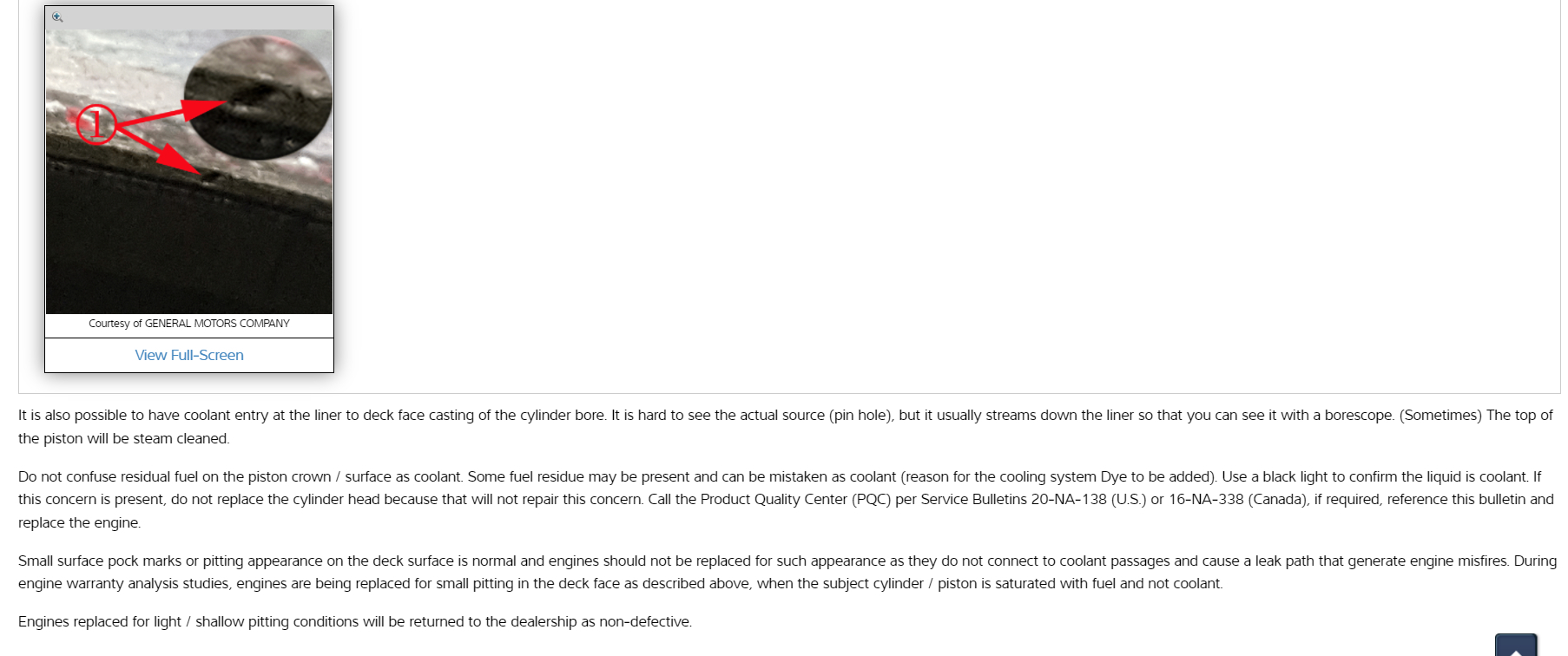

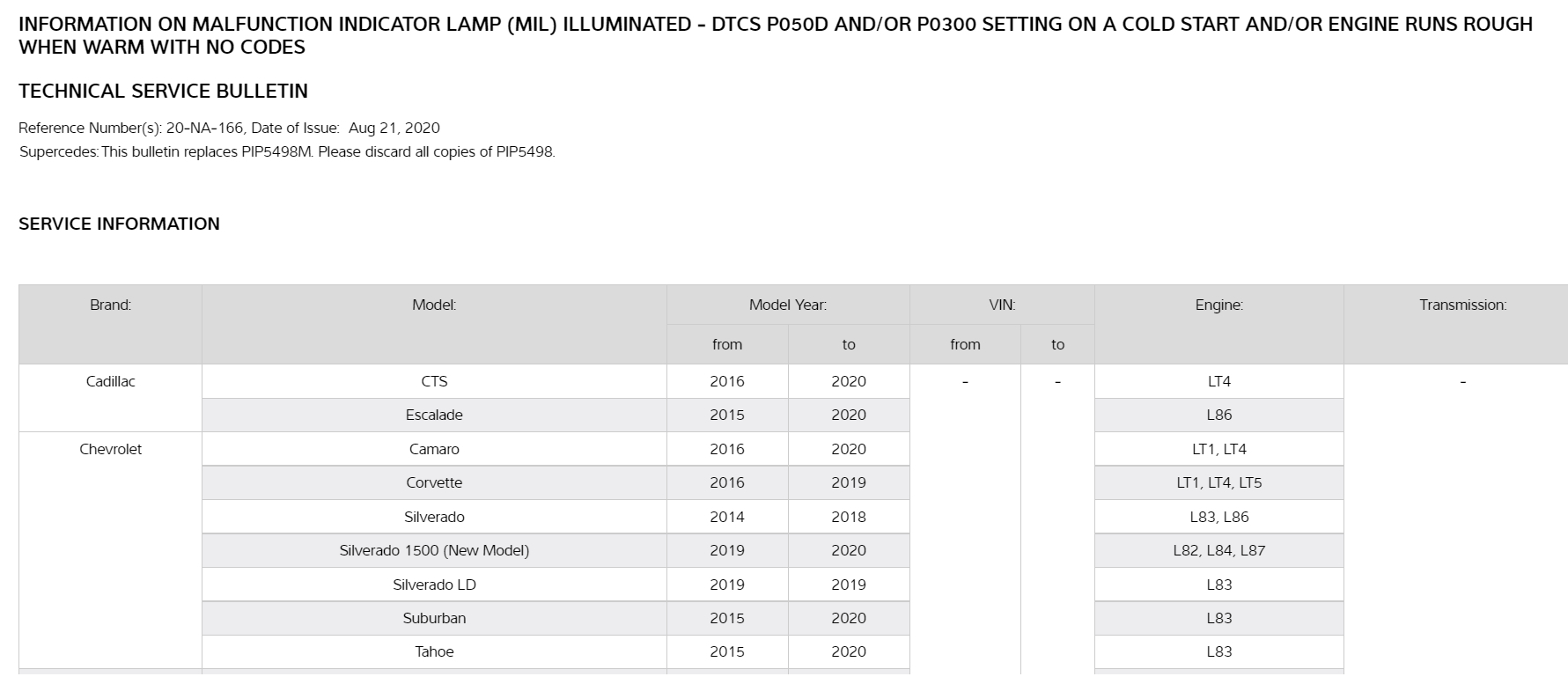

There is also a Technical Service Bulletin on coolant entering the cylinders, I'll post that below.

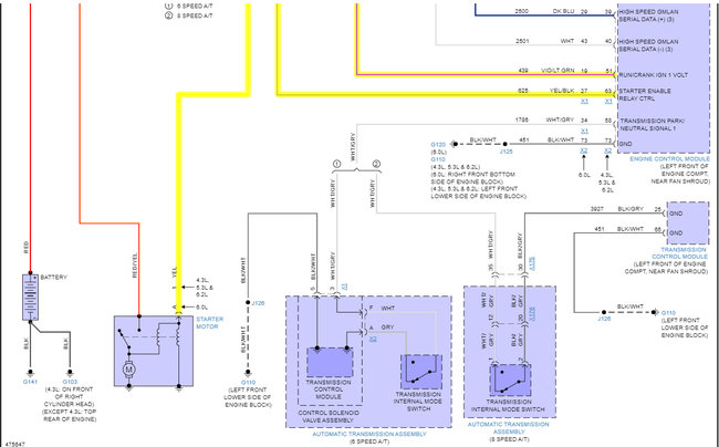

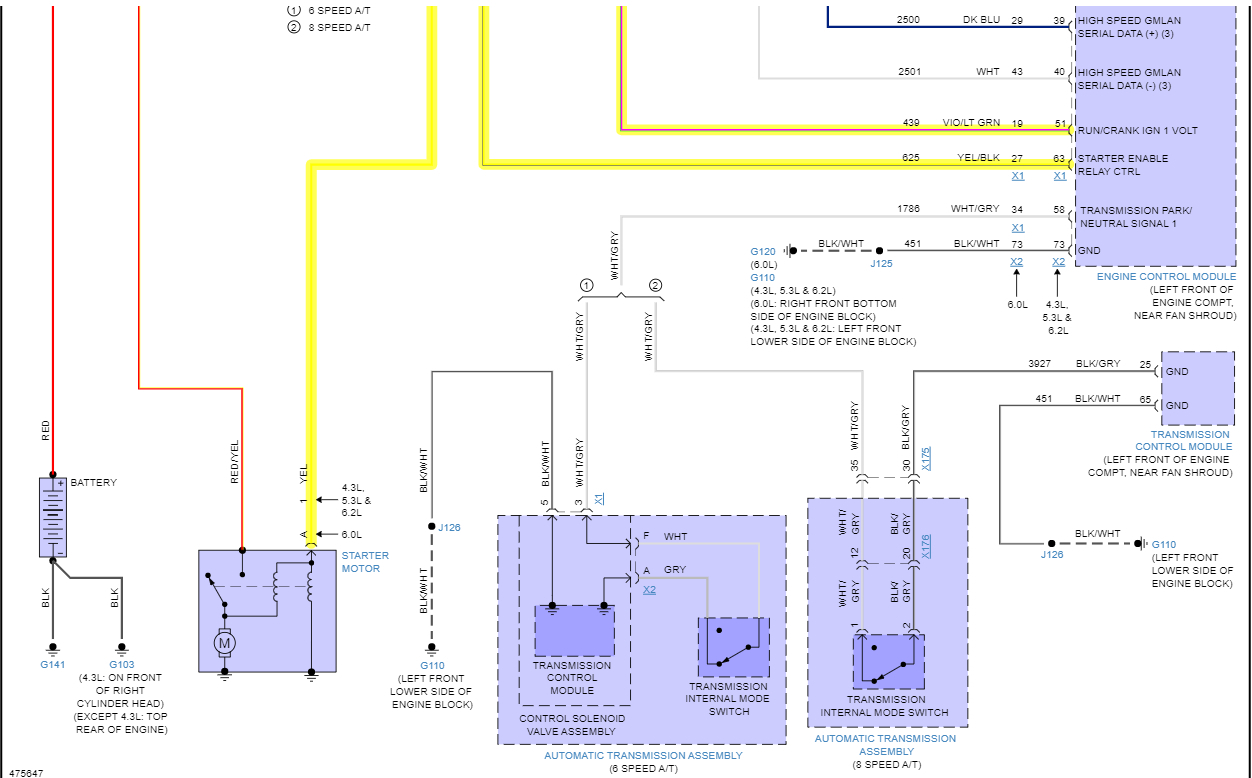

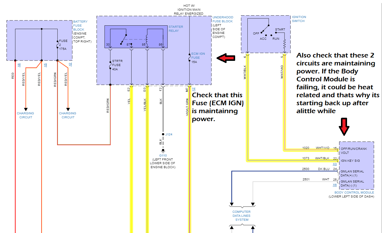

Oh, okay. I must have got the wrong idea; you're saying it won't actually turn the engine over anymore after it stalls out... So, if it is losing power and then won't even turn over, it sounds like it may be a module failing. If a circuit board has a cracked solder joint that's heating up and then cooling down allowing it to crank over again. I'll put the Starter wiring diagrams below, but it can be difficult to track down a failing module because if it is losing communications, as you can see the Body Control Module communicates on a CAN bus to the Engine computer for Starting signals and the engine computer then powers up the Starter Relay.
You can take out the Starter Relay and check the pins for corrosion as well as the underside of the Fuse Block in the engine compartment. When it stalls out and won't turn over again does the Check Engine light come on while the Key is in the On or Crank position? It should last for about 2-3 seconds. If it's not, then the ECM is not powering up and that would also explain why you're not getting any codes. Can you communicate with the ECM with your scan tool?

The thing that's difficult with this truck is that it takes communications between the Body control module and then ECM to even crank the engine over. So, I can see it being inhibited by a lot of different issues.

Do you remember what the throttle body code was exactly? And have you checked the connections at the starter just to make sure there's no loose wires down in that area?
