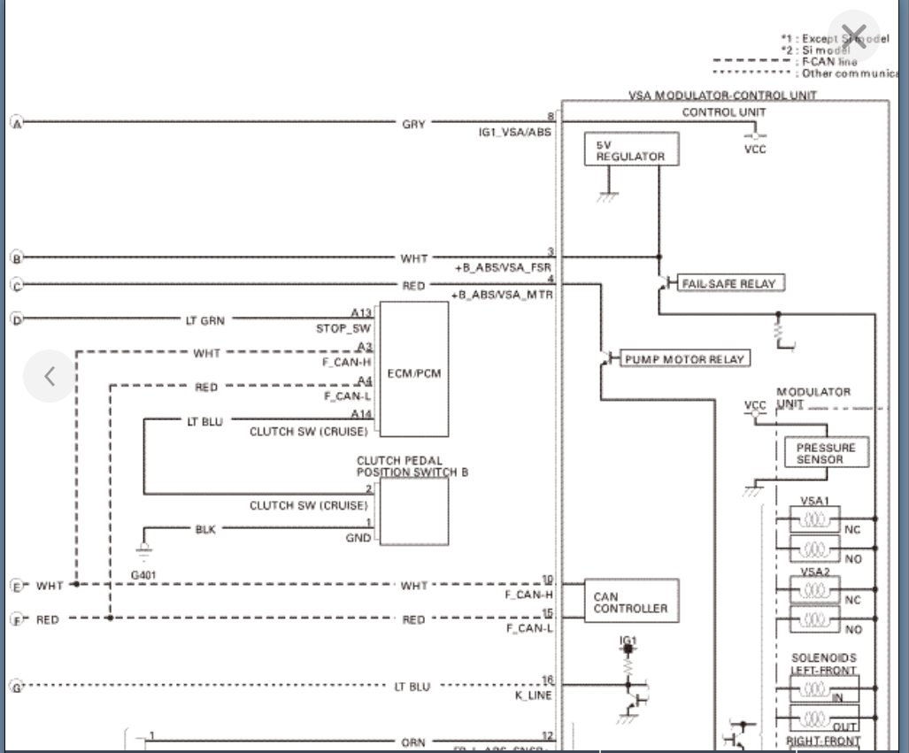

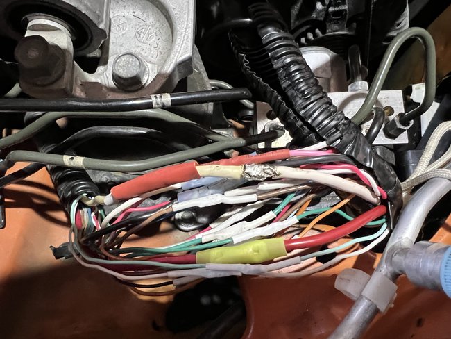

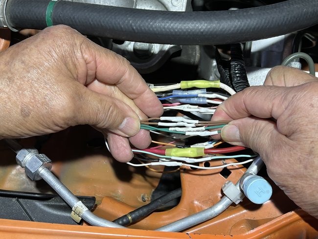

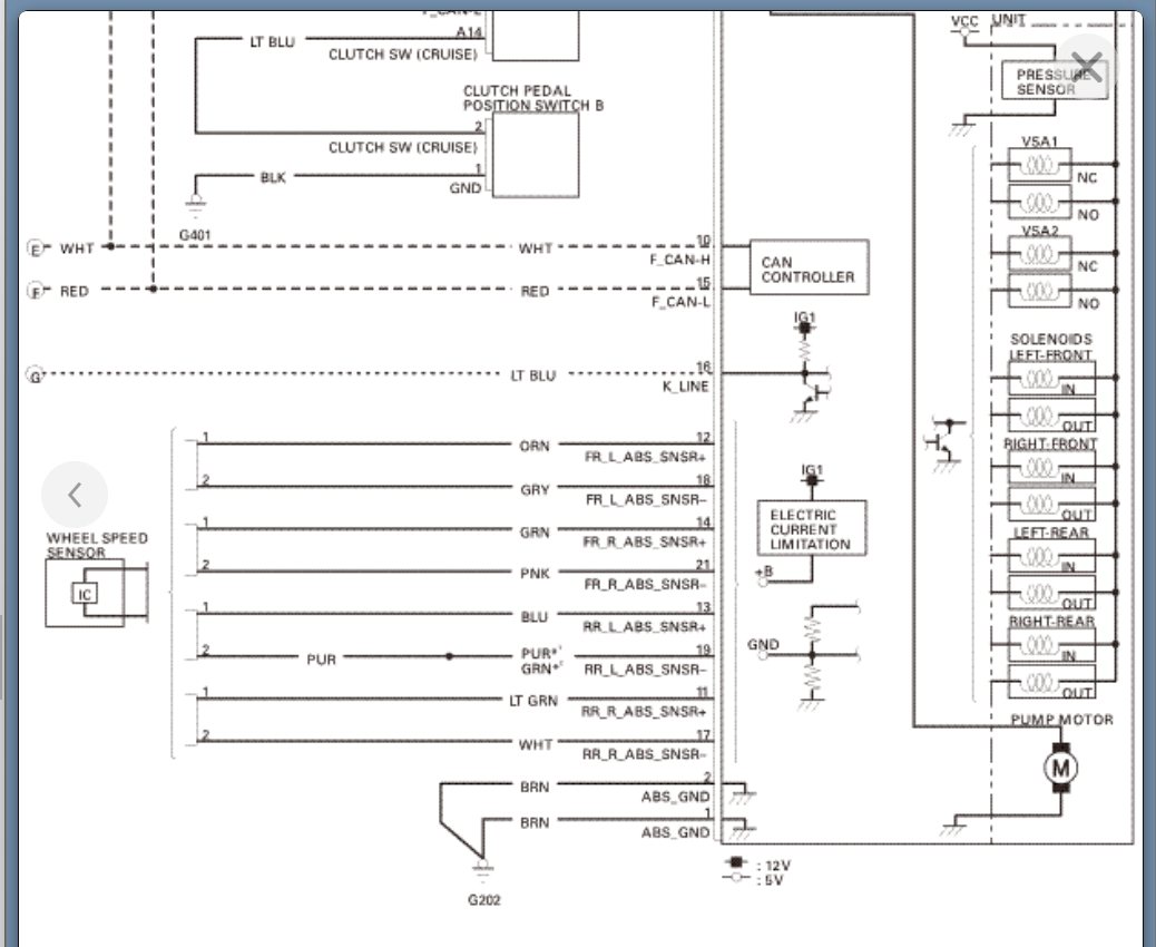

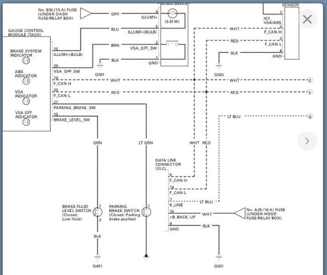

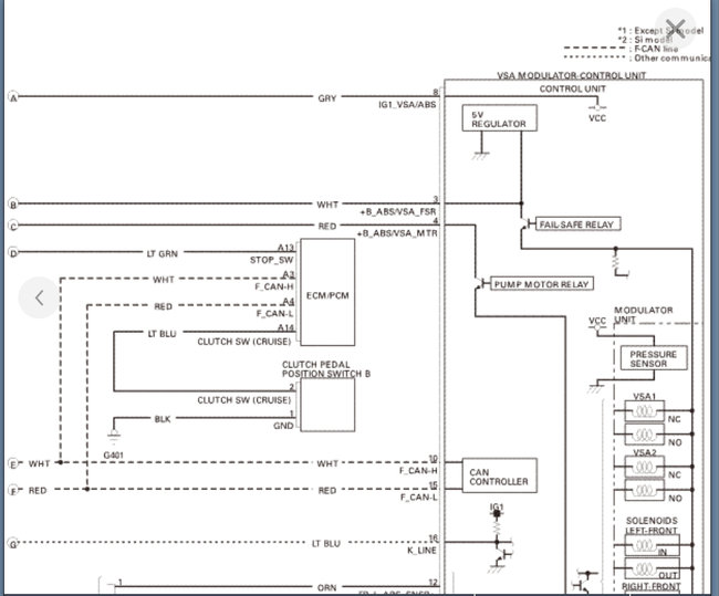

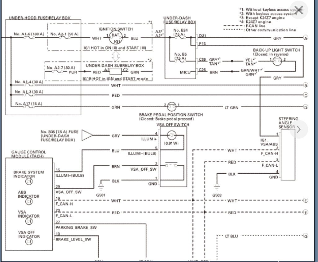

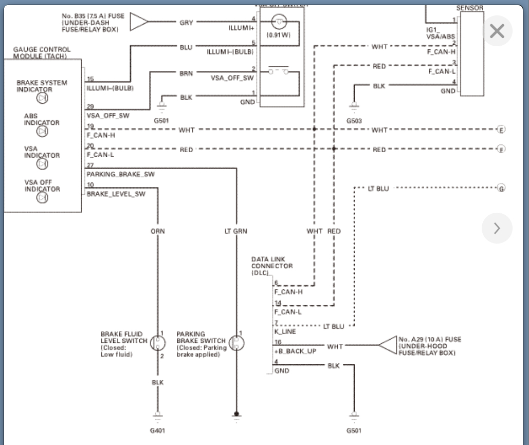

hello there, I'm back I start fixing the wiring as necessary here I want to share some pics there are no numbers on the wires, and I am not sure if there we have crossed wires due to the color are same two brown and two green? I'm not sure if you can help me with the electric diagram, I'm good at reading those diagrams.
Victor
Feb 21, 2022 at 4:40 PM
That is the ABS connector? If so, then the only way to know is to trace the wire to find out where it goes into the ABS and then that will tell us what terminal it is in. Then we can go to that component and disconnect it and check continuity from that pin to the other end and that will tell us if it is wired correctly.
The brown wires may be ground so if that is the case then it doesn't matter if they are backwards. However, the green could be a wheel speed or the stop switch.
Did we ever check for codes? If you have some circuit codes, then that will tell us where to start.

Well, I finished soldering all wires and found out two were wrong but still getting the VSA and TPMS warning lights on the TPMS I can reset using the steering tool but immediately came back. I am not sure if the wiring harness that was used after the accident and someone cut out and reconnected the ABS are the same the one came with the vehicle have the number RXA-32110-RX0-A003-A and the new one 32200-TR7-A024. I called the dealership but for me, they are not giving the right one. thanks for your time and attention regarding this mess.
Victor
Mar 8, 2022 at 1:19 PM
Looks like this number 32200-TR7-A024I is a replacement for a 4 door SI with a 2.4L manual transmission.
Is your vehicle a 4 door SI?
If not, then that may help explain what is happening. They may have just found this harness out of another vehicle, and they tried to make it work.
I scanned through this and didn't find any mention of any codes. I think it was because you couldn't communicate with the ABS? Are you still not getting any codes?
