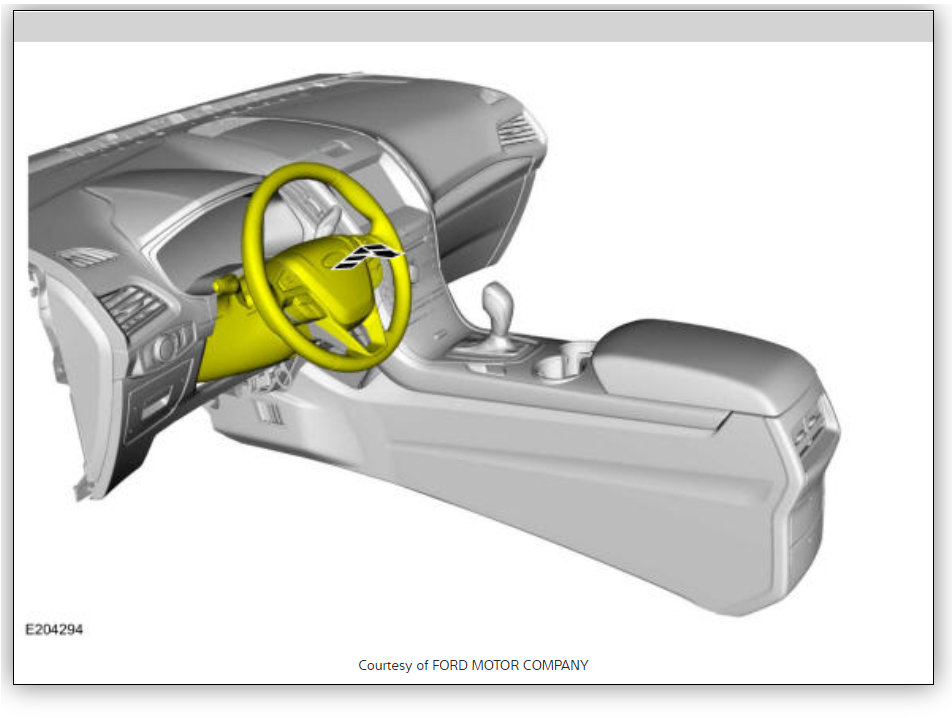

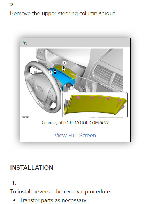

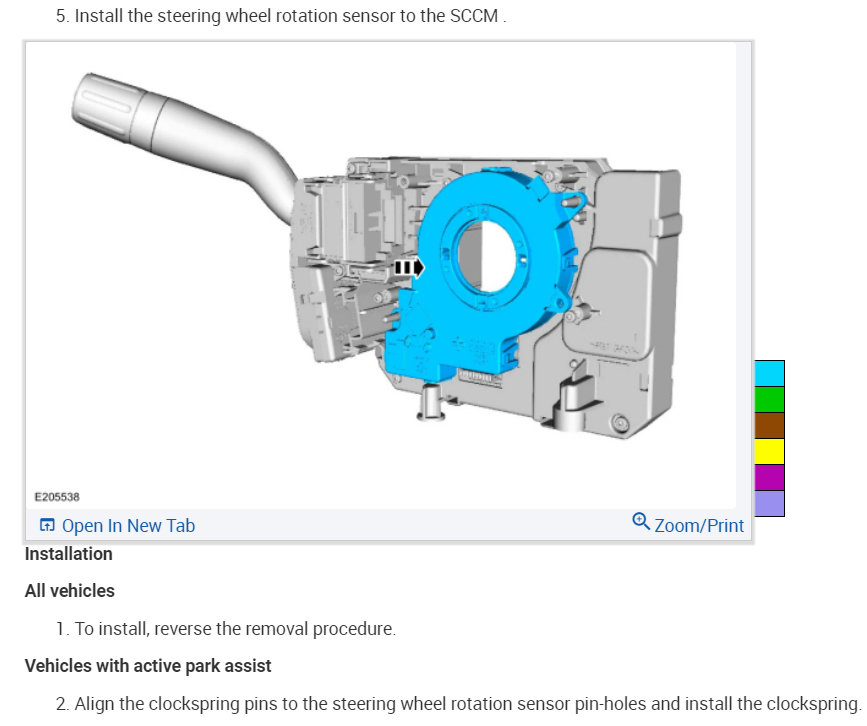

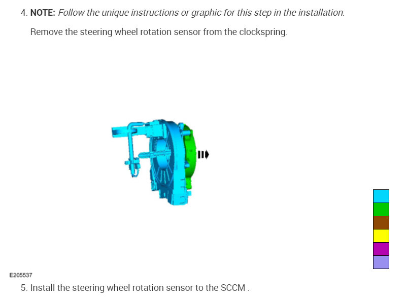

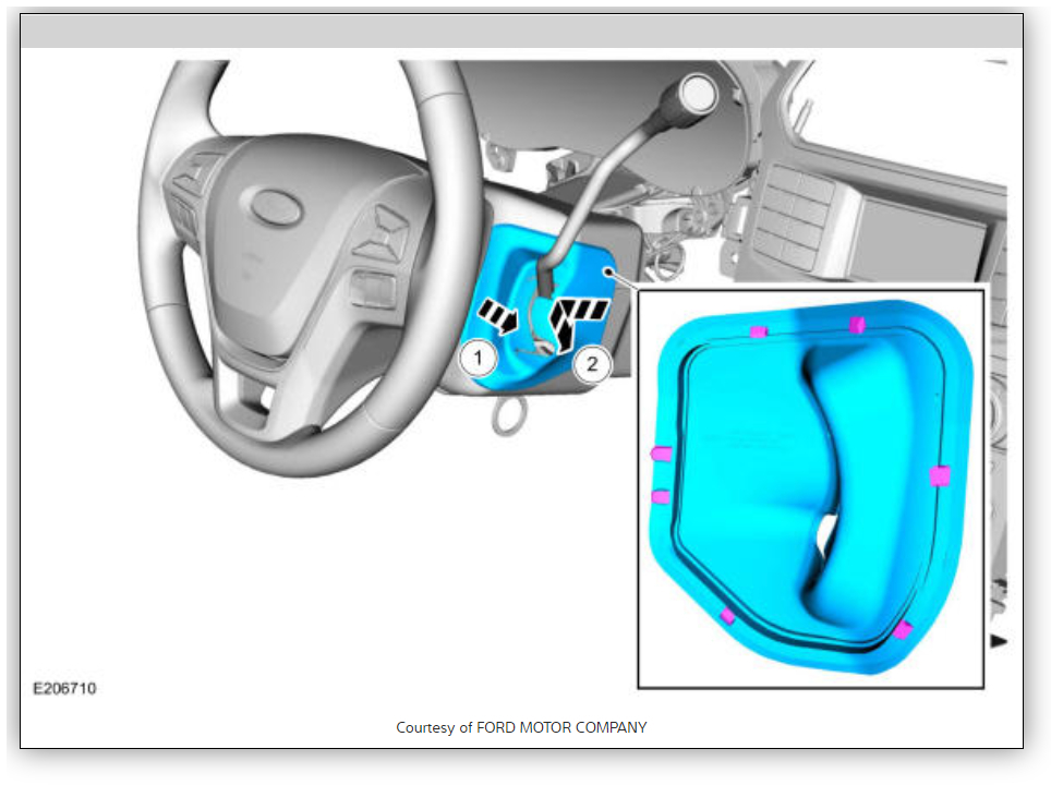

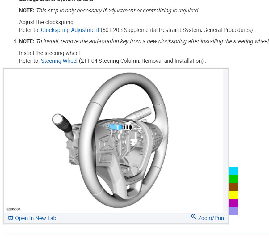

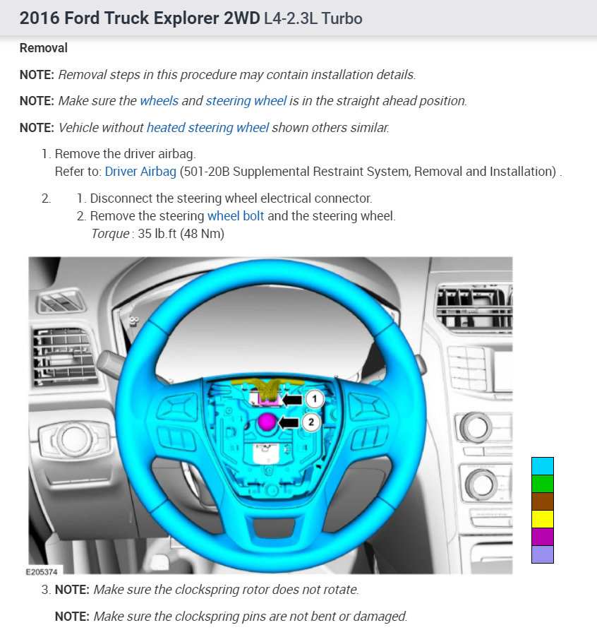

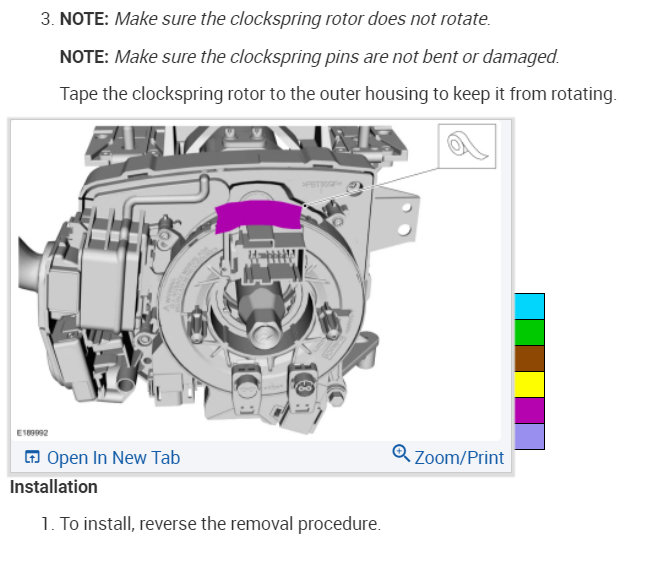

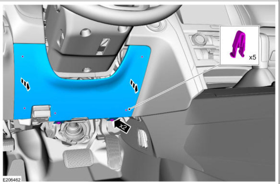

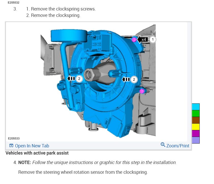

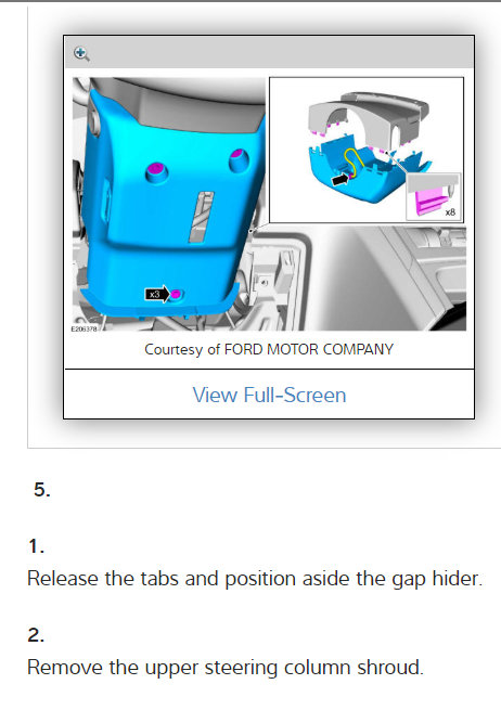

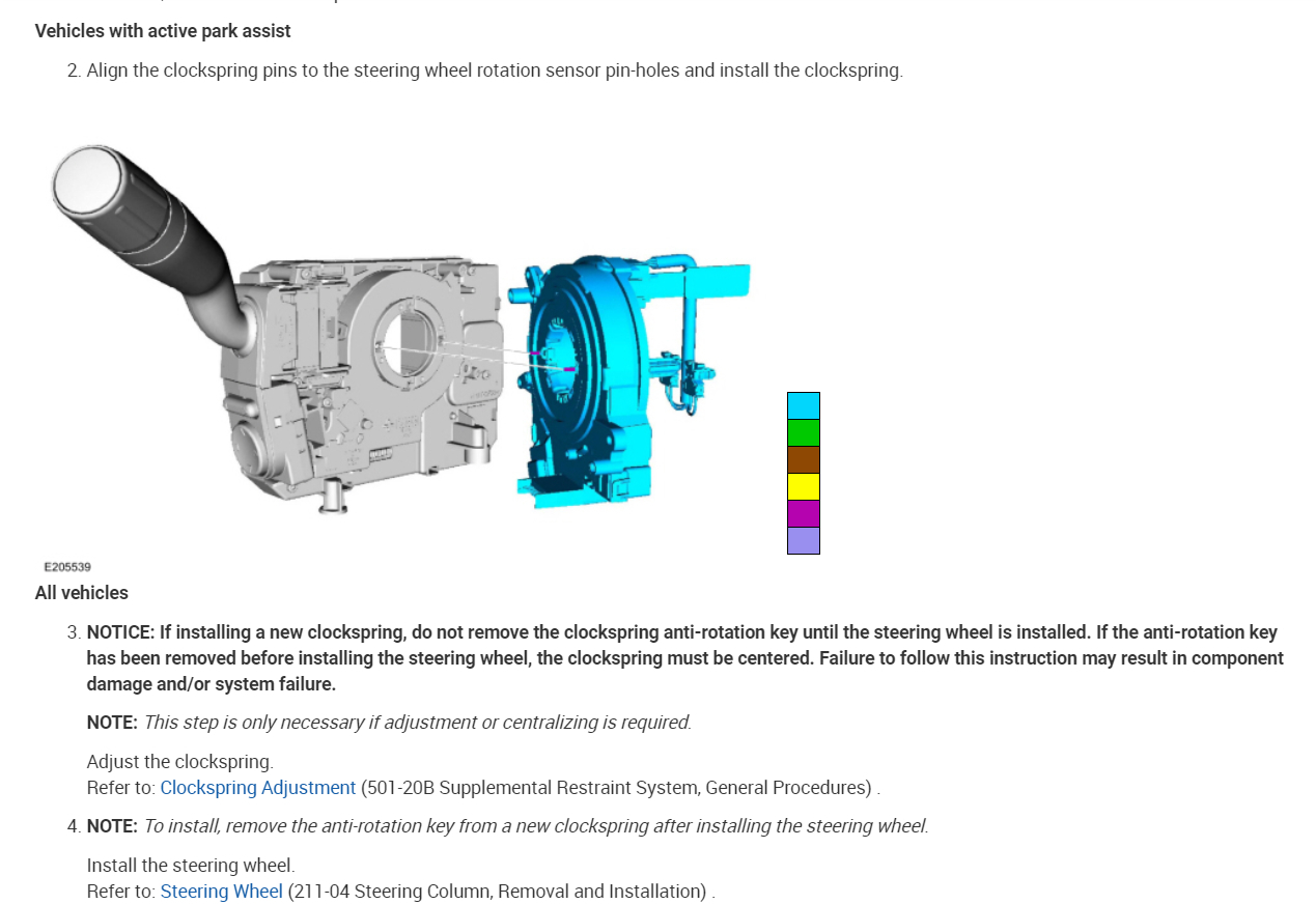

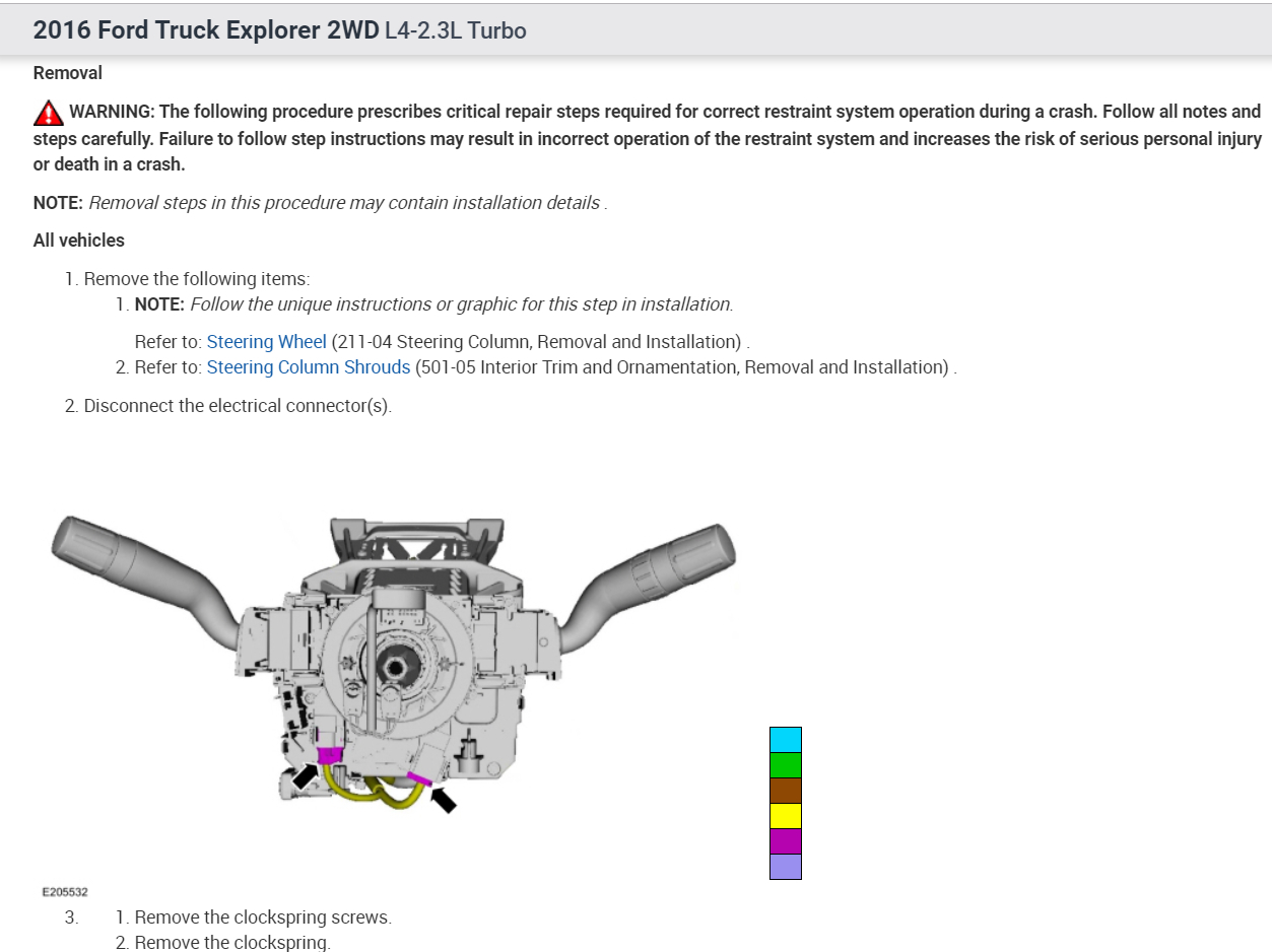

If I can jump in here. I have seen the clock spring behind the steering wheel cause this, but to be sure we need to scan the CAN which you can do with a scanner from Amazon for about $50.00. here is a video to show you how:
https://youtu.be/InIlnsjOVFA
Here is how you change out the clock spring in case my hunch is correct. Check out the diagrams (below). Please let us know what you find. We are interested to see what it is.

Not to ruffle feathers, but I deal with these every single day and if it were a clock spring or a CAN network issue the system would not engage at all,at any time,never, nada, zilch. And if it the sensor was out of alignment it actually will work for a period of time because I've had to align and re-calibrate dozens of them after they came from the body shop. Retrieve the codes from the CCM and we can go from there.
Sep 27, 2019 at 2:25 PM
  • 55,423 POSTS
Good input, my though was an intermittent short in the spring. Be good to find out for sure.
