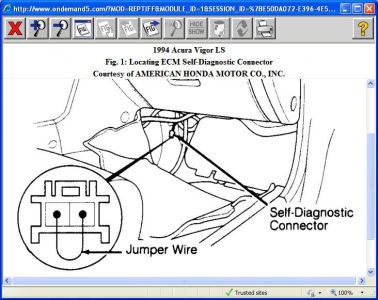

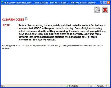

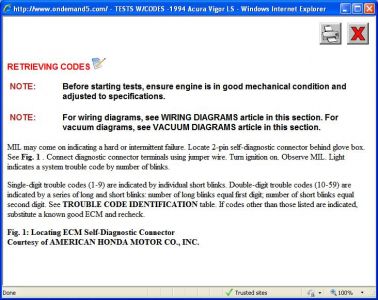

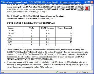

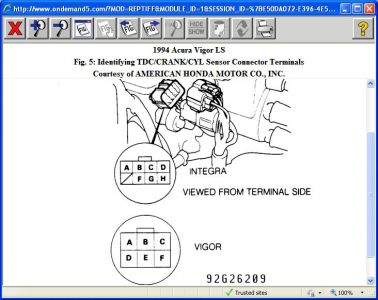

What are the differant causes of a code 4, ( angle position sensor) on this 5 cyl. engine? I'm thinking of replacing roter, cap and plug wires. Car runs fine. Could code still be on from when I ran thru a puddle and engine lite came on? How can I reset it ? I've driven about 300 miles and code is still there. Also disco'd bat. for 1 hour. Angle of distributor/position sensor can't be changed on this engine, so I assume cose may be for rotor/cap getting worn? What else?

First of all thank you so much for your donation.I posted the trouble tree for your code 4 and also retriving and clearing code's.Let me know what you find.
