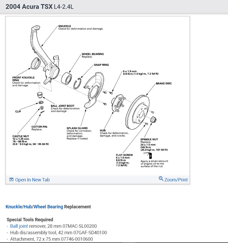

I replace angle sensor 2 time replace ABS modulator still I have my car VSA light is on.I check any broken wire but there is no broken wire. When I replace modulator It was every things OK. Couple time I went for test drive suddenly VSA light on. Please if you have solution please help. Thank you.

Hi Mohammad,
It sounds like you have a bearing hub that is out causing the Wheel speed sensor no to read right here is a video to help get the codes so you can confirm which side it ie, I would do both though fyi.
https://youtu.be/rTtAnsOlZU4
This guide will walk you through the repair with diagrams below to show you how on your car.
https://youtu.be/_FzmmBoa4Tg
Thursday, August 26th, 2010 AT 8:38 AM
ZANYJB
Hi thanks for this post the bearing was okay on my car but the right front wheel speed sensor stopped working so I got a new one for $67.00 all fixed!
