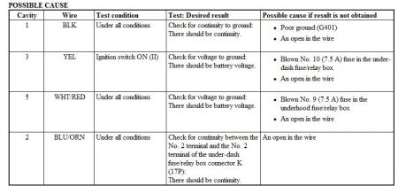

2004 Acura RSX TYP S. MY two keyless entry fob's won't open or close the doors anymore. The system works fine using the keys or the master door lock switch. Replaced the batteries in the fob's and reprogrammed the transmitters, still not working. Fuse is OK. Does anybody have any idea how I can fix it?

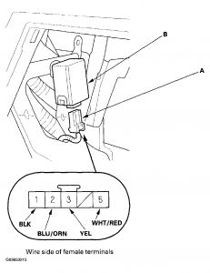

Keyless Receiver Unit Input Test
Remove the audio unit (see AUDIO UNIT REMOVAL/INSTALLATION ).
Disconnect the 5P connector (A) from the keyless receiver unit (B).
Fig. 5: Disconnecting 5P Connector From Keyless Receiver Unit
https://www.2carpros.com/forum/automotive_pictures/266999_rsx2_1.jpg
Inspect the connector and socket terminals to be sure they are all making good contact.
If the terminals are bent, loose or corroded, repair them as necessary, and recheck the system.
If the terminals are OK, go to step 4.
With the connector still disconnected, make these input tests at the connector.
If any test indicates a problem, find and correct the cause, then recheck the system.
If all the input tests prove OK, replace the keyless receiver unit.
