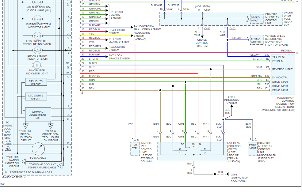

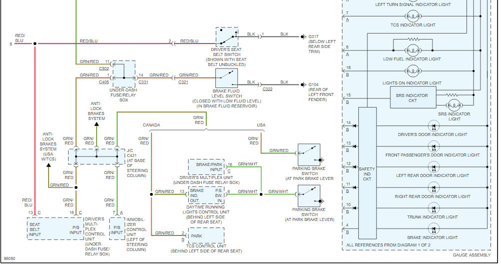

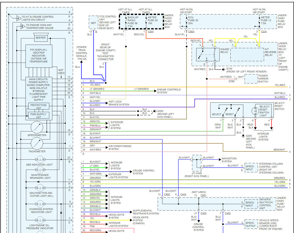

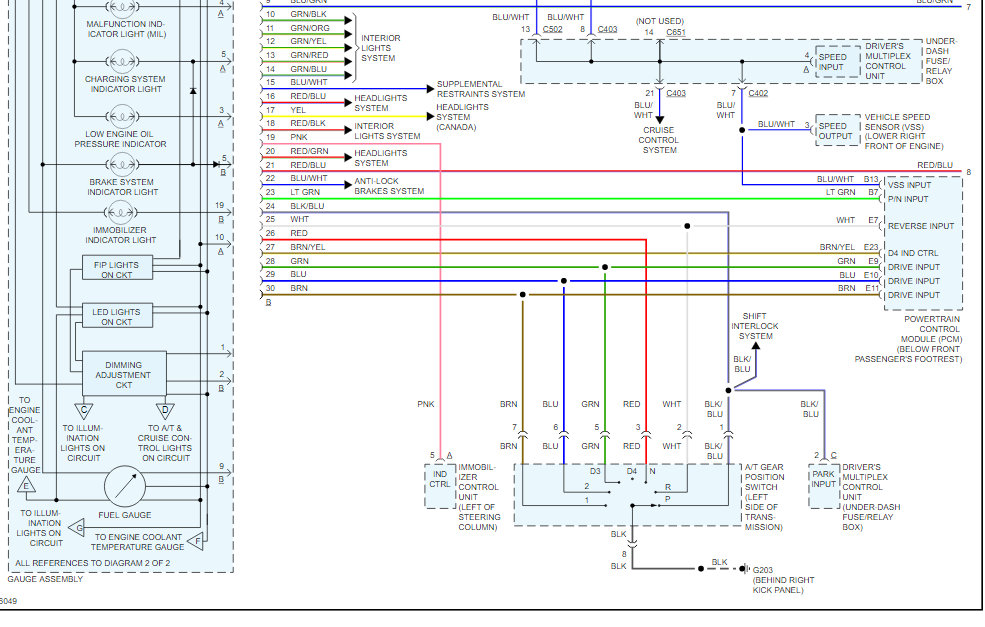

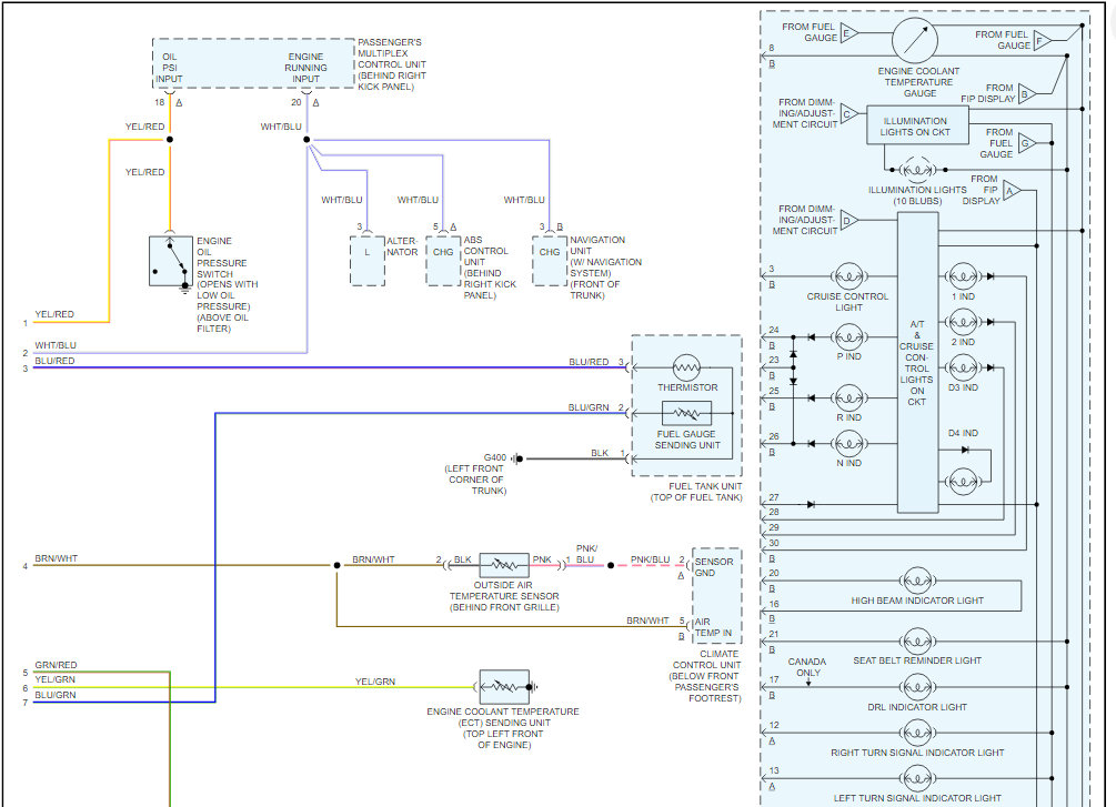

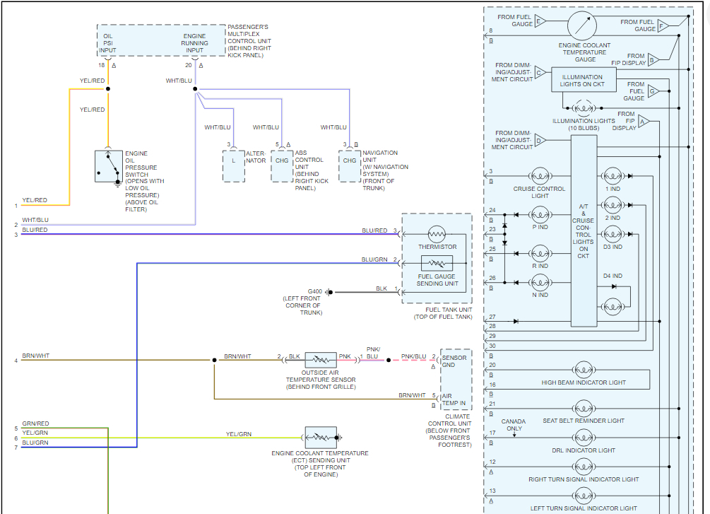

The smoke suggest that you could have burnt wiring for the gauge cluster.
In order to find the issue you will have to trace the wiring harness for the gauge cluster.
You will need to use a multimeter to be able to do this task.
Here is a helpful article on how to test wiring:
Look below for wiring schematics.
