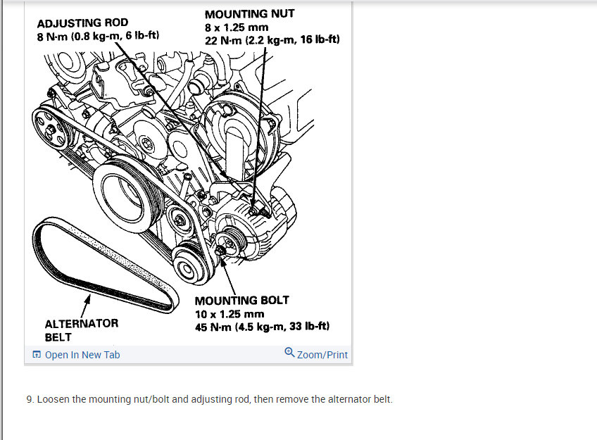

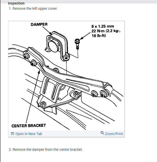

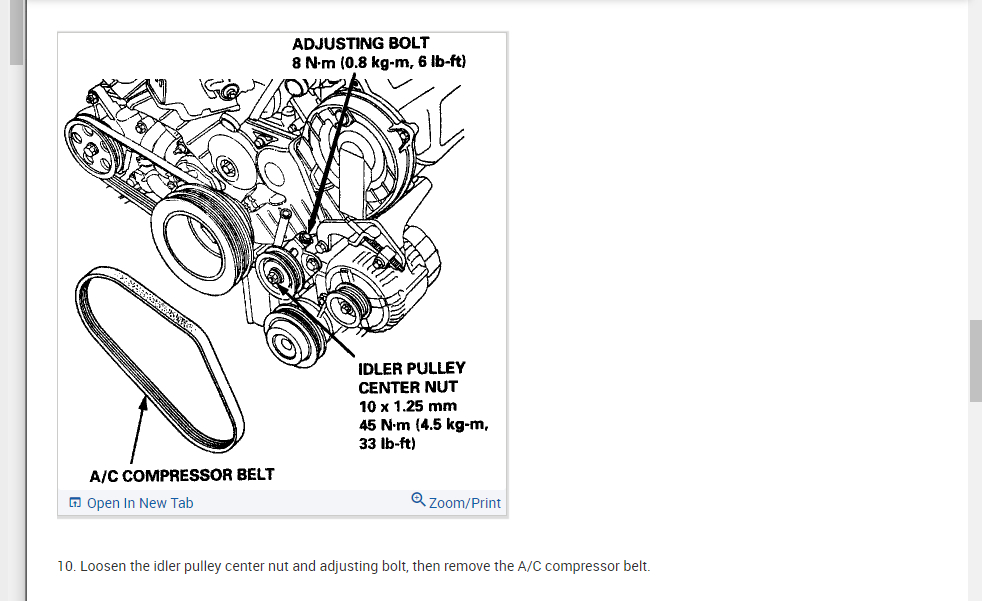

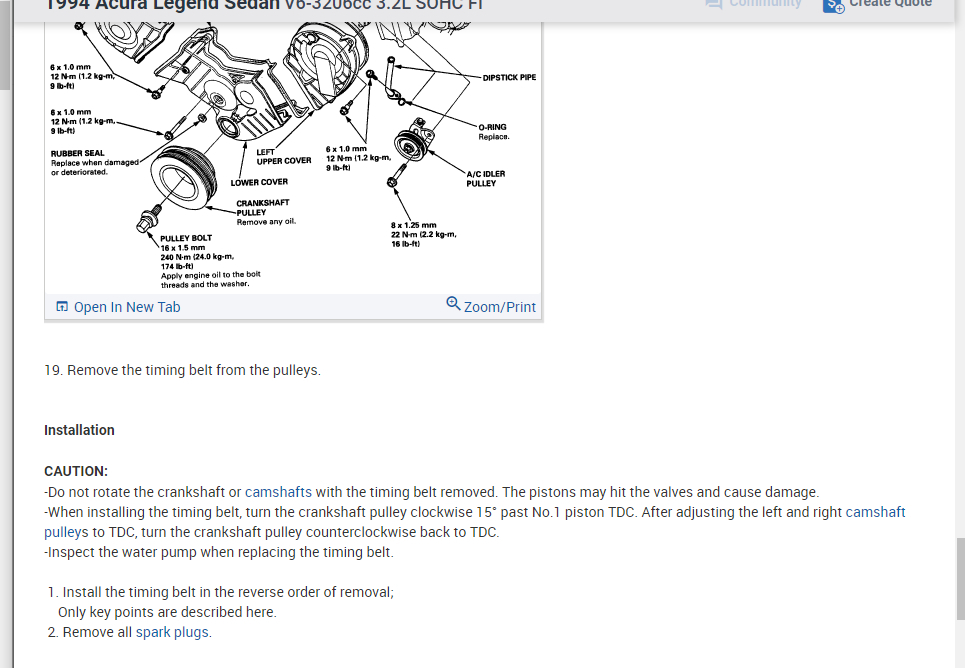

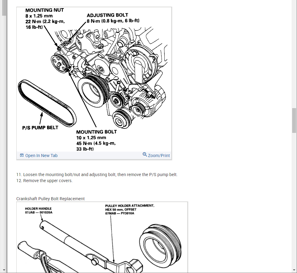

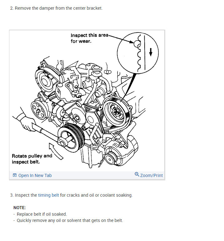

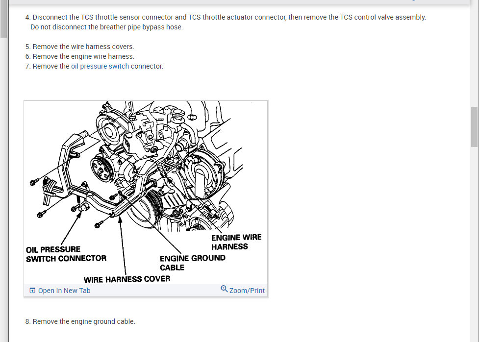

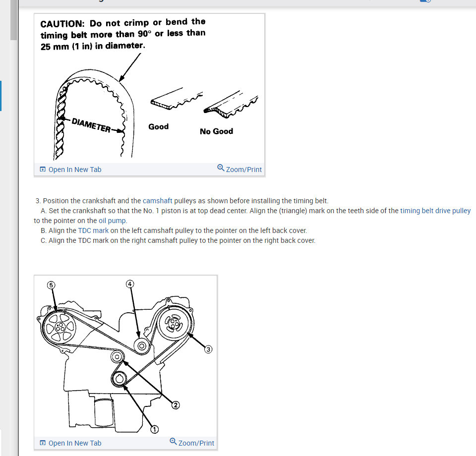

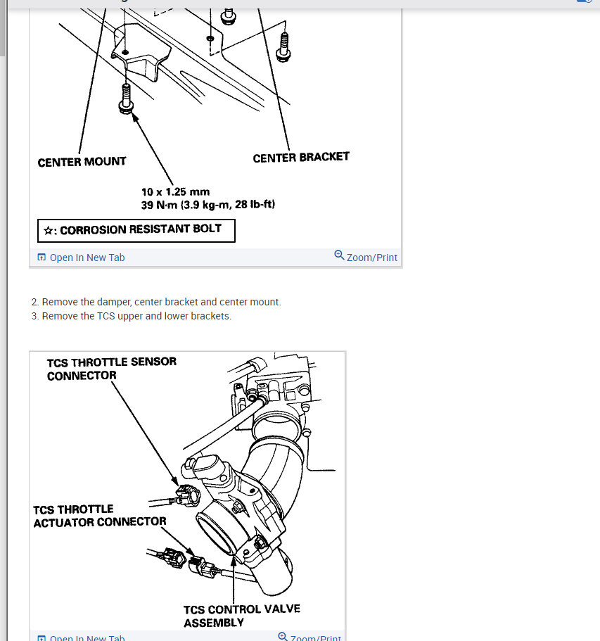

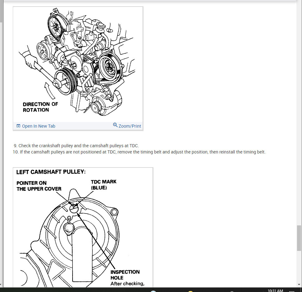

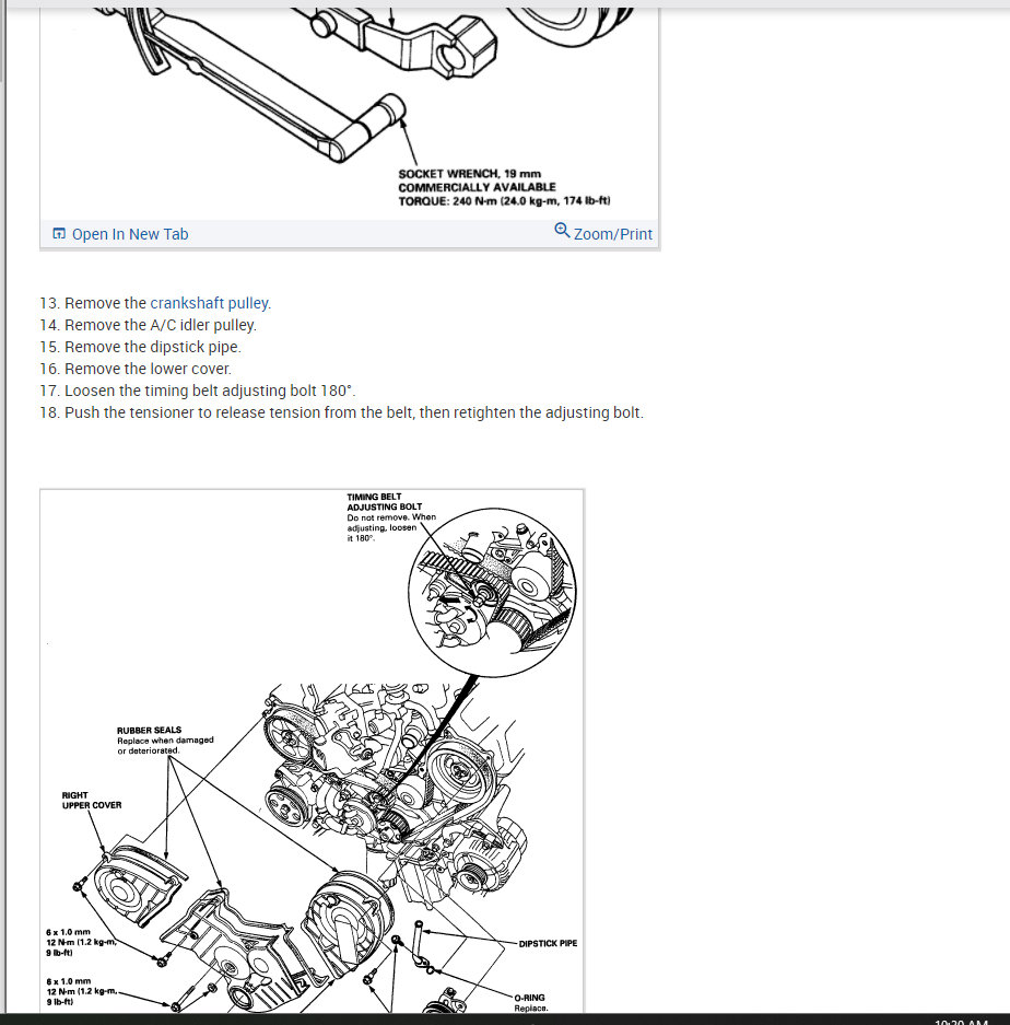

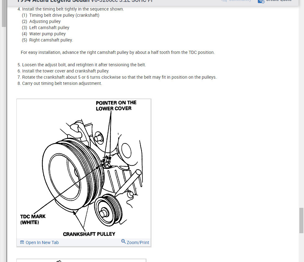

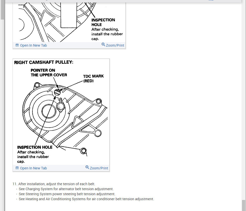

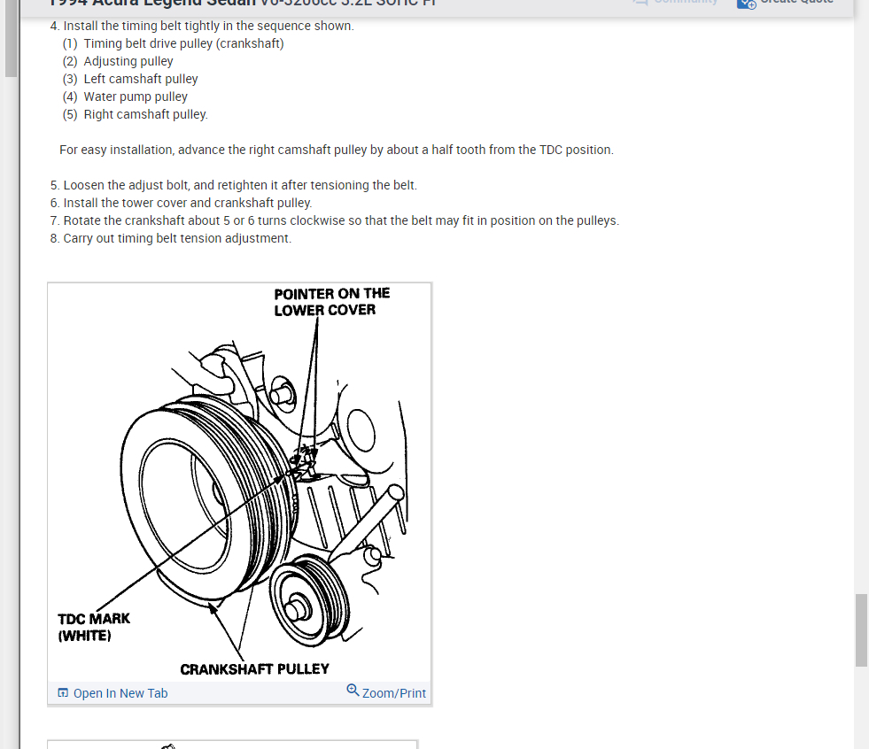

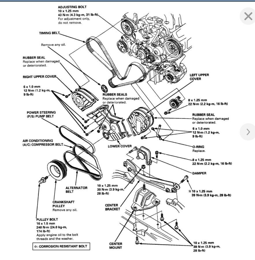

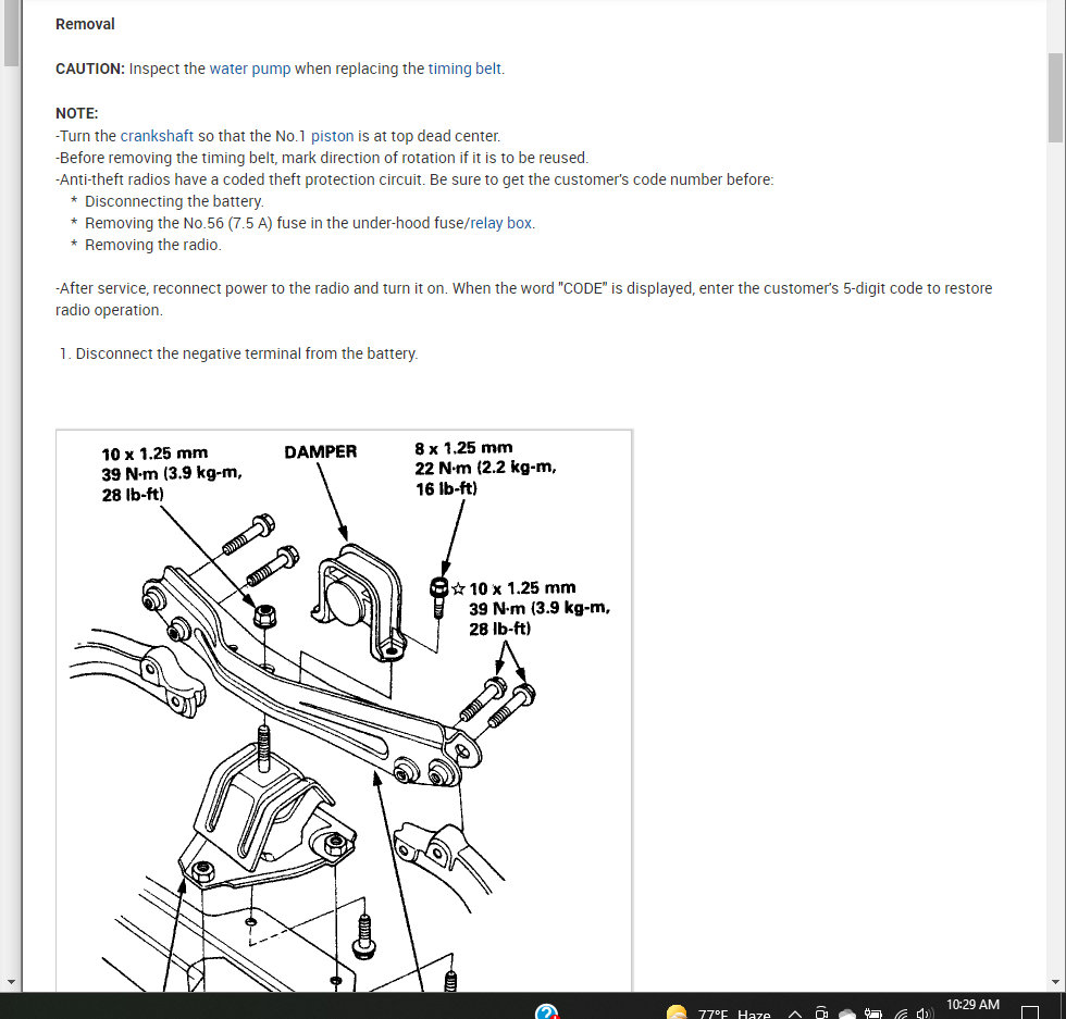

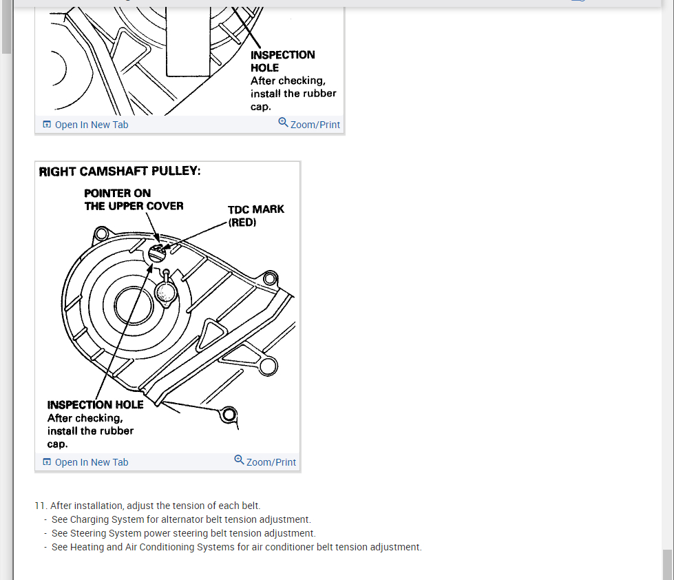

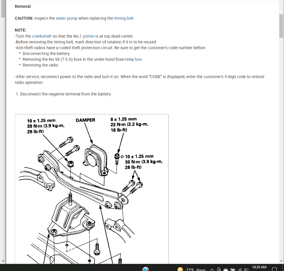

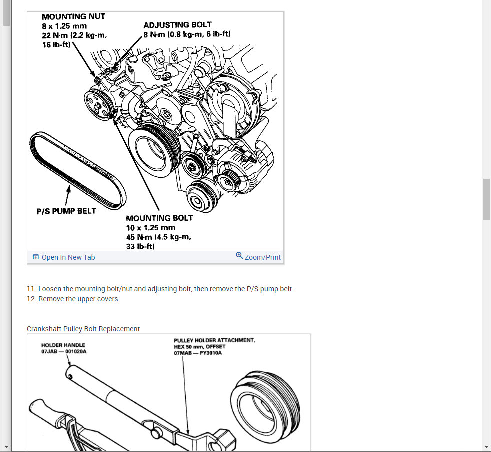

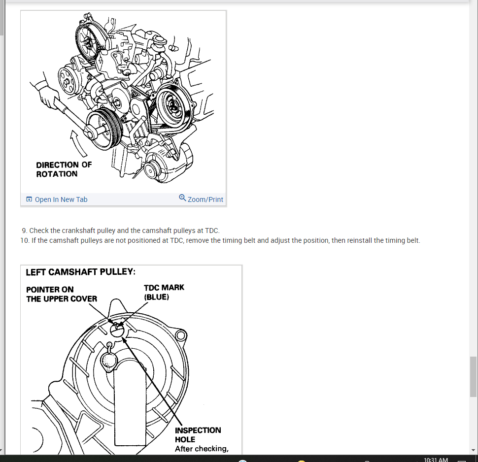

Just to jump in on this, the engine is an interference engine so the belt needs to be changed but they have you inspect it and when it starts to wear is when you replace it.
Here is a guide that will help with this topic:
https://www.2carpros.com/articles/how-a-timing-belt-works
I am attaching the info below from the manual that will help with doing this.
Please run through this info and let us know if you have other questions. Thanks
