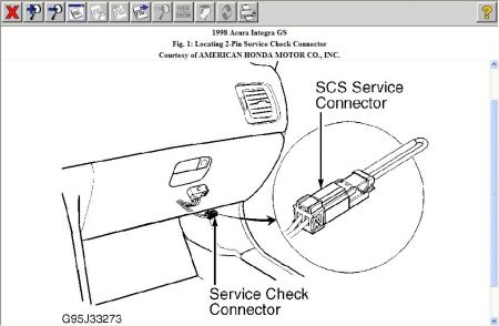

Hi, To reset the PCM you only need to remove the BACKUP (RADIO) (7.5 A) fuse under hood for more than 10 seconds. DTC P0420: CATALYST SYSTEM EFFICIENCY BELOW THRESHOLD NOTE: If DTC P0136, P0139 and/or P0141 is set, trouble shoot those DTCs before proceeding. 1. Perform PCM reset procedure. Start engine and run at 3000 RPM with transmission in Park or Neutral, until radiator fan comes on. Allow engine to idle. Connect SCS service connector. See Fig. 1 . Test drive vehicle at 40-55 MPH for about 2 minutes. Decelerate for at least 3 seconds with throttle fully closed. Reduce vehicle speed and hold at 35 MPH until readiness code comes on. If DTC P0420 resets, go to next step. If DTC P0420 does not reset, problem is intermittent. System is functioning properly at this time. 2. Inspect Three-Way Catalytic Converter (TWC) for plugging, melting, cracking, exhaust system leaks or TWC deterioration. Repair or replace as necessary.
https://images.2carpros.com/forum/automotive_pictures/192750_SCS99AcuraIntegra_1.jpg
Page 1 of 1 TESTS W/CODES -1998 Acura Integra GS 9/18/2008
