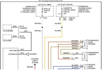

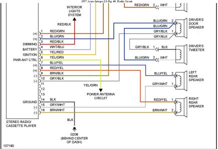

I own a 1997 Acura Integra LS and I have been recently been having some problems with my aftermarket car radio, it tends to short out frequently or makes contact with my interior clock on the dash board, I would like to troubleshoot this but I can't seem to find any electrical diagrams for the car. I would greatly appreciate any advice
Apr 23, 2010 at 6:45 AM
KHLOW2008
  • 41,814 POSTS
Hi palx5060, Hope the diagrams helps.
