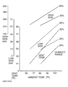

Could you tell me what the low and high pressure reading should be for this car with the a/c running?

The actual pressure depends on the temp. See diagram.
