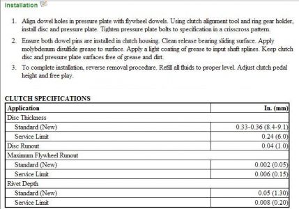

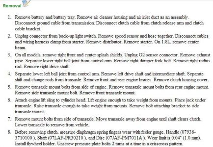

How do I go about putting in the clutch into the transmission
Thursday, January 28th, 2010 AT 7:09 PM
BLUELIGHTNIN6
MECHANIC
16,542 POSTS
Thursday, January 28th, 2010 AT 11:48 PM
