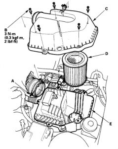

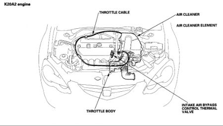

Hello, I have two questions: 1) how do I access the engine air filter compartment, there does not seem to be any clips

Hello, Unless my book is wrong, for 2004, Acura I show models, 3.5RL, NSX, RSX, TL, and TSX. I don't show an EL model. The only models with 4 cyl are the RSX and TSX. The information I am giving you is for the RSX. Hope this helps. For the Engine Air filter 1. Remove the clamp (A) and the screws (B), then open the air cleaner housing cover (C). 2. Remove the air cleaner (D) from the air cleaner housing (E). 3. Install the parts in the reverse order of removal.
