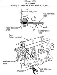

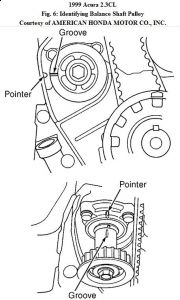

1999 Acura CL 4 cyl Automatic 225,00 miles
my father has been working on my car, and he was replacing my timing belt until he did not realise the diagram of how it is setup . he said he replaced the main belt but the "smaller belt" to be replaced is comfusing to him. may i get a diagram or can u explain how this works please?
Aug 15, 2009 at 11:11 PM
KHLOW2008
  • 41,814 POSTS
Hi zeenab528, When main timing belt is correctly installed, the balancer shaft shoud be aligned according to the diagrams.
