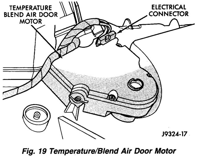

I've got the vehicle listed above (Laredo). My air conditioning won't blow cold through the vents, only hot air. My brother owned it and he messed up both the flap doors underneath but he laid in the pass side floor and took a coat hanger stretched out and went up toward the middle and hooked to something and it took him about twenty minutes to finally hook to something and the A/C worked good but hanger came loose and he's passed away and don't know what he hooked to that far up to make the hot air quit blowing through vents and cold air come through. Anybody know what he hooked to?

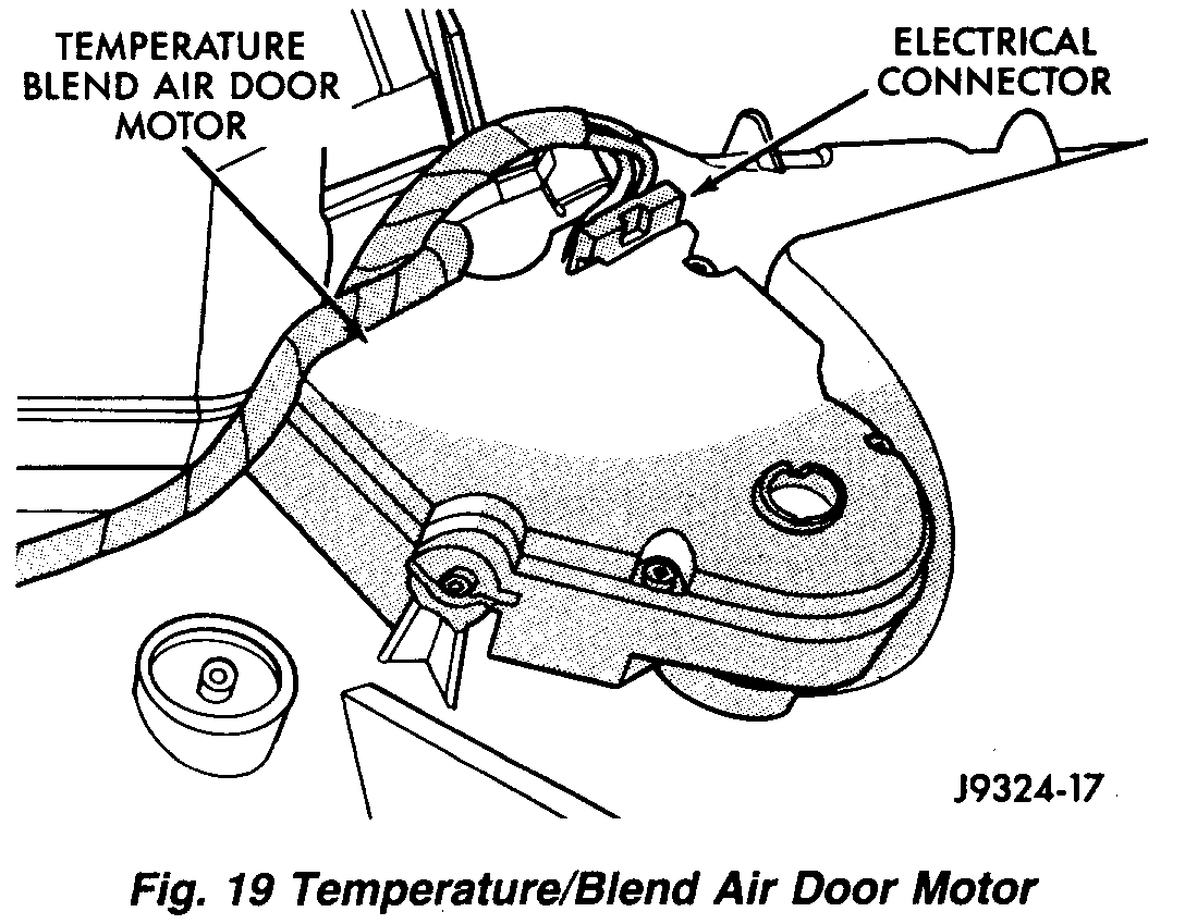

There is a component there called a blend air door actuator. It is an electric motor that opens and closes a door. The door, blend air door, is what determines if you get heat or AC entering the vehicle. Now, exactly what he did, I can't say. However, I am going to provide directions for replacing both the blend air door and the actuator. Hopefully this will help you. The attached pictures correlate with the directions and yes, it is located under the dash.

BLEND DOOR ACTUATOR REPLACEMENT
Fig.19 Temperature/Blend Air Door Motor
pic 1
REMOVAL
1. Disconnect the electrical connector.
2. Remove the retaining screws.
3. Remove the temperature/blend air door motor.
INSTALLATION
1. Position the motor over the door connection.
2. Install and tighten the retaining screws.
3. Connect the electrical connector.

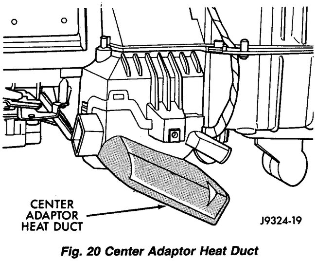

Fig.20 Center Adaptor Heat Duct
pic 2
3. Remove the retaining screws holding the two halves together. Remove the center adaptor heat duct and remove the screw.

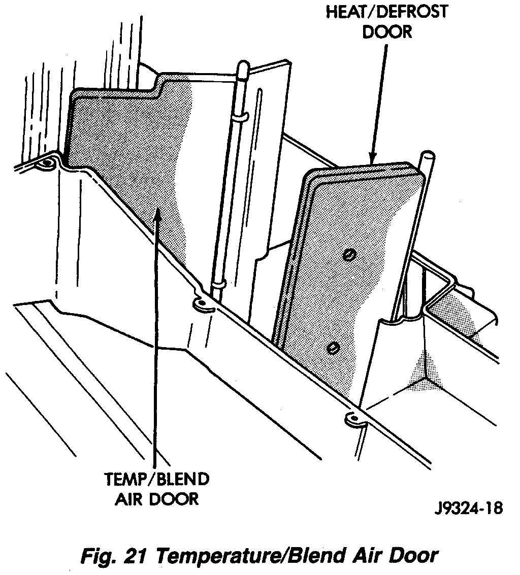

Fig.21 Temperature/Blend Air Door
pic 3
5. Remove the bottom half of the heater-A/C unit.
6. Remove the door.

If you look at the last picture, it shows the door I am referring to. My guess is somehow he turned it to the correct position for AC and used the hanger to hold it. The best thing to do would be just replace the actuator so you don't have this problem.
