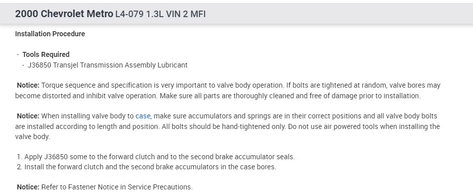

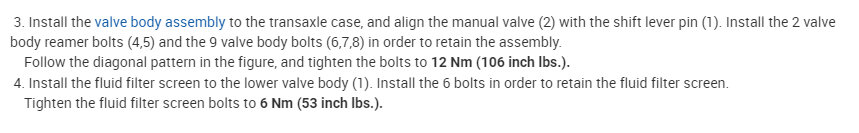

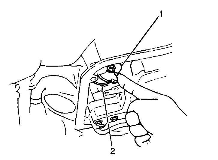

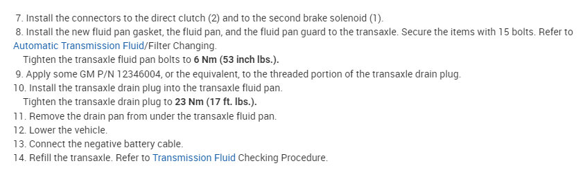

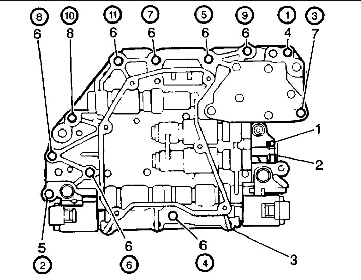

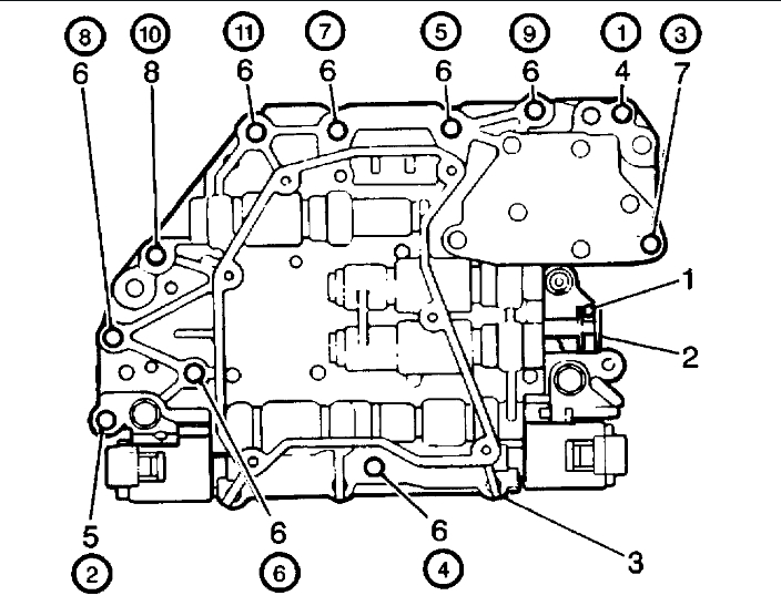

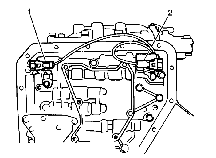

I cleaned my valve body and cannot seem to figure out how to put the accumulator springs and pistons back.
Jul 17, 2023 at 10:53 AM
  • 110,244 POSTS

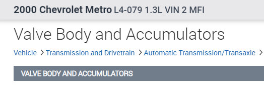

As far as reassembly, I attached the directions below for the valve body and accumulators. Take a look through them and let me know if that is what you needed.
If that isn't correct, let me know.
