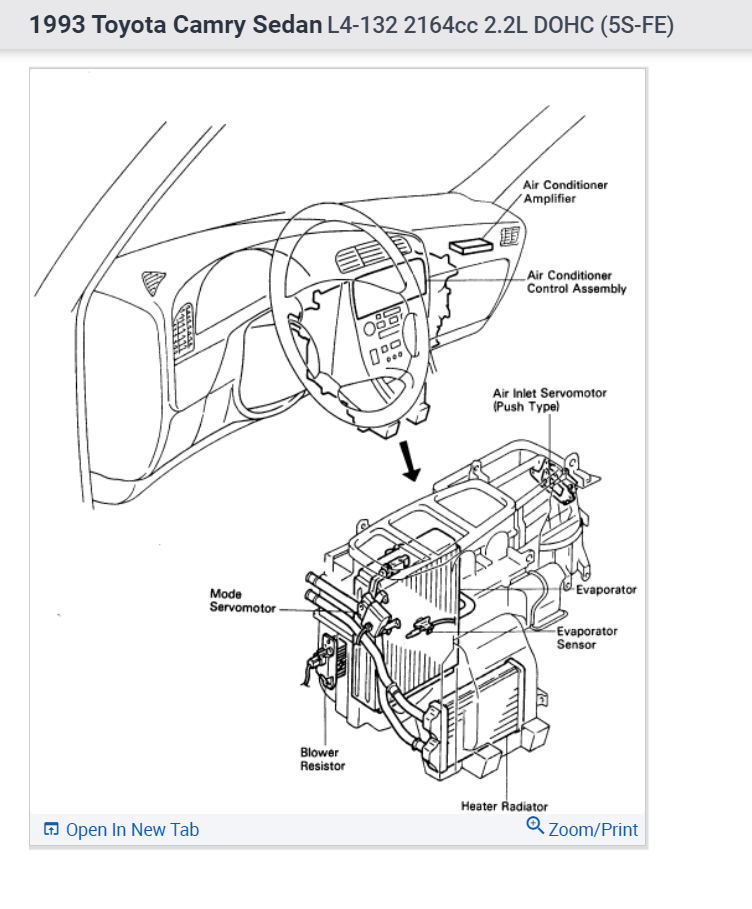

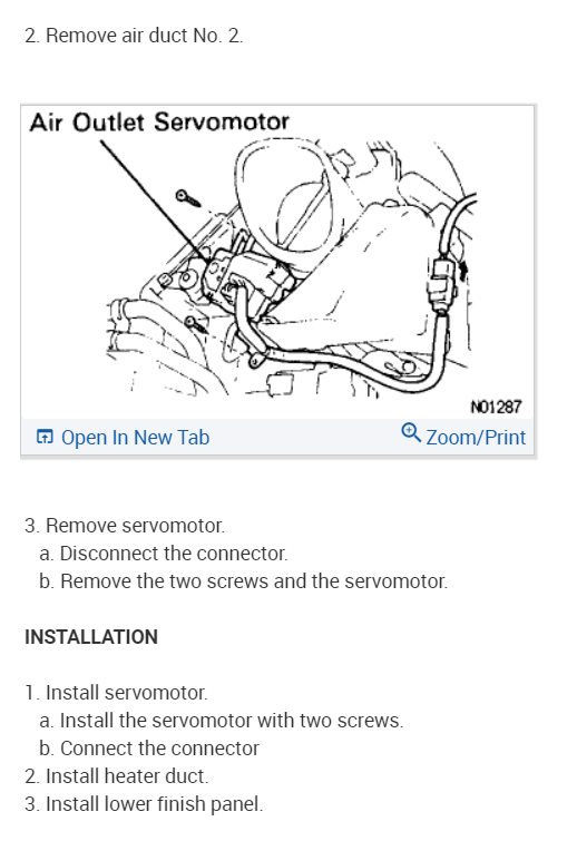

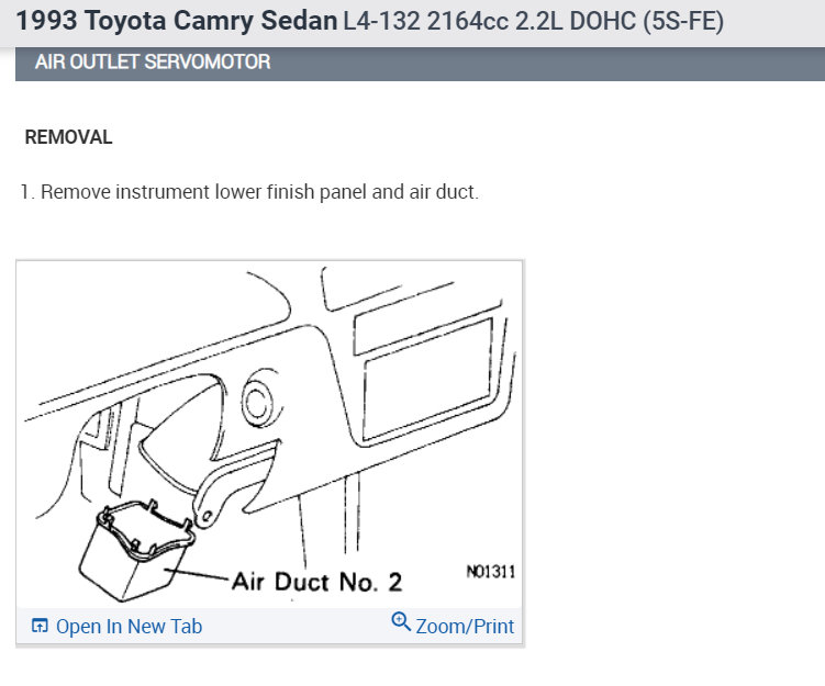

The servomotor is working fine, but I am not getting any air out of the center vents on this vehicle, and I suspect one of the linkages came loose. I am curious if I can access the linkages without taking off the whole dash.
May 8, 2022 at 2:01 AM
  • 55,746 POSTS
It doesn't look like too much linkage is attached to the servo motors, here are diagrams so show you how the system works. Check out the diagrams (below). Let us know what happens and please upload pictures or videos of the problem.
