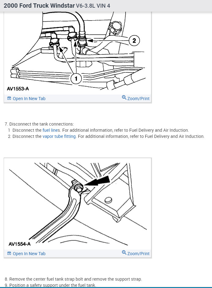

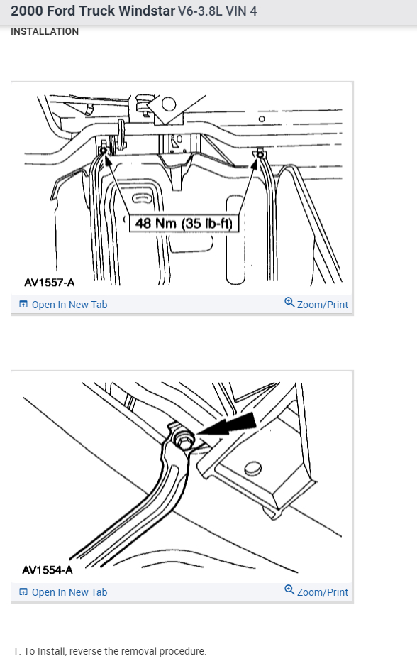

Can I access my fuel pump through the floor inside of the van like an access panel?
Mar 22, 2022 at 1:04 PM
SQM
  • 6,383 POSTS

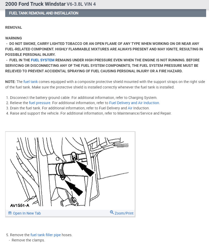

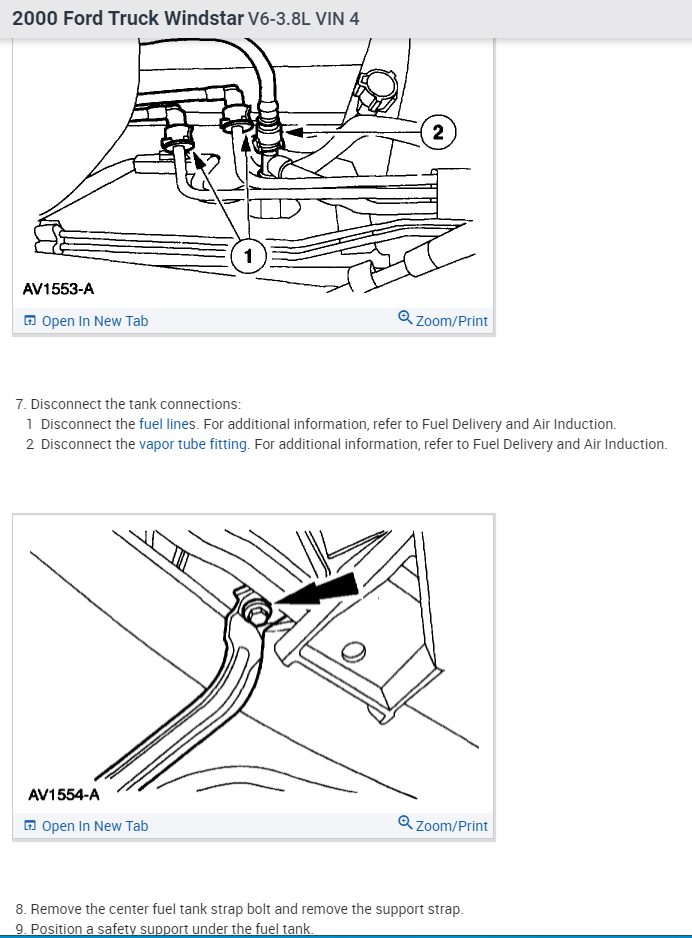

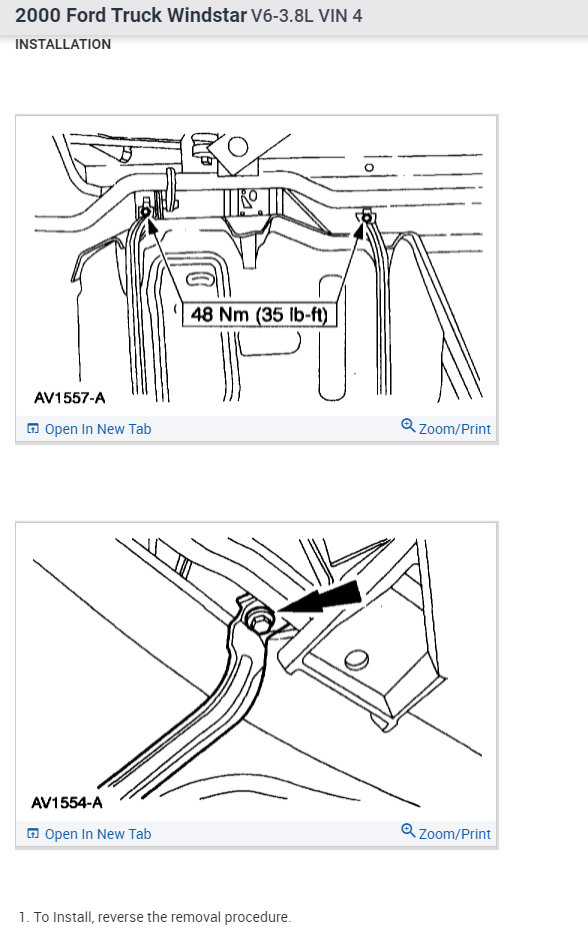

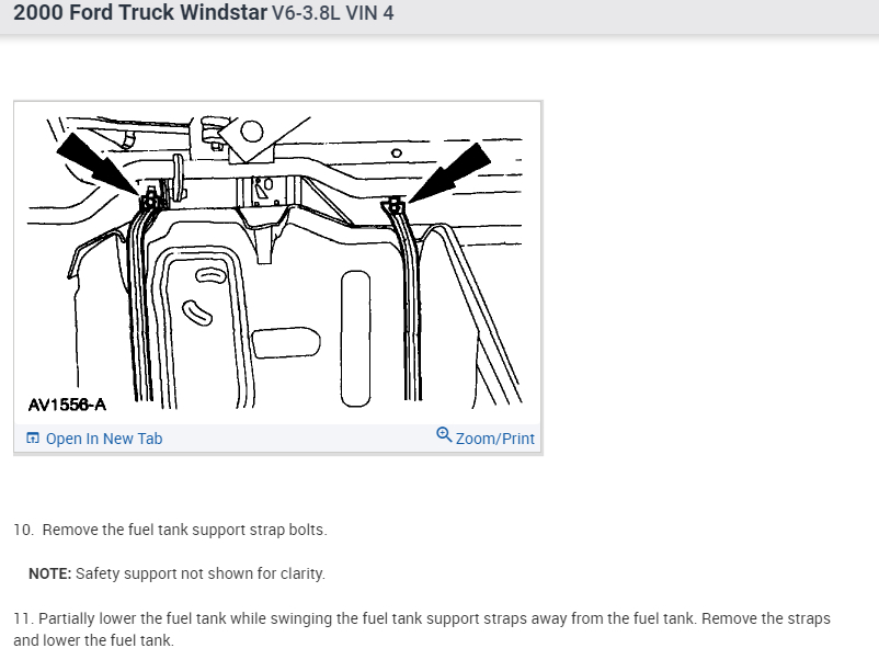

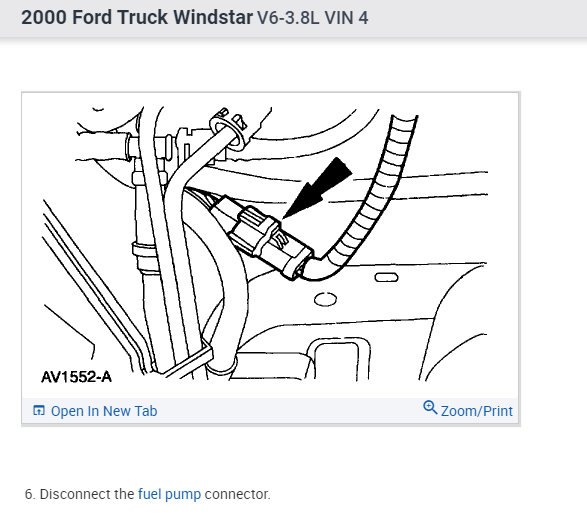

According to the manual there is no access port through the floor to get to the fuel pump.
In order to replace it you will have to drop the fuel tank, then access it from the top of the tank.
Here is a helpful guide:
https://www.2carpros.com/articles/how-to-replace-an-electric-fuel-pump
I have attached the fuel tank removal procedure below for your reference.
