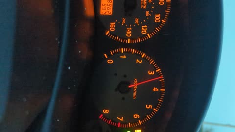

The car sat for a little over a year. no clue if it was making this noise before that.
i was doing some WOT pulls to clear out cobwebs after i had put fresh oil in and ran a full tank of gas through, the car seemed a little unresponsive. had a friend suggest that it may just need to be opened up and ran a little to clear the cobwebs, break some things loose.
That's when i noticed When i take off, if i just roll into the throttle and let the motor slowly build rpms, the whine is sort of there but barely noticeable. If i floorboard throttle, around 3-3500 rpms i start to get a whine that starts, then stays until throttle is let out.
Doesn't do it at lower rpms. doesn't do it unless hard acceleration. it doesn't sound like a transmission whine. It's almost a mixture of a whine and a squeal. doesn't just sound like intake suction either.
any ideas on where to start/how to diagnose this?

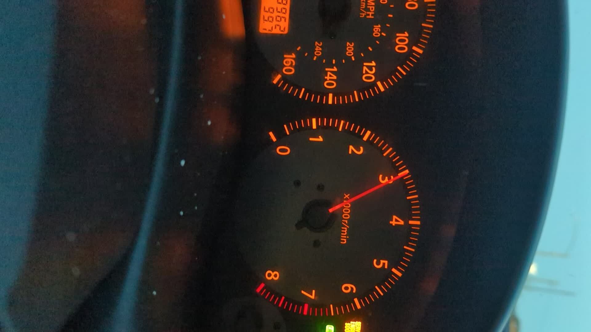

Quick video.
Apr 16, 2023 at 11:37 AM
  • 54,837 POSTS
Thanks for the video, it helps. It sounds like part of the catalytic converter has come apart and has clogged the muffler. I would raise the car up and use a mallet to bang on the exhaust to see if you can hear partials inside the exhaust system to confirm the failure. Please let us know what you find.

The squeal sounds like part of the converter?
The rattle noises were me going over train tracks. I'll get a better video today
