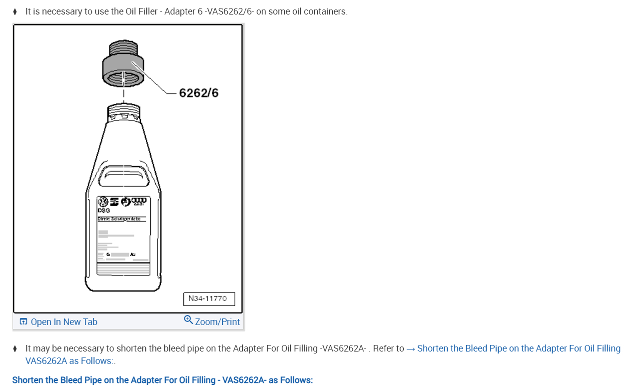

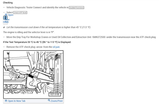

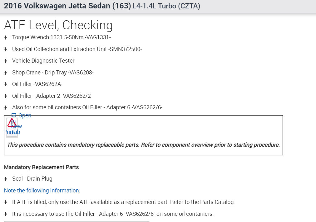

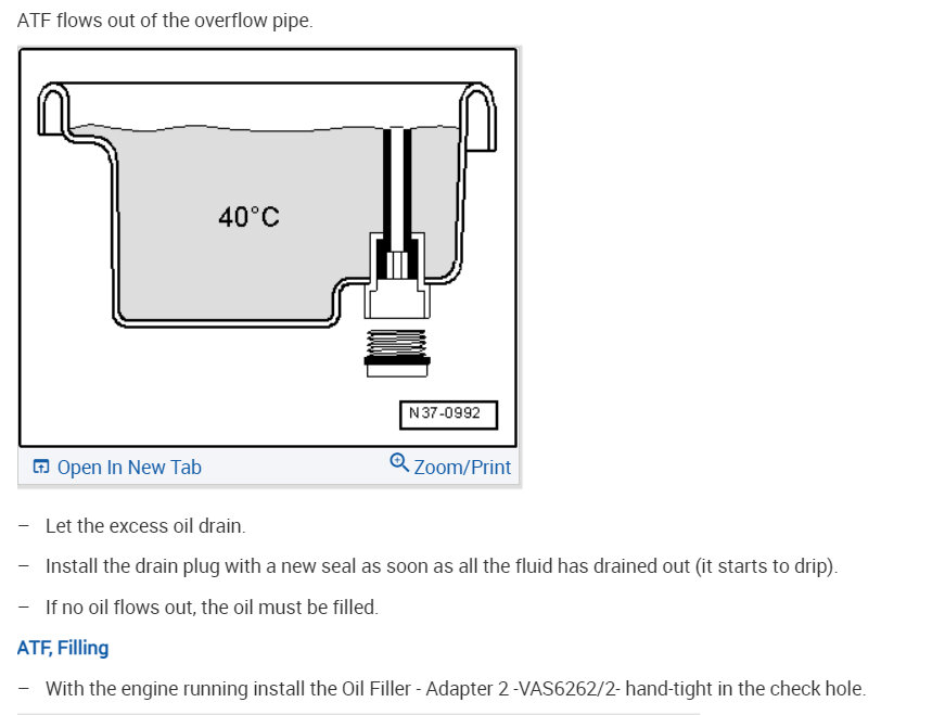

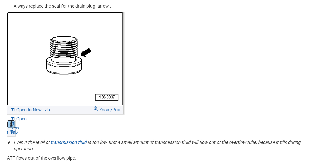

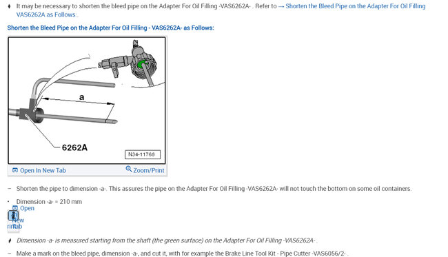

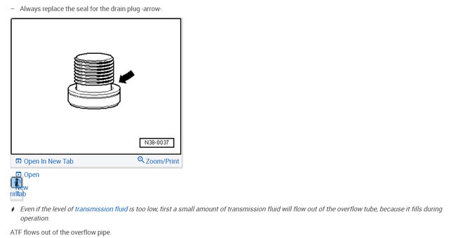

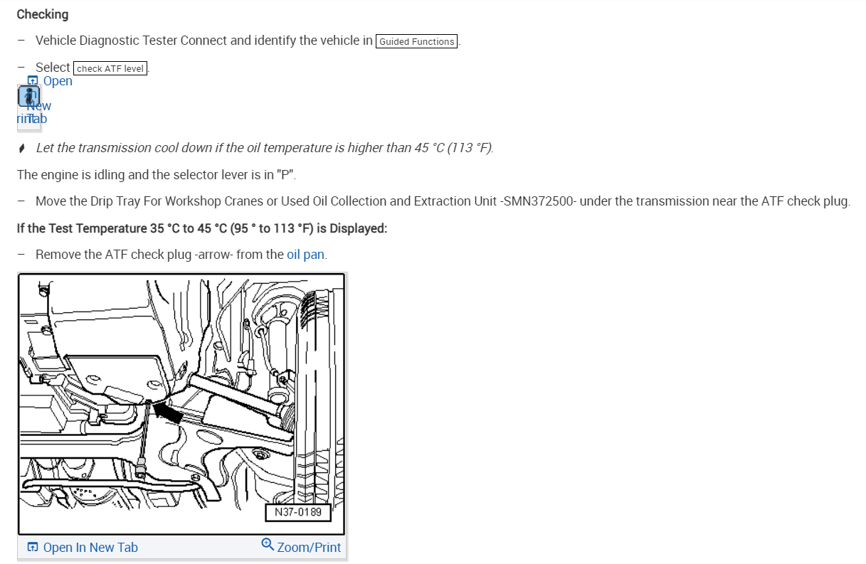

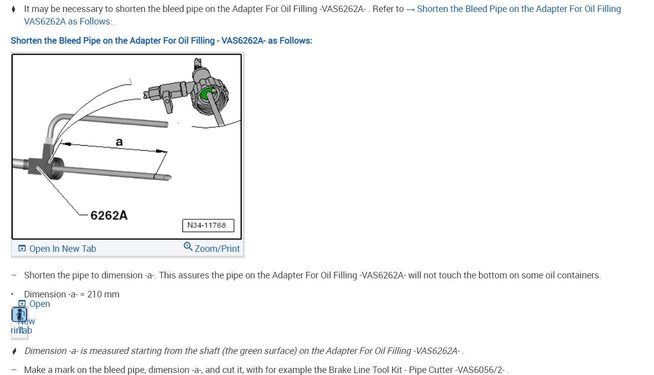

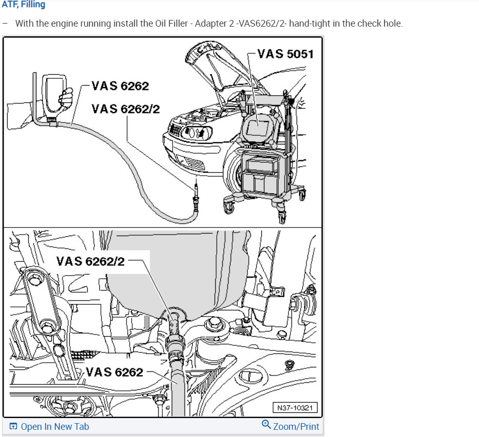

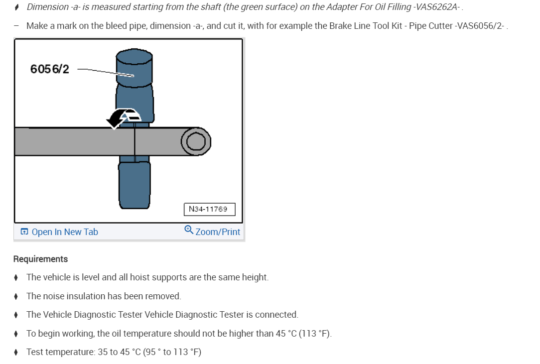

It sounds like the transmission fluid may be low. Also, we should run the codes to see if anything comes up. here are two guides to help us and I have included instructions for your car in the images below.
and
https://www.2carpros.com/articles/how-to-check-and-add-transmission-fluid
