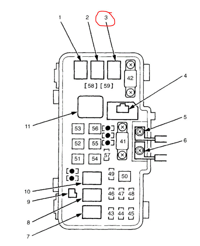

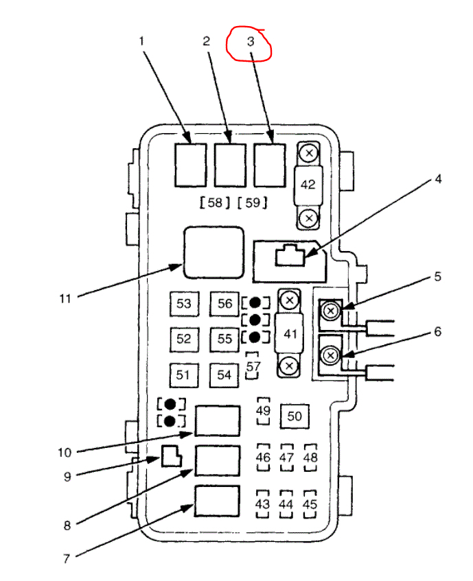

There is also a compressor clutch relay that could be failing. This relay is located in the underhood fuse box. I attached a pic below indicating which relay to check. If there is another relay with the same part number, switch them. If there isn't, here is a link that explains how to test a relay:
The next time you use the A/C, make sure to keep it off the max cool setting and make sure it is getting fresh air and not recirculated air. See if that makes a difference. In the recirculate position, the evaporator has more of a chance to freeze up and the sensor to shut things down until it warms up.
See pic below.

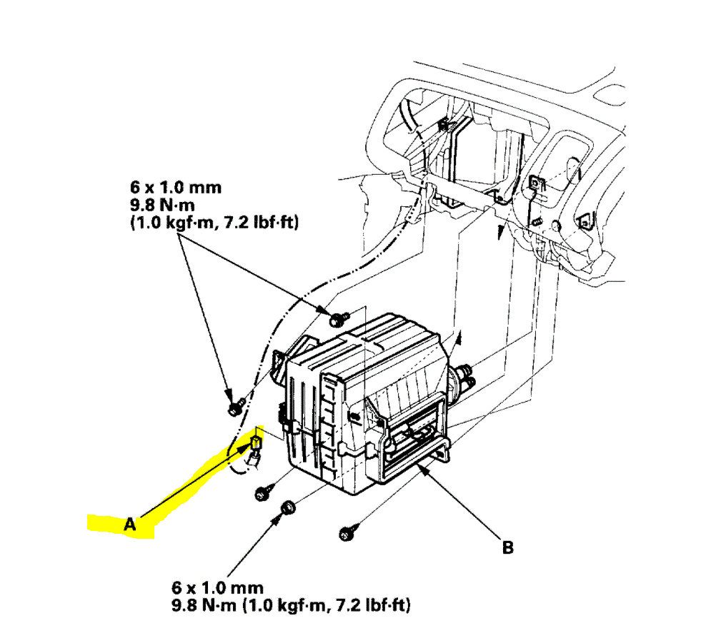

First, you are very welcome. I just hope I can help.
As far as the evaporator, it is located behind the glove box in the HVAC box. The evaporator temperature sensor is in the same location.
If you look at the attached pic, letter A is the temp sensor and letter B is the evaporator.
Let me know if not using recirculate made any difference.
See pic below.
